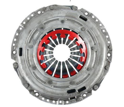

It's the red bit on this picture that breaks and wears the housing - it is known about in the aftermarket by quite a few gearbox repairers

Happened on mine too.  2012 140CR 4x4.  About 37k miles, less than a year out of warranty.  The same bit broke in mine, punching a hole in the gearbox, and the clutch slave cylinder.  The first I knew about it, was when I got in the car one morning, and couldn't get the car into gear.  That problem went away mysteriously, and then shortly after, I got the smell of gearbox oil leaking down onto the hot exhaust.
Skoda wouldn't do anything, because I had taken it to a local garage to see what was wrong (Two Skoda dealers told me the bill would likely to be several thousand £, depending on the damage, and it probably wouldn't be covered under warranty.  So i went to my local garage, who quoted me a lot less).  They wouldn't even entertain the fact that spring part had clearly failed due to a crack in the plate that had fatigued over time, even after getting some pictures under a microscope of the failed part.
I had to get a new clutch, (did the DMF at the same time) new clutch slave cylinder, and had the gearbox casing repaired (luckily the hole was about 5mm across).  Not an insignificant repair bill, and something that really shouldn't be happening on a car of that age.

The thing I never did understand, is how I didn't either hear, or feel some kind of vibration or noise, as the part failed.  Looking at the clutch that came out, and the inside of the clutch housing, there was a lot of little pock marks, where a lump of metal had been clearly rattling around for more than a few seconds....
