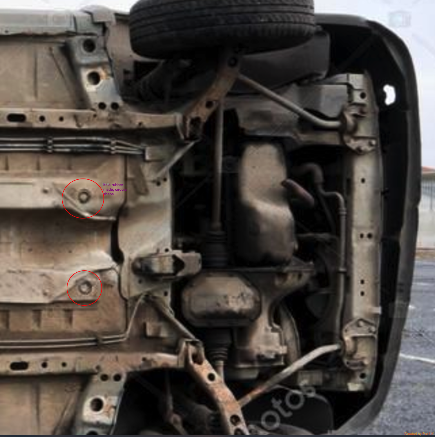

I am looking for something which I dont know how to explain :P. I think picture says thousands word so I am attaching a picture (by the way its not my car :P).
Actually I am looking for a rubber made circular thing which stops water getting inside the car. I dont know its purpose but after lifting the car, it seems my car missing this "thing". The car rear carpet keep getting soaked every time I drive in the rain.
I hope wise people can help me in explaining the purpose and how to get it ?

Thanks for that... can you guide... IF i can reuse bunk from one of the car area which is not so critical ?
There are two behind the rear bumper cover for towbar/parking sensor wiring, you could remove one of them from inside the boot and use that, might be an idea to cover that hole with some tape, but I can't imagine a new bung from a dealer would be very expensive
