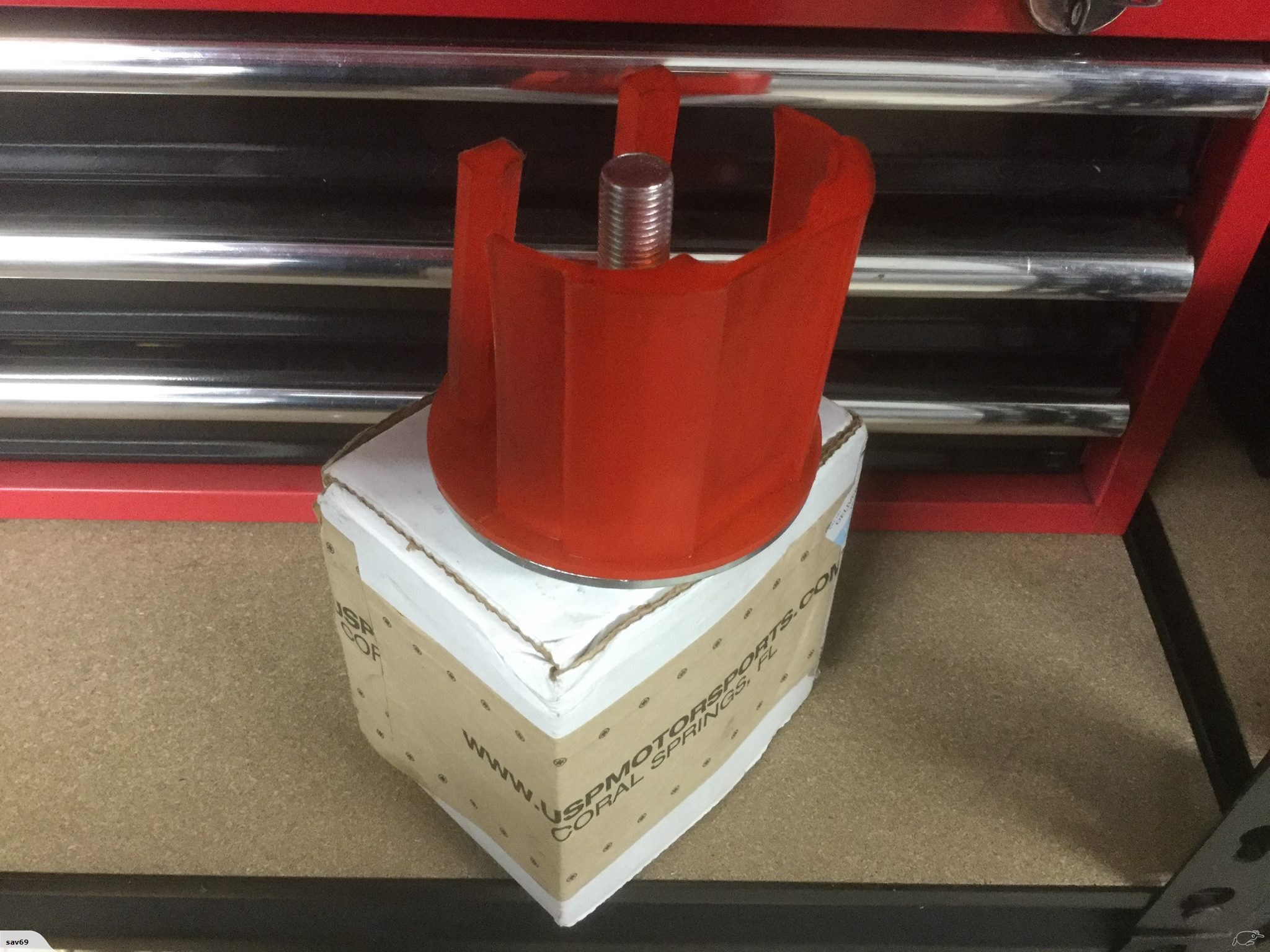

Hi. Had the same problem. Installed a SPULEN Dog Bone Engine Mount Insert Kit and it made a massive difference to launch, reduced wheel spin and the banging. Incredible that such a minor and inexpensive mod can have such an impact. Unfortunately, the vibration at idle even after a settling in period drove me insane so removed it.... It's a family car afterall. For sale (in NZ) if anyone wants to give it a bash. 5 minute install.
This is the one you want...
http://store.blackforestindustries.com/bfimk7toarmi.html
BFI made a compromise one due to the exact feedback you've posted. You've got the equivalent of their stage2 mount insert.
Thanks for the info. Looks like a good compromise. Will sell mine and give that one a whirl I think. Cheers
