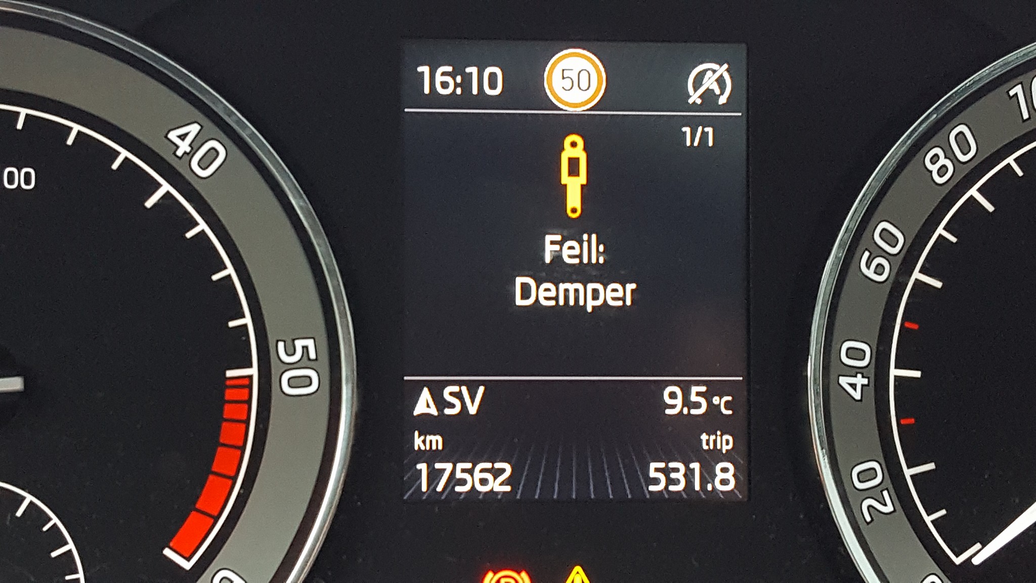

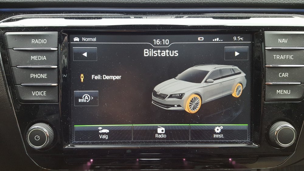

Yesterday, when turning left in 40 km/h, the car lost grip and made som small jumps straight forward approximately 0.5-1 meter. Almost bumped in to the sidewalk... At the same time the warning "There is a DCC fault" illuminated (in Norwegian Feil: Demper [Error: Damper]). The warning illuminates every time I start the engine since Friday and I can really feel that there is something wrong - Scary! Going straight to the workshop Monday. Anyone got an idea about what the problem can be - one of the dampers, the DCC system?

Error found. Corrosion on left rear damper connector and cable breakage. Cables and rear dampers to be changed in a couple of days. The last 3-4  month there has been a rumbling noice from the rear of my car and the worshop told me that it is coused by the faulty dampers. I realy look forward to get this fixed.
