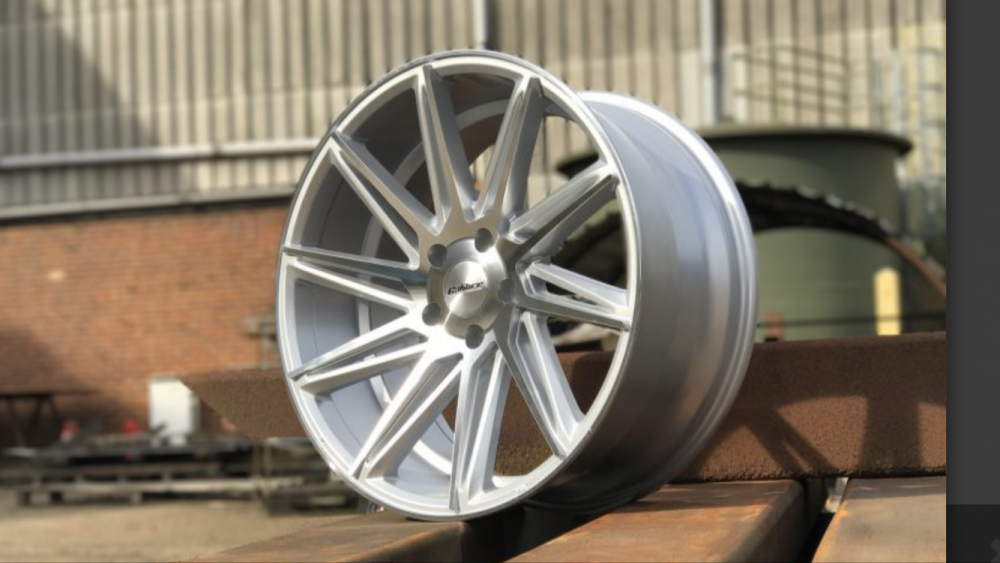

Well I finally sat down and measured out my Superb for wheel fitment. First bought some used Audi type 18x8 et42 wheels w 245/40/18 tires a couple months ago. The tires are super loud as they are nearly dead. They fit w no issues tho. So I ended up measuring off them. The Calibre wheels I really wanted only came in 19x8.5 with an et35 and they were simply too wide. So I got the 19x8 Calibre CC-A polished face/ silver backside wheels w an et45. Then I'll use a 15mm H&R spacer on the rear to get everything pretty flush w the side of the car. Tires will be 245/35/19 Uniroyal Tainsport 3 (had the same on my last Nissan and was very happy w them).
Im hoping the style of wheel will fit the light grey Superb I have. If not, ill powder coat them grey metallic or something.
