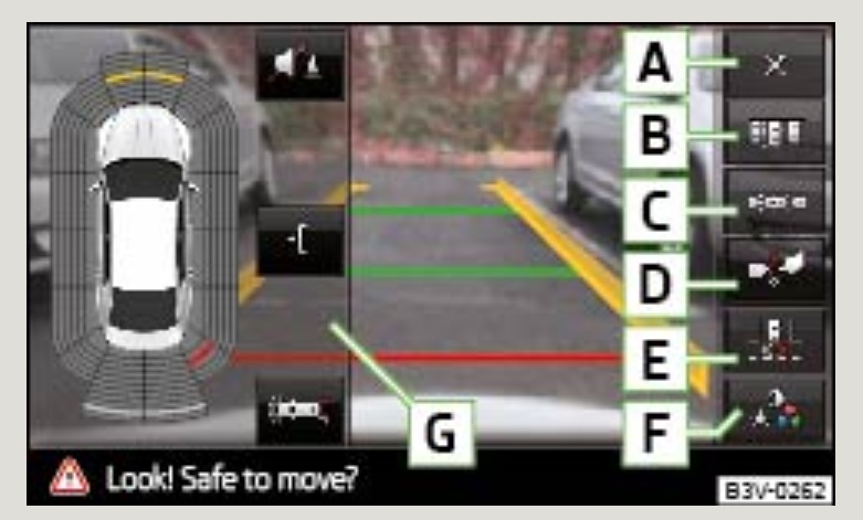

I've recently retrofitted highline rear view camera and it works like a charm, except some additional view functions, which are marked B-E on attached image from Skoda manual. I don't see them at all, just those marked as A,F and G. Are those somehow enabled in VCDS or available only with parking assistant?
On another forum I've read, that those functions are only visible, when parking assistant is fitted, but one of members stated, that he doesn't have PA, but he has those additional view modes (although he has fitted tow bar). Does anyone have those additional view modes to select on screen, but doesn't have parking assistant and/or tow bar? I'm trying to deduce if those view modes don't depends on any other car system.

Forum member Enriquez managed to point out adaptation which is responsible for this additional view options:
ENG122229-ENG117712-Car_Function_List_BAP_Gen2-VPS_0x0B,not activated - > activated
Unfortunately camera which I've installed ( 5TA827566E, part no. 5Q0 980 568 A ) does not support additional view modes. I have menu on the screen, but switching between modes doesn't change image on screen.
