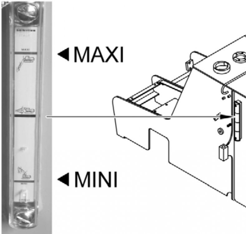

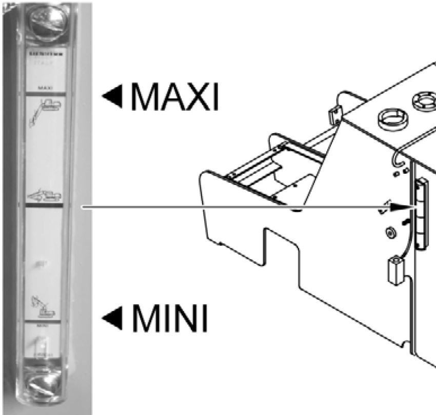

Bit' out of topic- but that's from my daily job hehe > three possibilities how to place boom/stick/bucket when checking hydr.oil level for excavator ;-)
