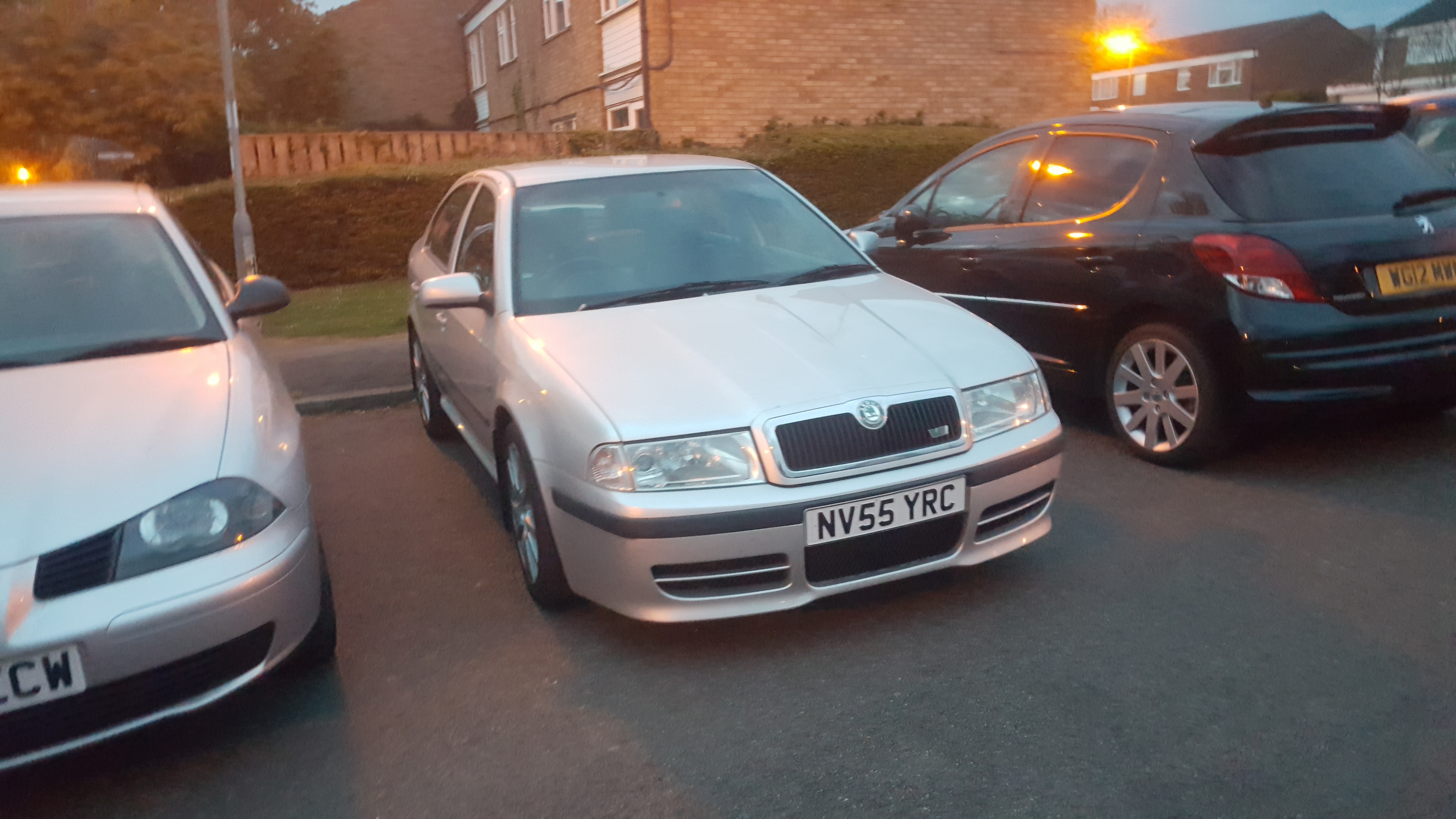

Hi guys thanks for the help.
Ive bought a Silver 55 plate 1.8t with 144k on the clock for £1,100. Which I think is a bargin.
Has had water pump and timing belt done 38k ago. FSH been serviced every 10k without fail.
He has every MOT recipt and has just had fresh MOT with no advisories.
Picking it up today.
Welcome to the Vrs club
Sounds like you have found a good one at a very good price.

Welcome to #teamsilver - looks loverly :)
