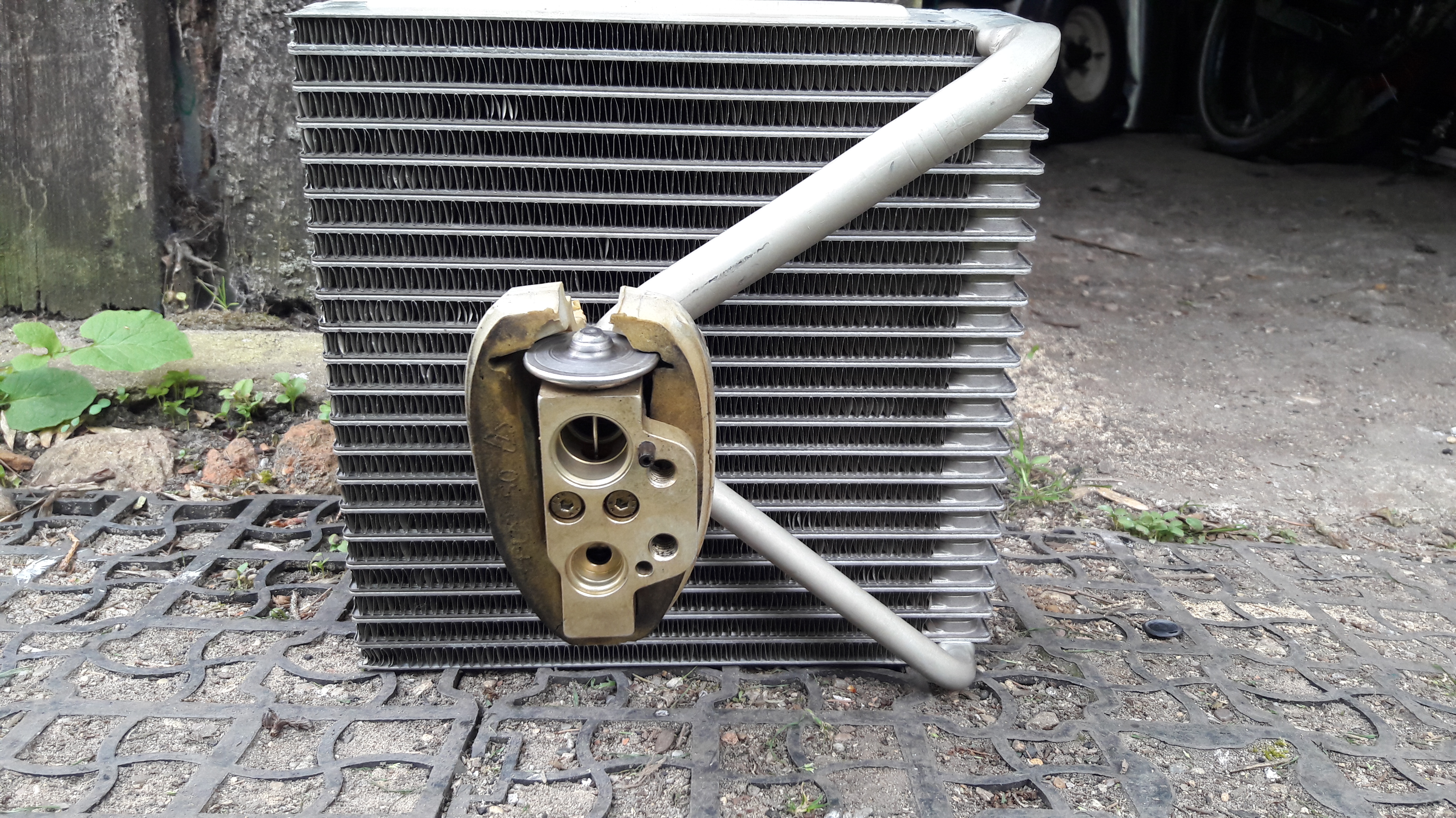

I'll just have a look at some photos I might have of a spare evaporator, just in case it happens to be that number. Too late here today for me to go out to the shed and try to find the real item.

Can't find a photo with part number visible.
I'll grab the real thing tomorrow and see what number it is.  I vaguely remember testing it by blowing into it and finding it held pressure.

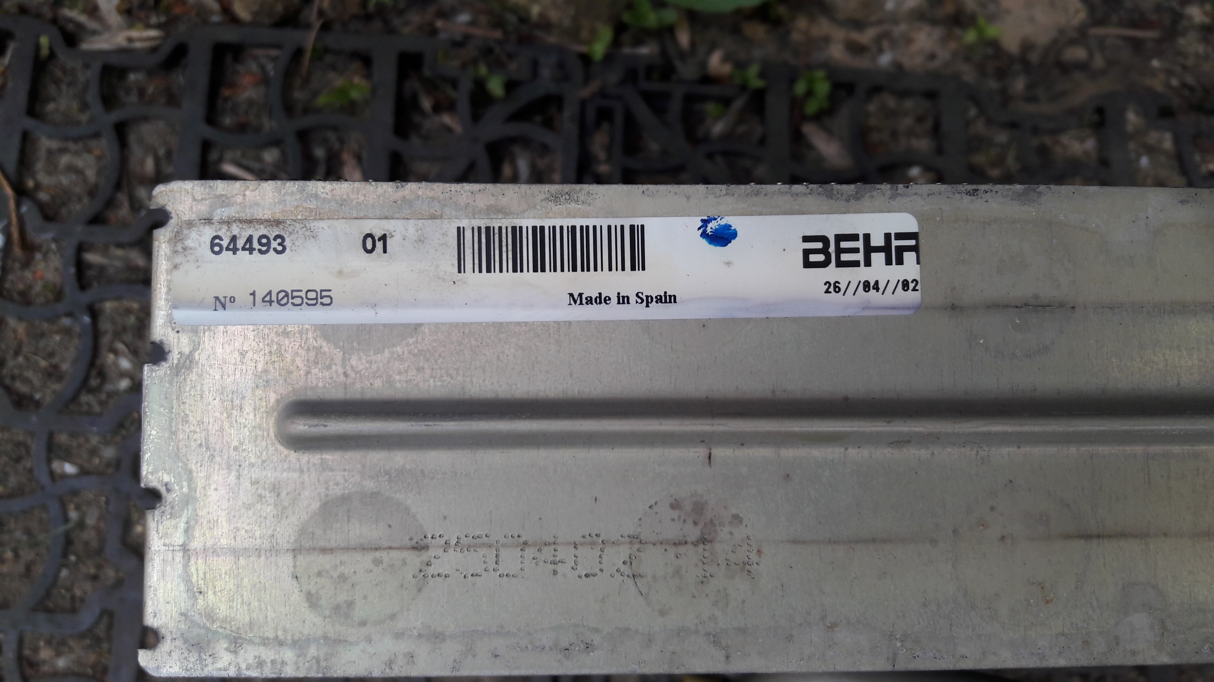

To my surprise, I can't find a VW group part number anywhere on this evaporator, only manufacturer info.  I guess that might cross-reference to a VW group part number?
(Click to enlarge)
(Click to enlarge)
This is the one for Skoda Fabia 2007?
  • Sponsor
This was from a 2003 Polo. I think the part number ending B was one of two listed in the parts catalogue for 2003 Polo.
You are using that on your Fabia? It looks like the 6Q0820103B one. Same position for the valve. I think it is the same one. I don't know if the width affects.
