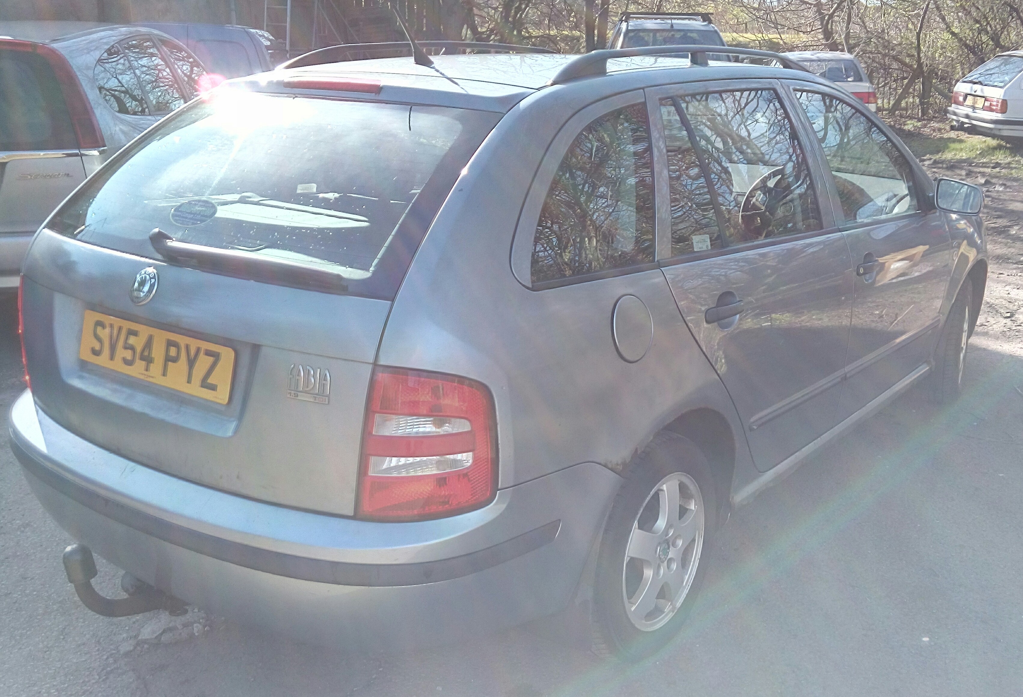

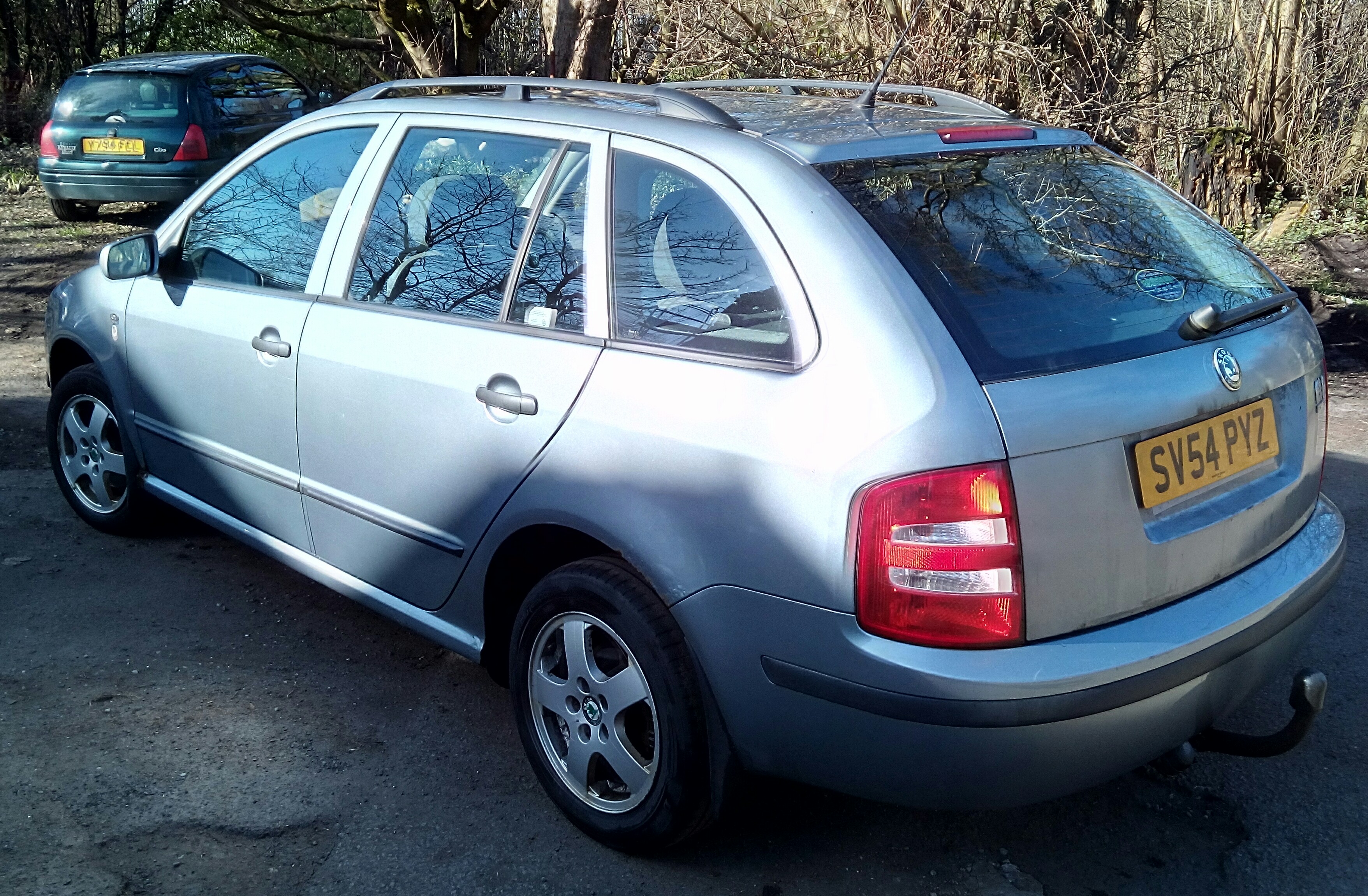

As bought, I got a 2004 Fabia 1.9 100bhp TDi with 152k miles on it, and MOT until Sept 17.
Its Elegance trim level seated me upon heated seats, beside electric front windows and listening to an actual CD player! Glamorous in extremis compared to my other steeds.

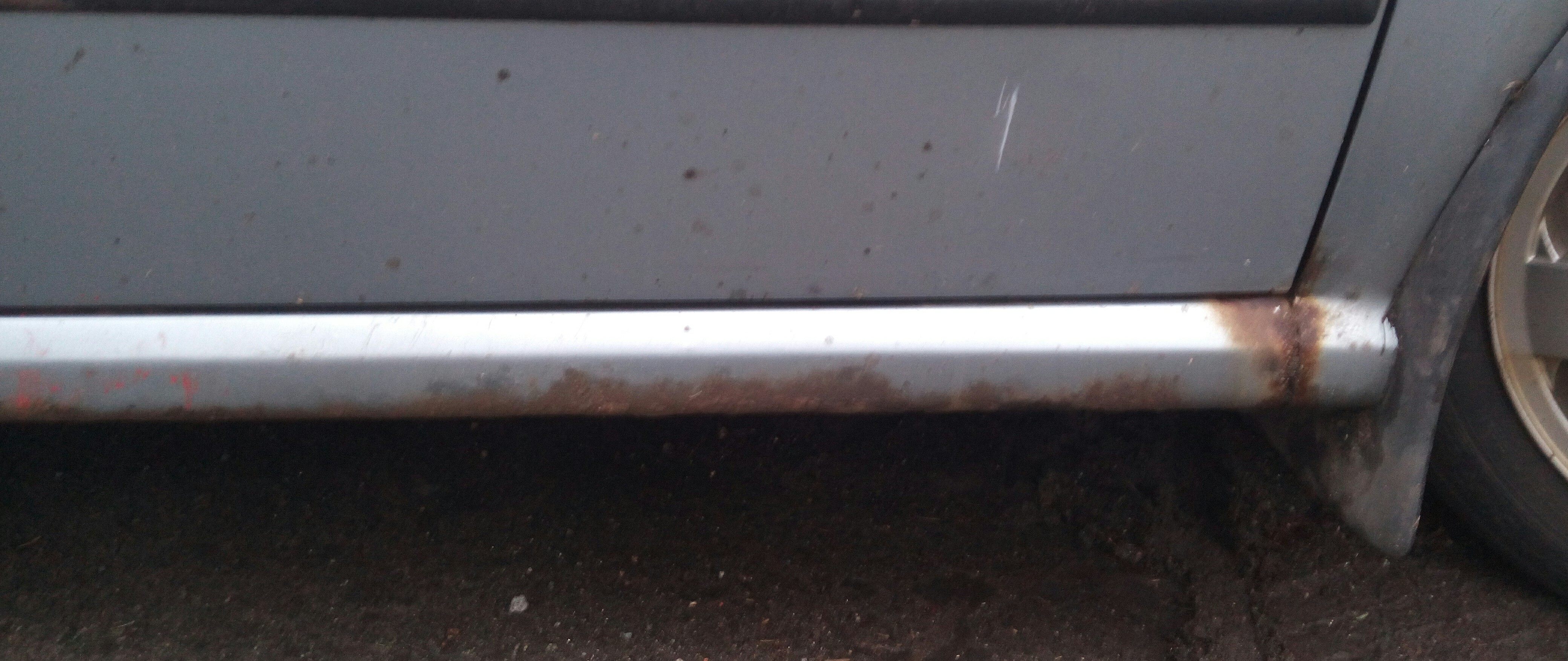

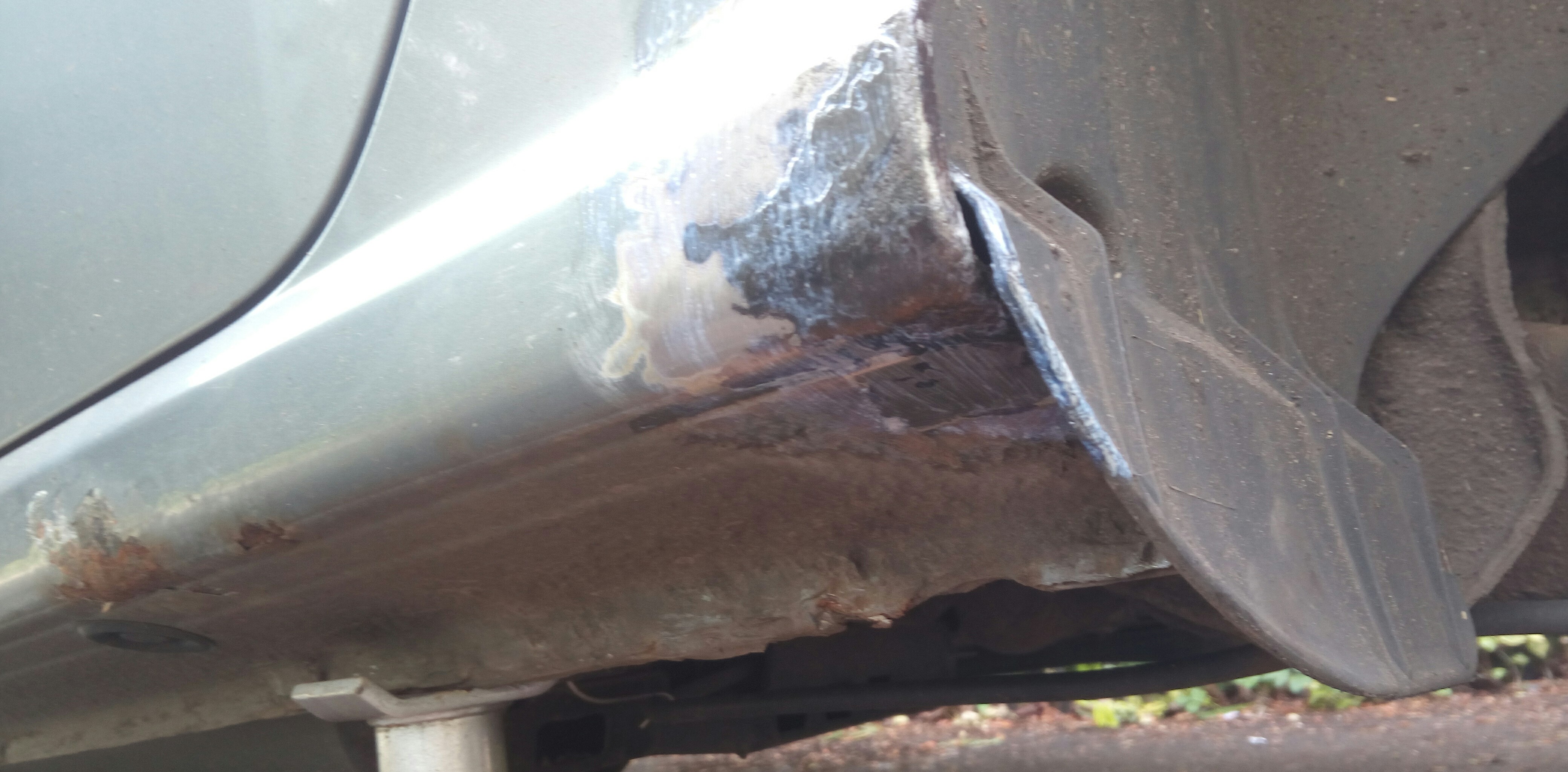

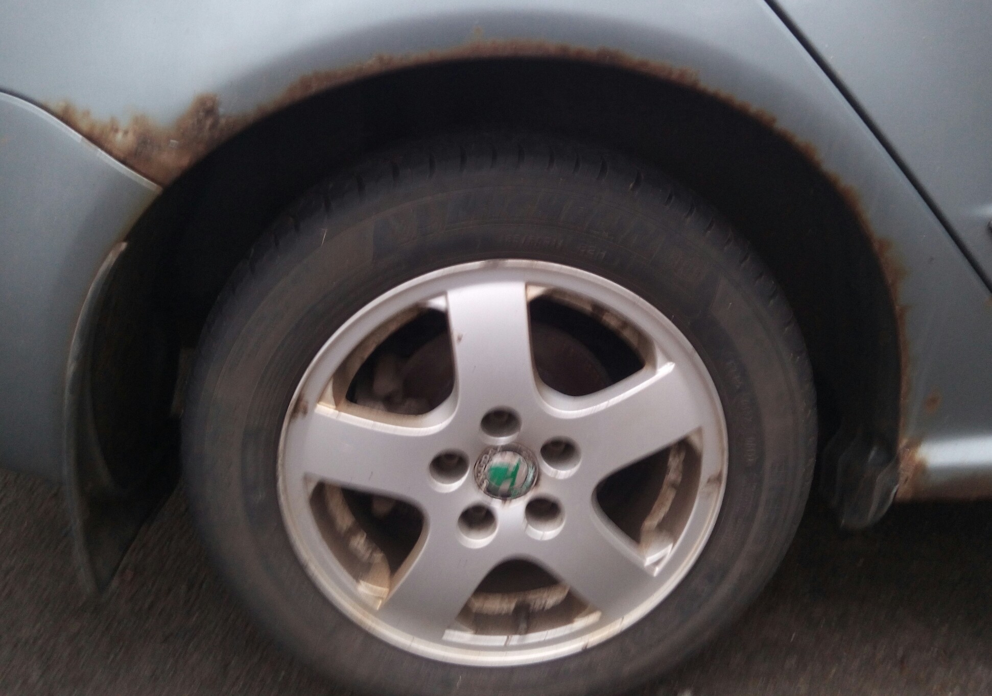

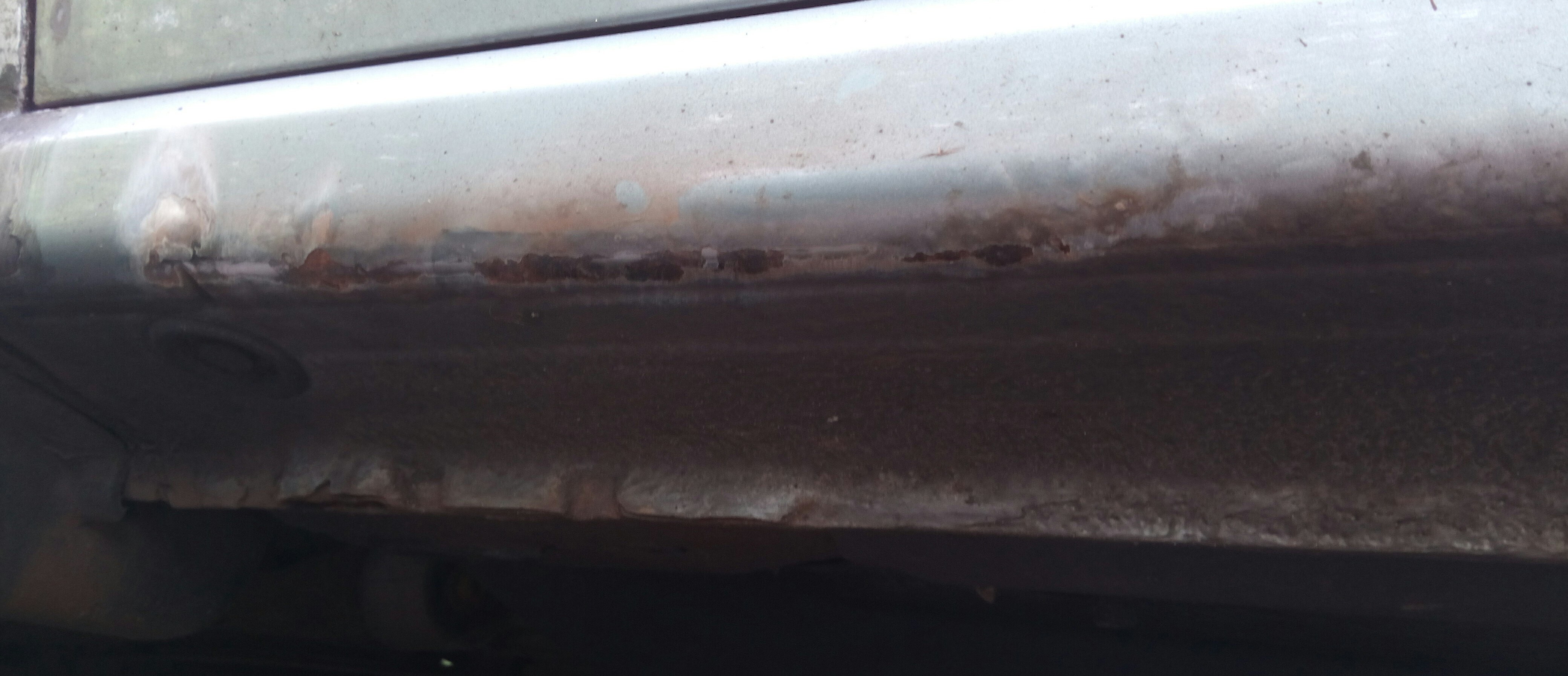

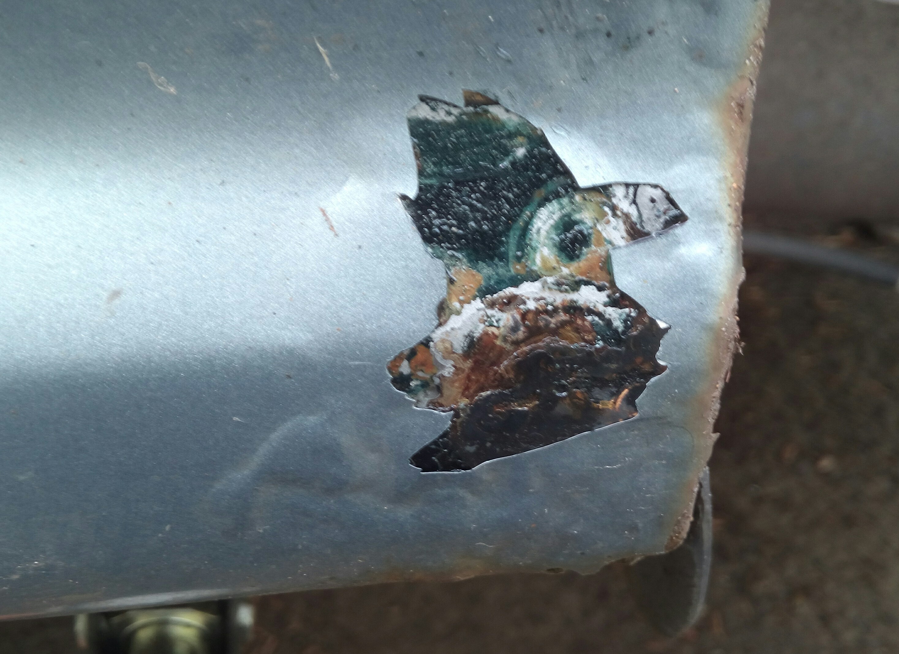

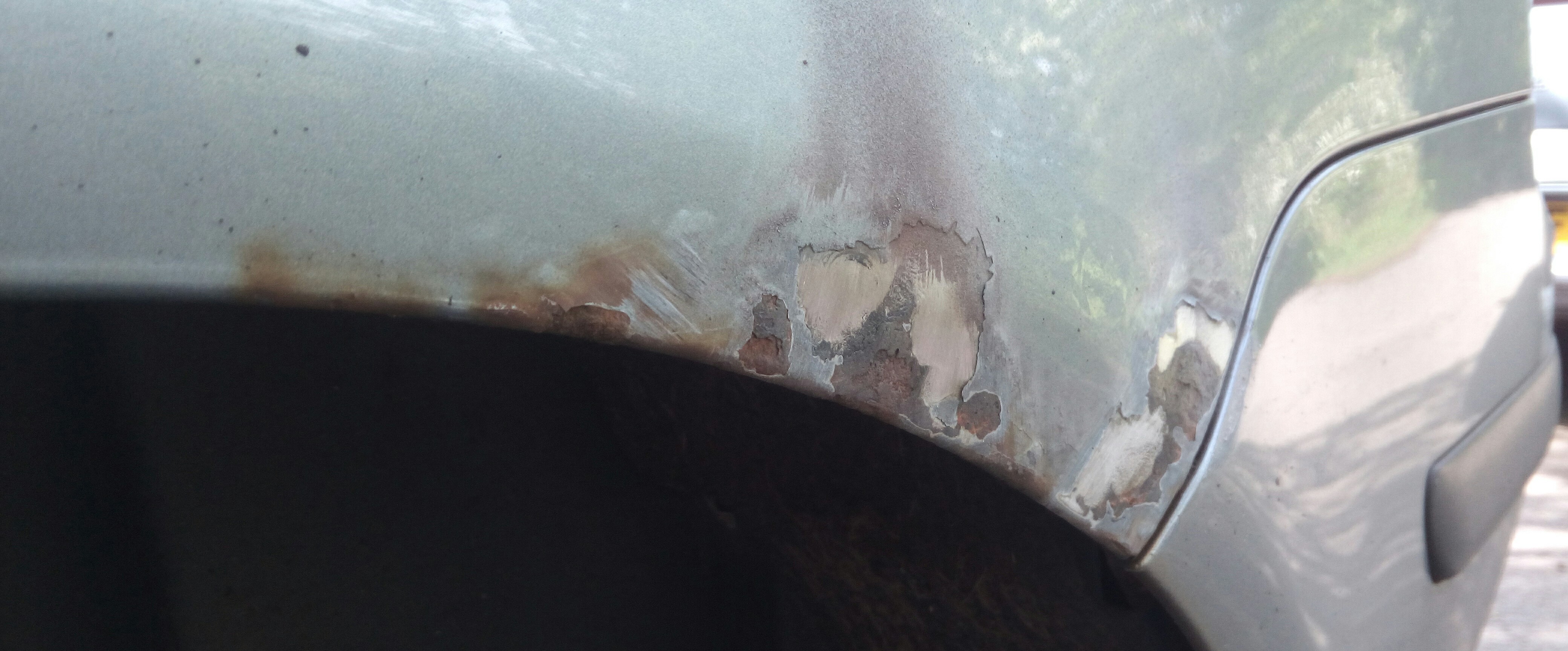

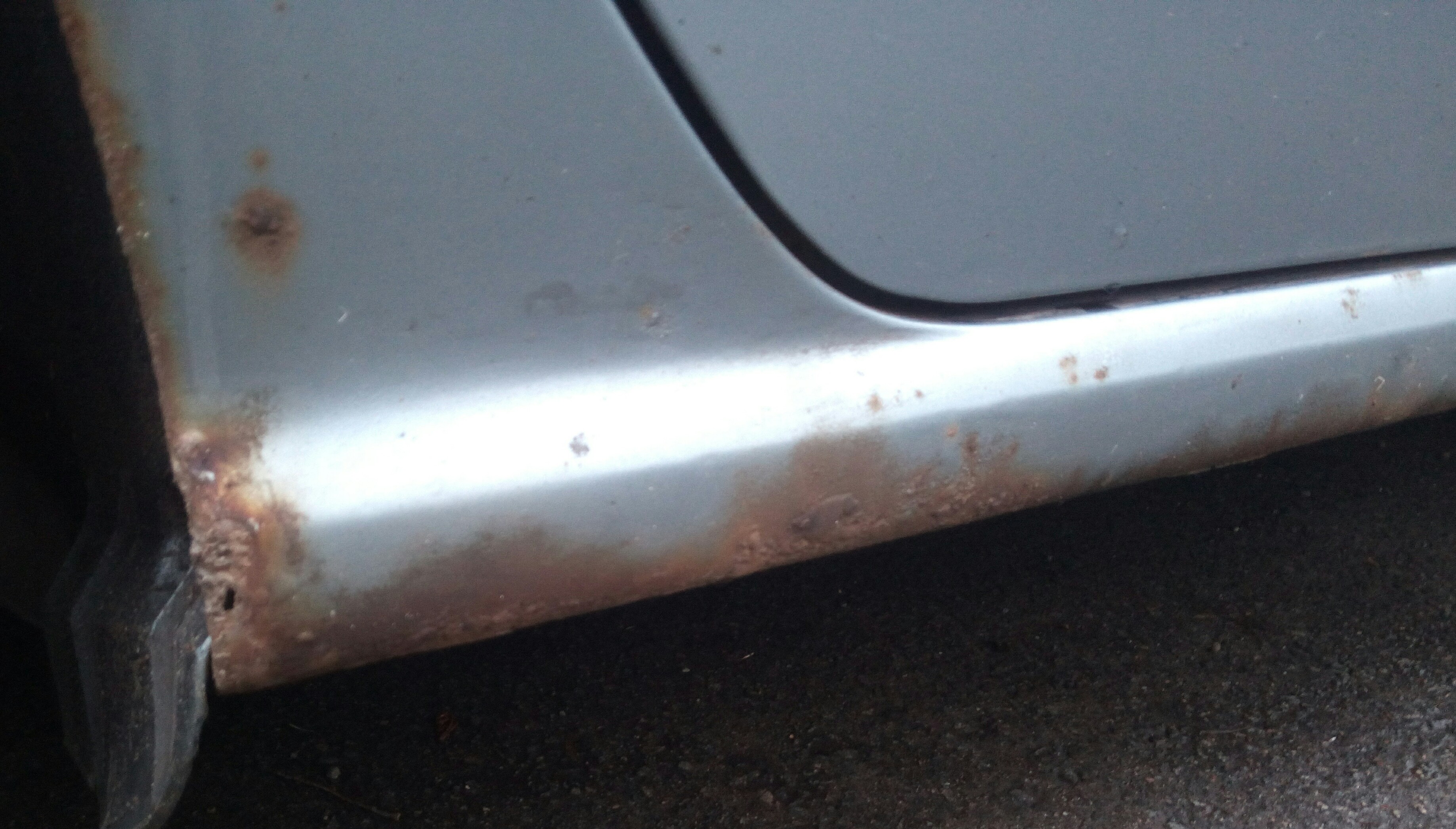

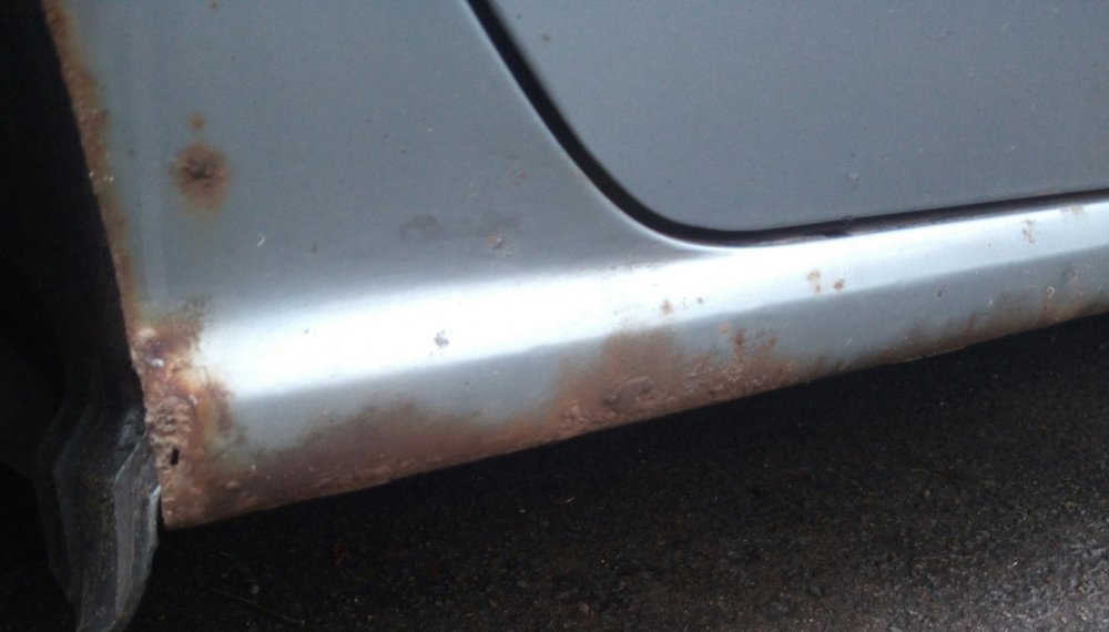

The car is somewhat lacking in the looks department, as most panels exhibit some dents, rust or paint damage.
Worst areas are the sills and wheel arches as you can see from the below..
I really need to get it up in the air and see what condition the underside is in- this will dictate what happens further down the line come MOT time.

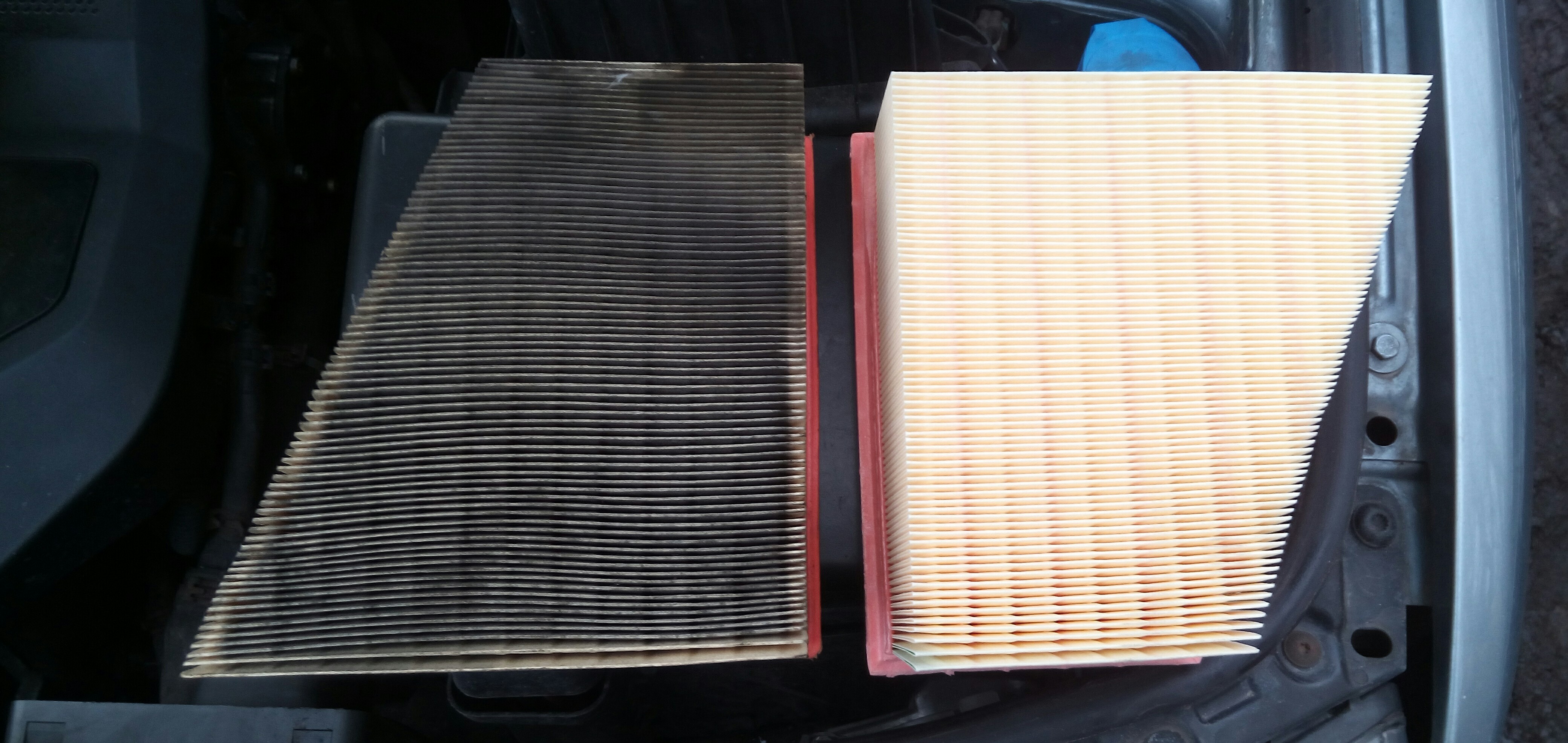

So far the only real work needed has been an oil & filter change, fuel filter and Air filter.

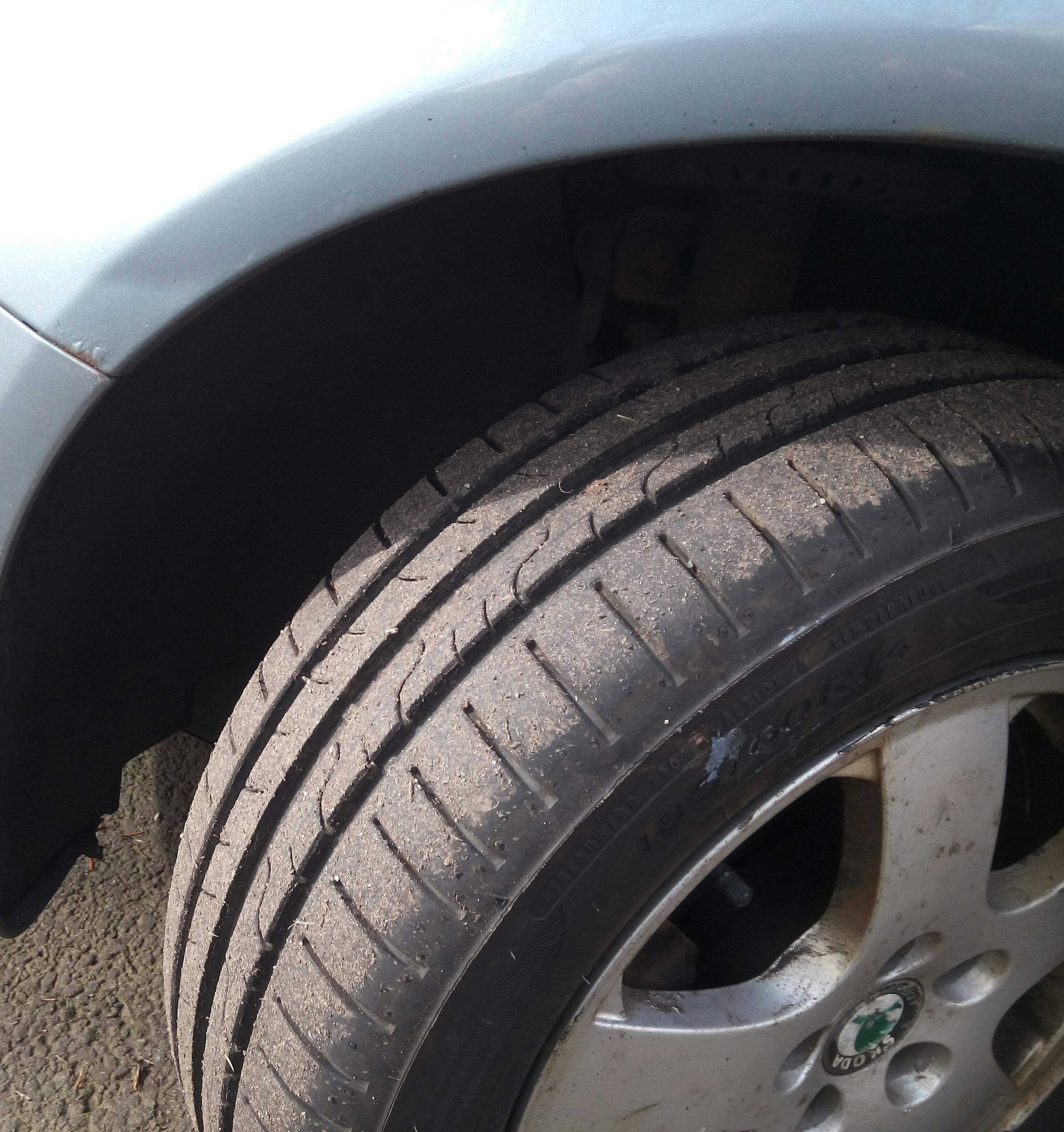

The only other thing done has been the fitting of 2 Dunlop Sport Bluresponse to the front end
These tyres cost £90.09 fitted and have greatly improved front end grip in both wet and dry conditions. I see the traction control light very rarely now- well worth the spend.

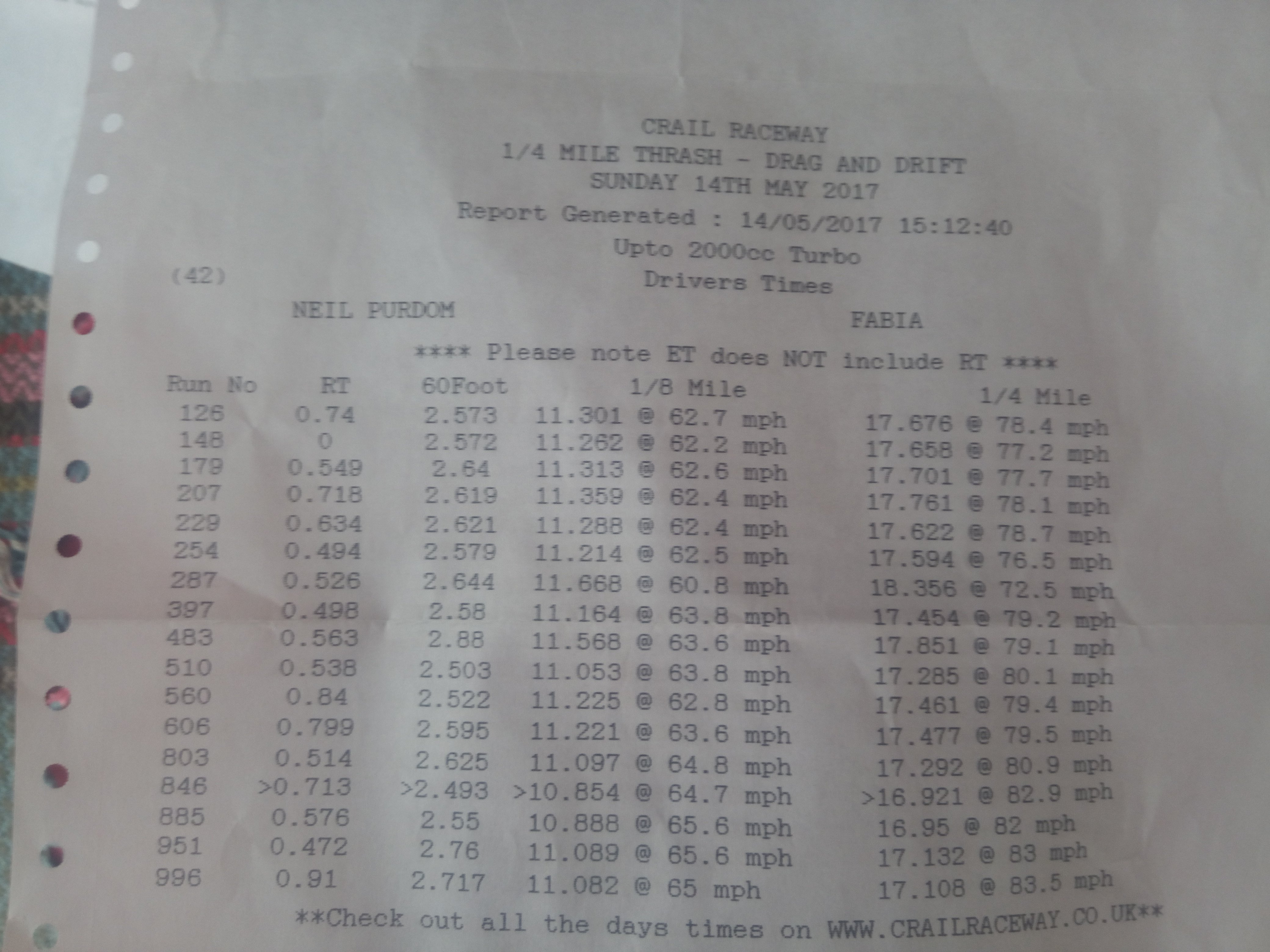

Took it Drag Racing today..
How did it do?
Well, stock it ran 17.59 seconds (vs 18.001 that the Octavia managed) so a good 4 tenths quicker in stock trim.
The decent Dunlop's and traction control are a boon for getting off the line.
We put a map on - only a tenth quicker.. WTF??
Turns out there are 5! Smoke limiter maps, and my software was only showing me one- the one for -20 starts..
This meant that at operating temp, the car was reading a stock smoke limiter map. A swift copy/paste saw significant progress:)
https://youtu.be/dArXac_CmK8
Upshot of this was a 16.921- much better but still not right.

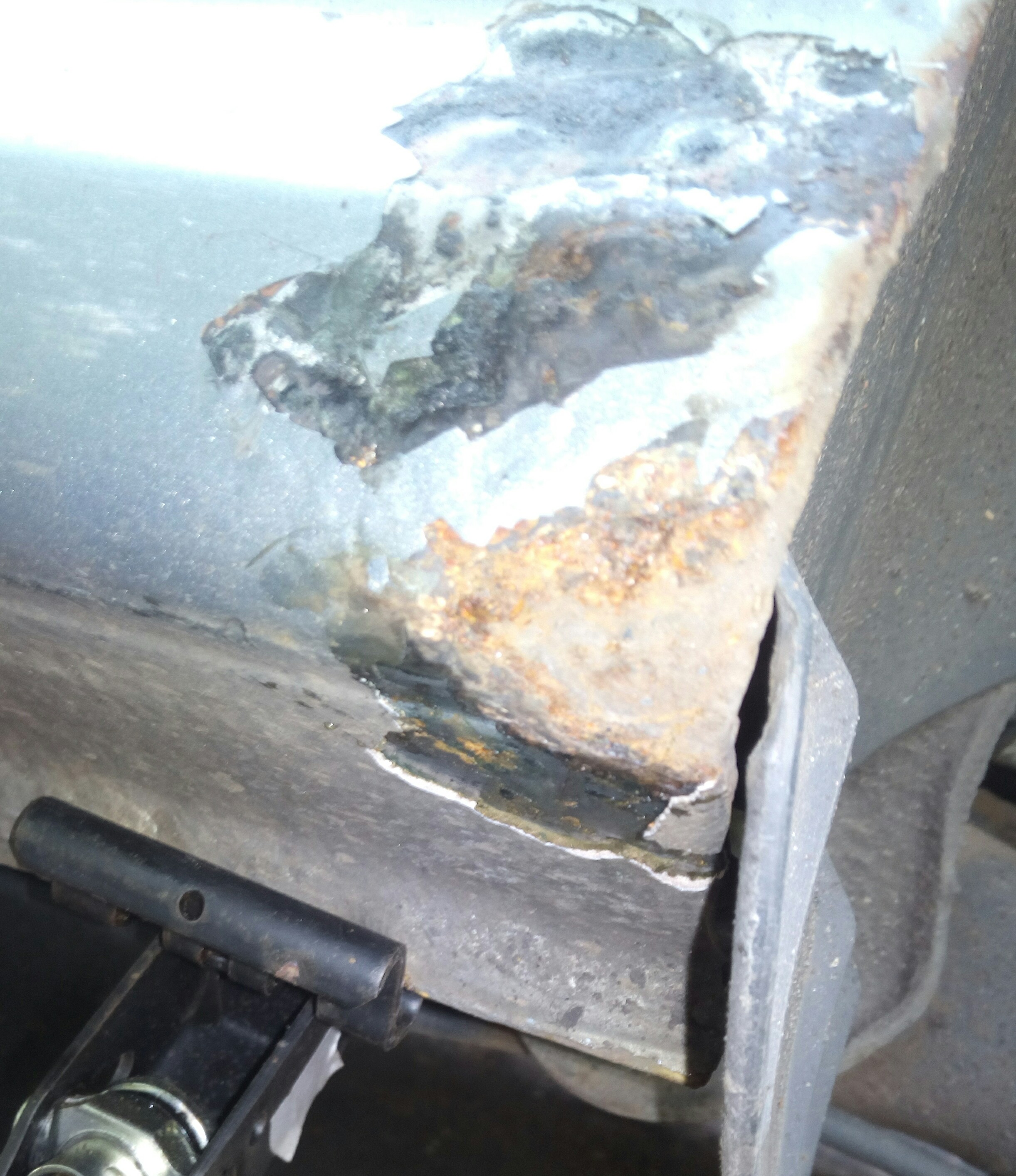

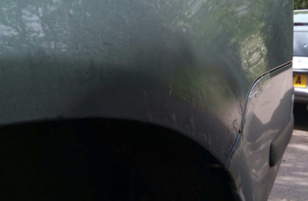

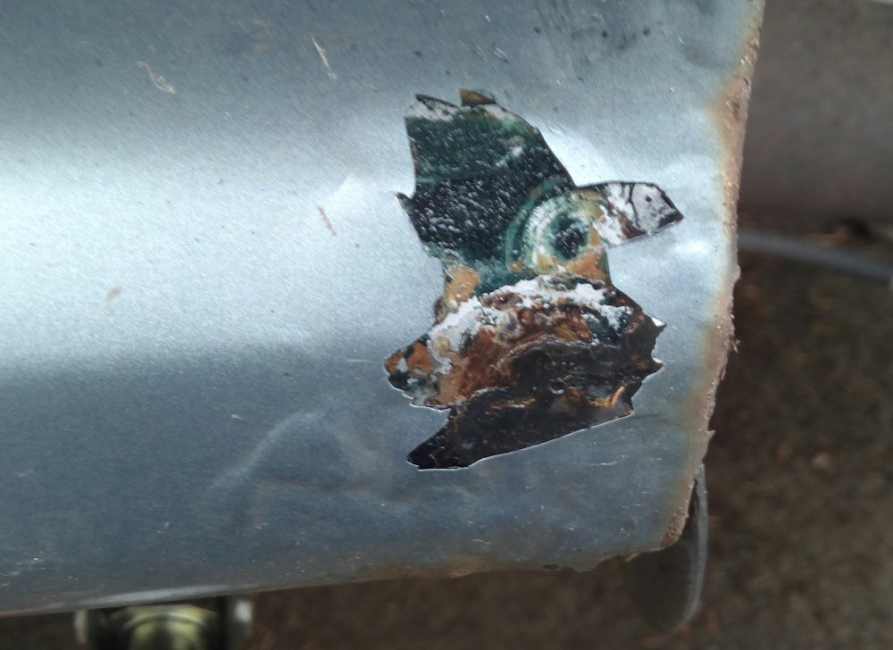

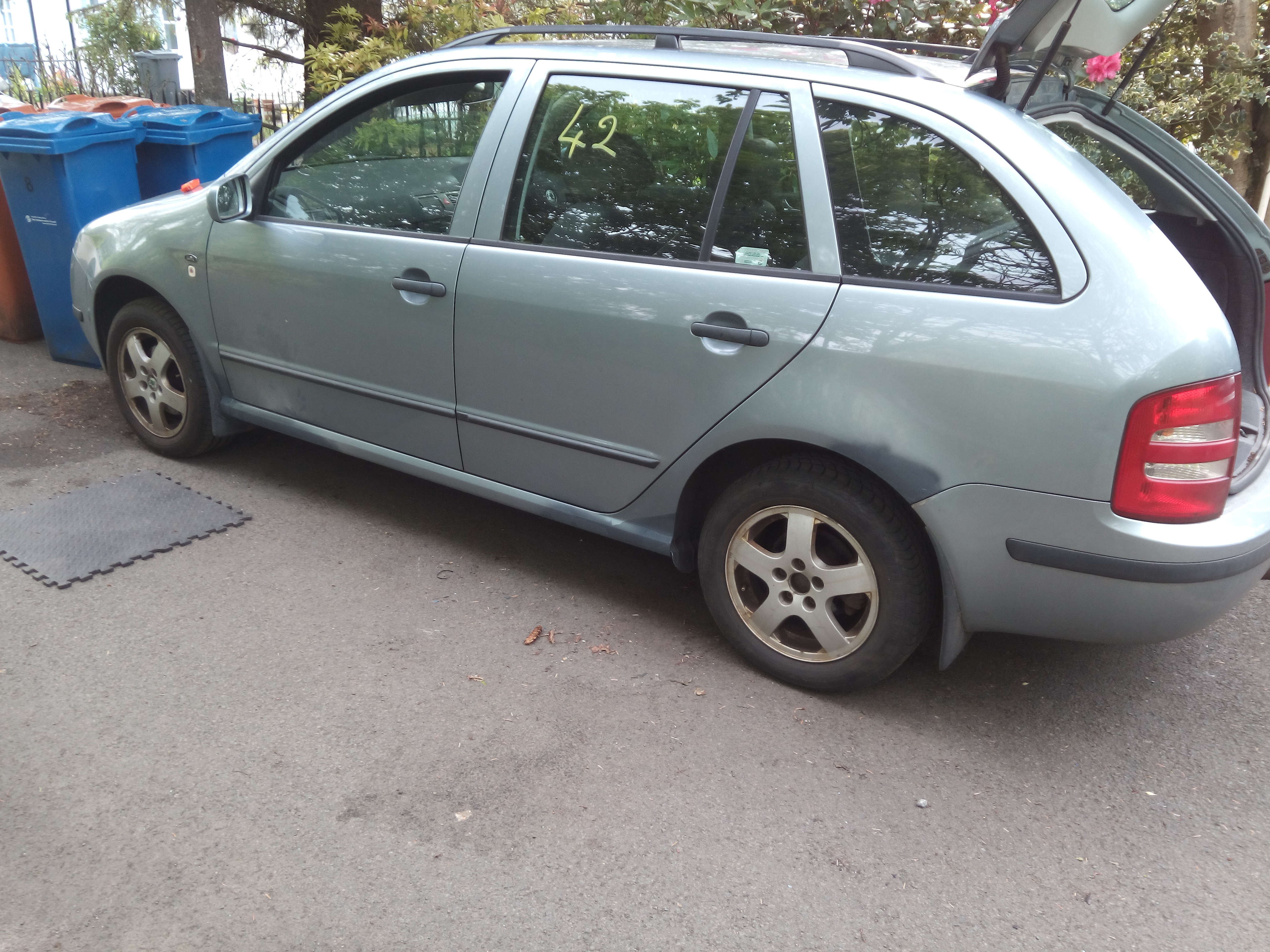

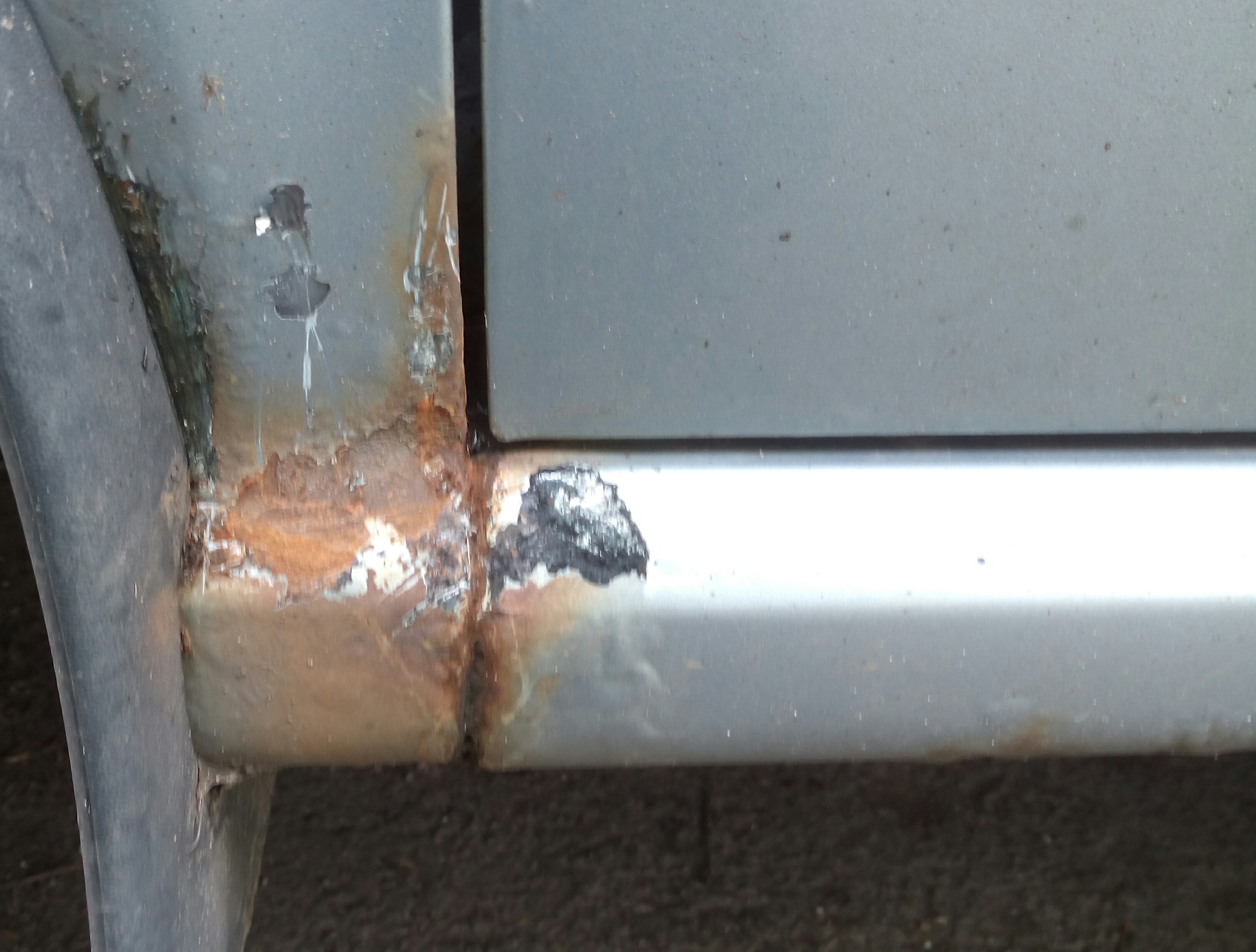

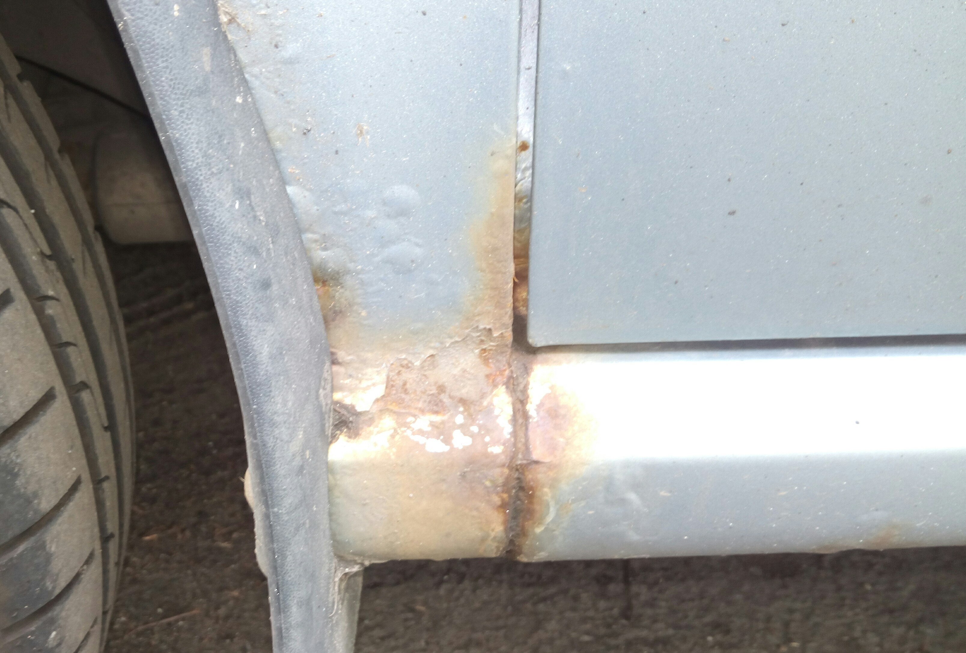

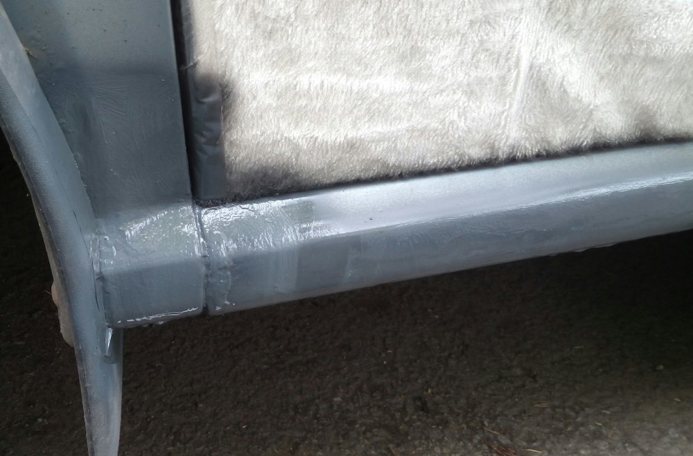

Today, I cracked out the Vactan and the drill, having at the copious quantities of surface rust to be found at the lower extremities of the car.
I did the passenger side first, as it was the better of the two (All being relative!)
If I'd found holes on this side, then there was no way I'd be attempting to get it through an MOT in Sept. Luckily it appears solid:)

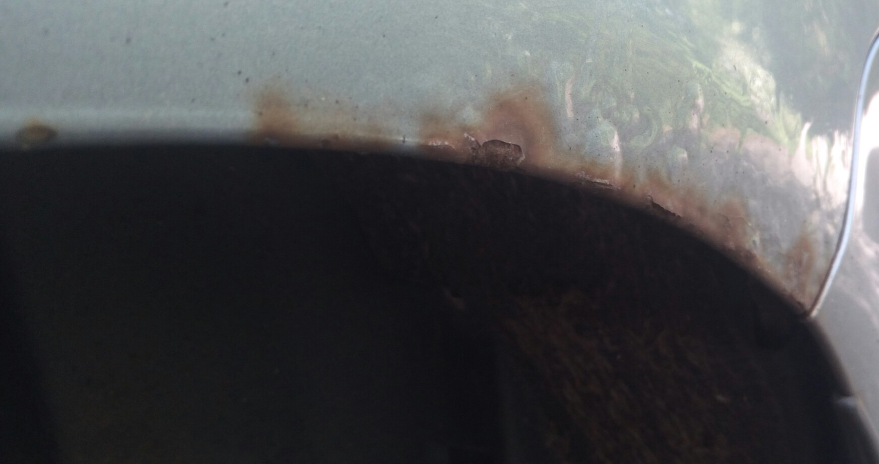

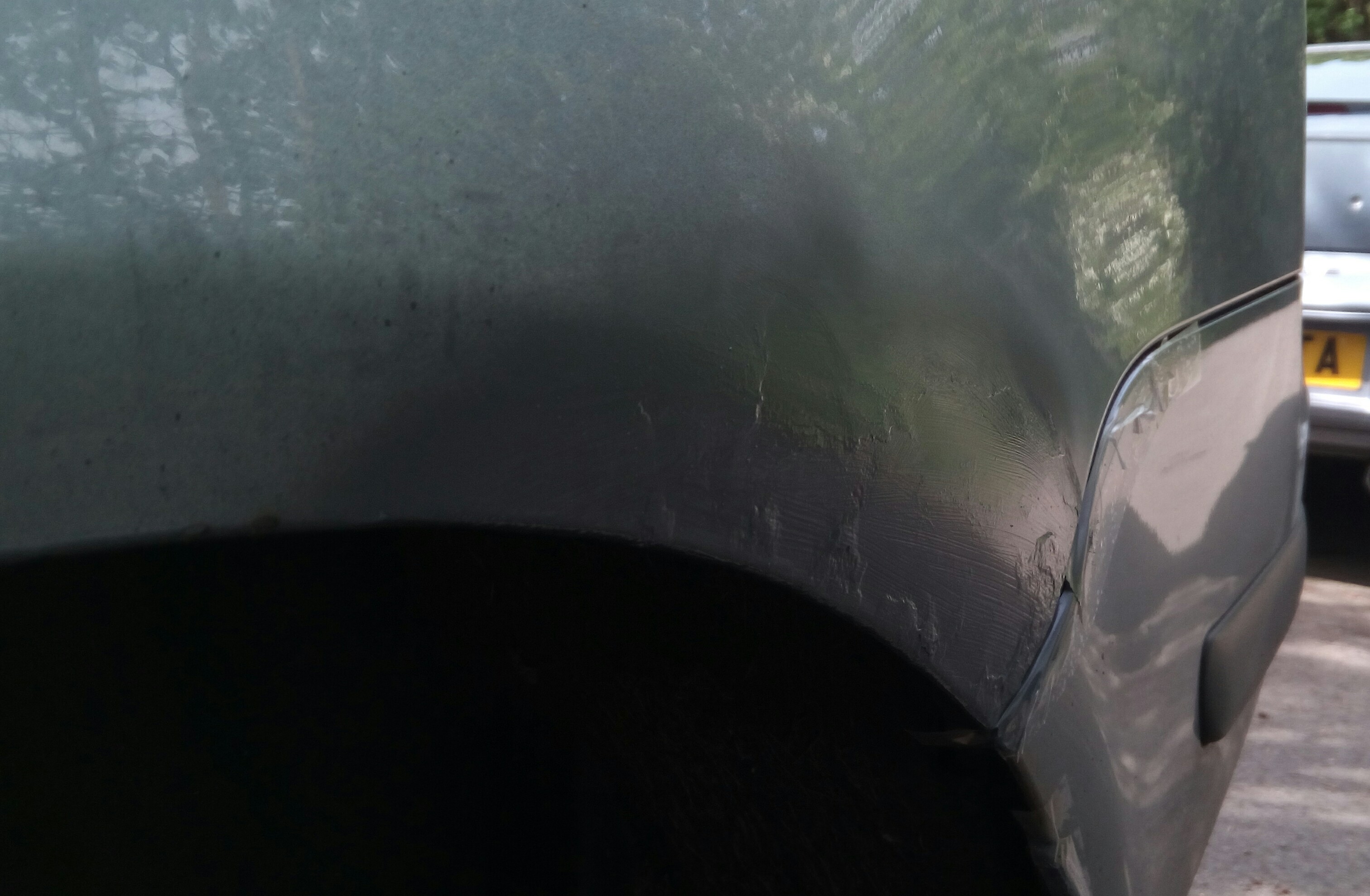

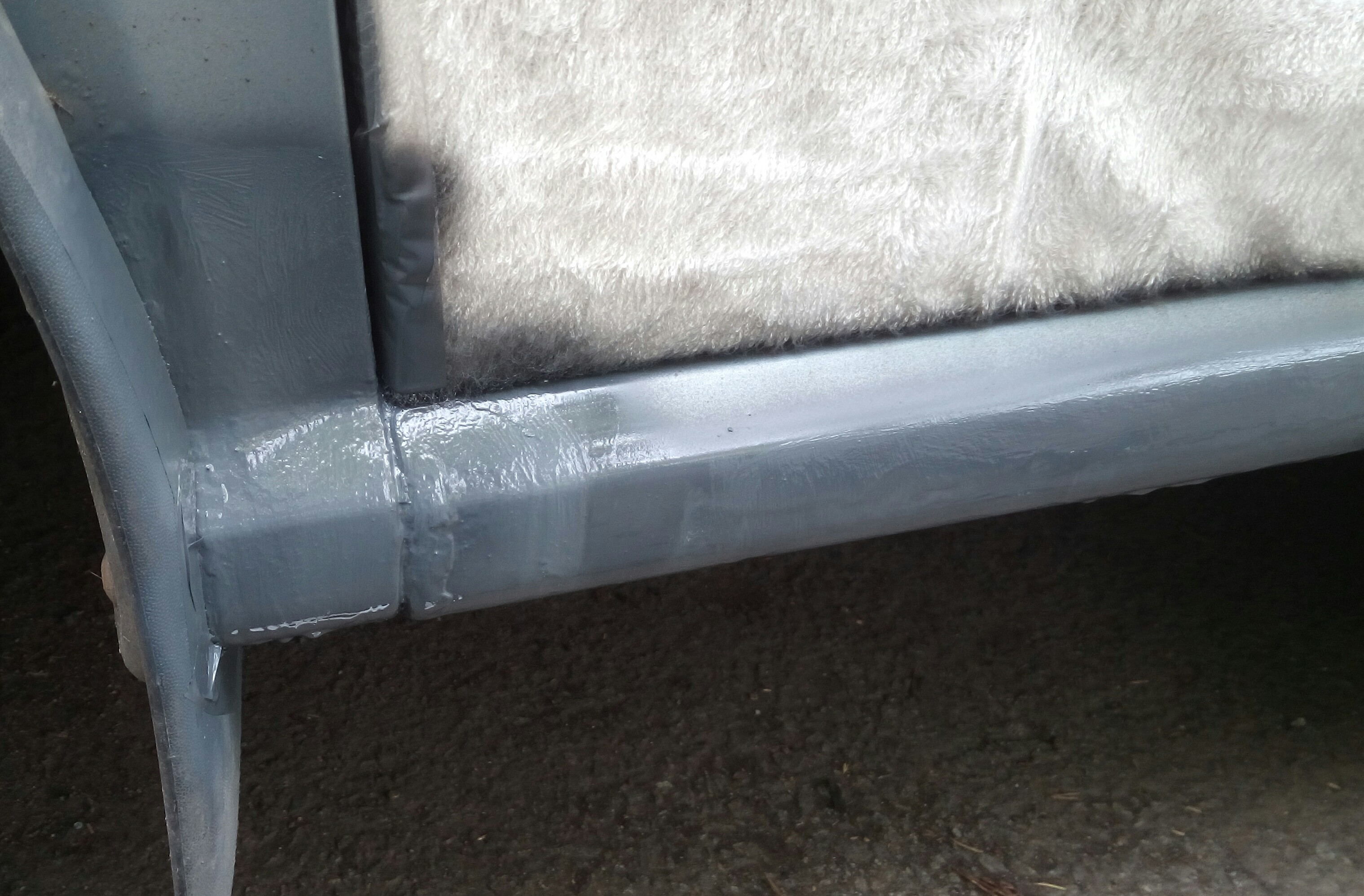

Each patch was stopped, treated with Vactan, and then primered with Poundshops finest.. Totally Giffer.
I'll get some actual paint mixed shortly and tidy it up- the key thing was getting it stripped and protected
Rear Arch First.
Edited by WoodieGuthrie

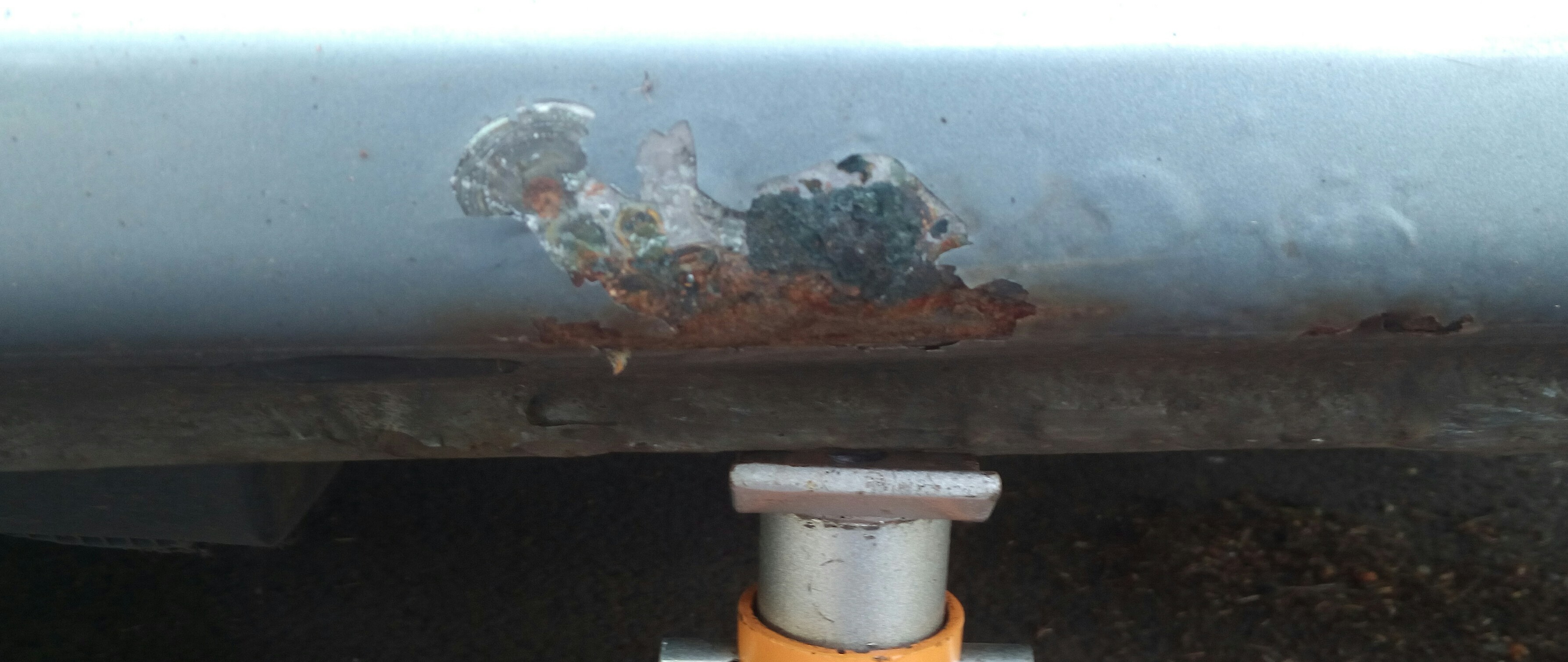

Then the Rear of the Sill

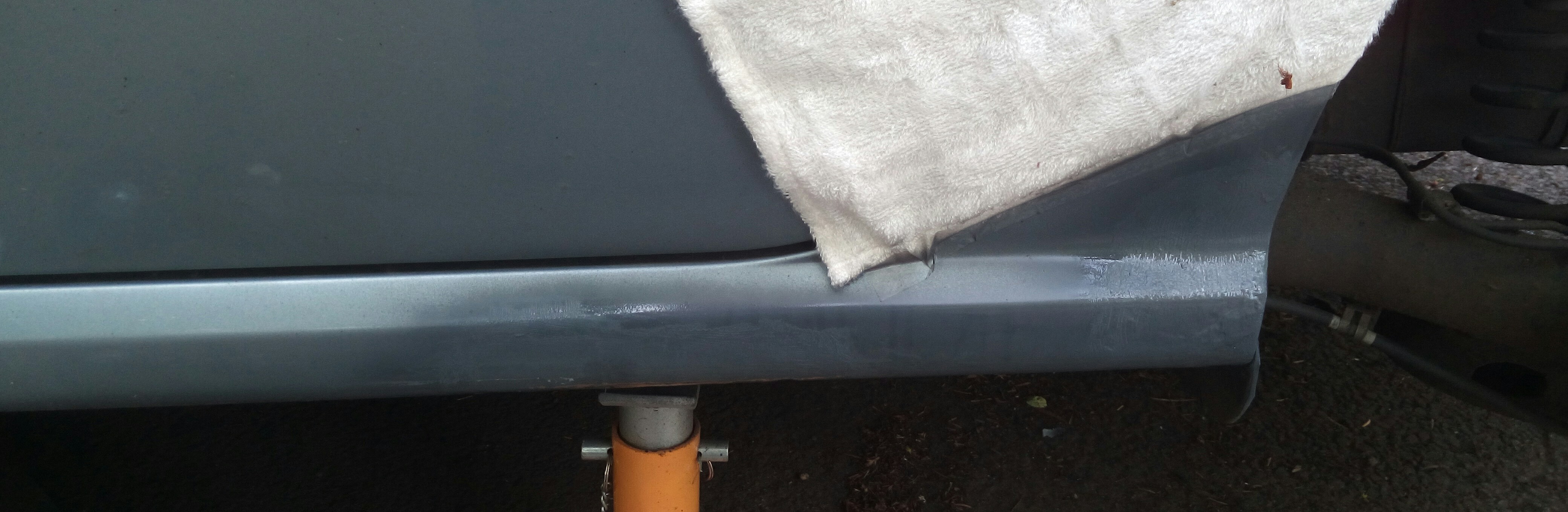

The Front of the Sill (I'll need to clean the mudflap with thinners later)
Both patches were cleaned up much further, but the photos didn't come out:(
Here it is in all its Giffer glory!

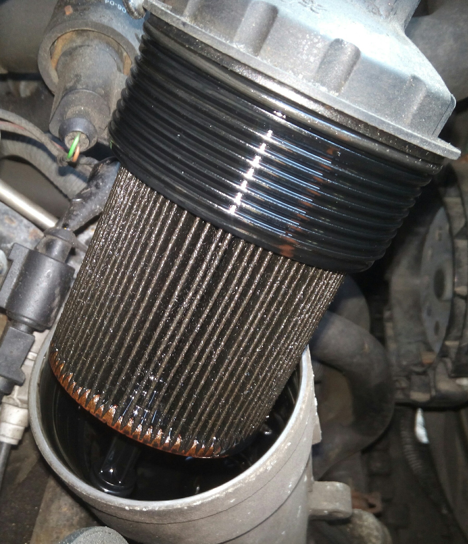

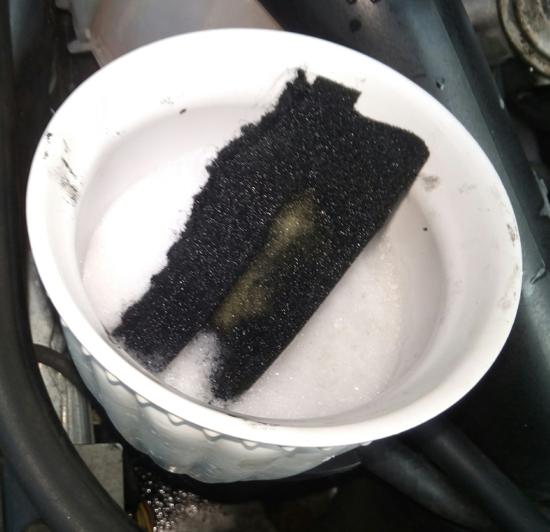

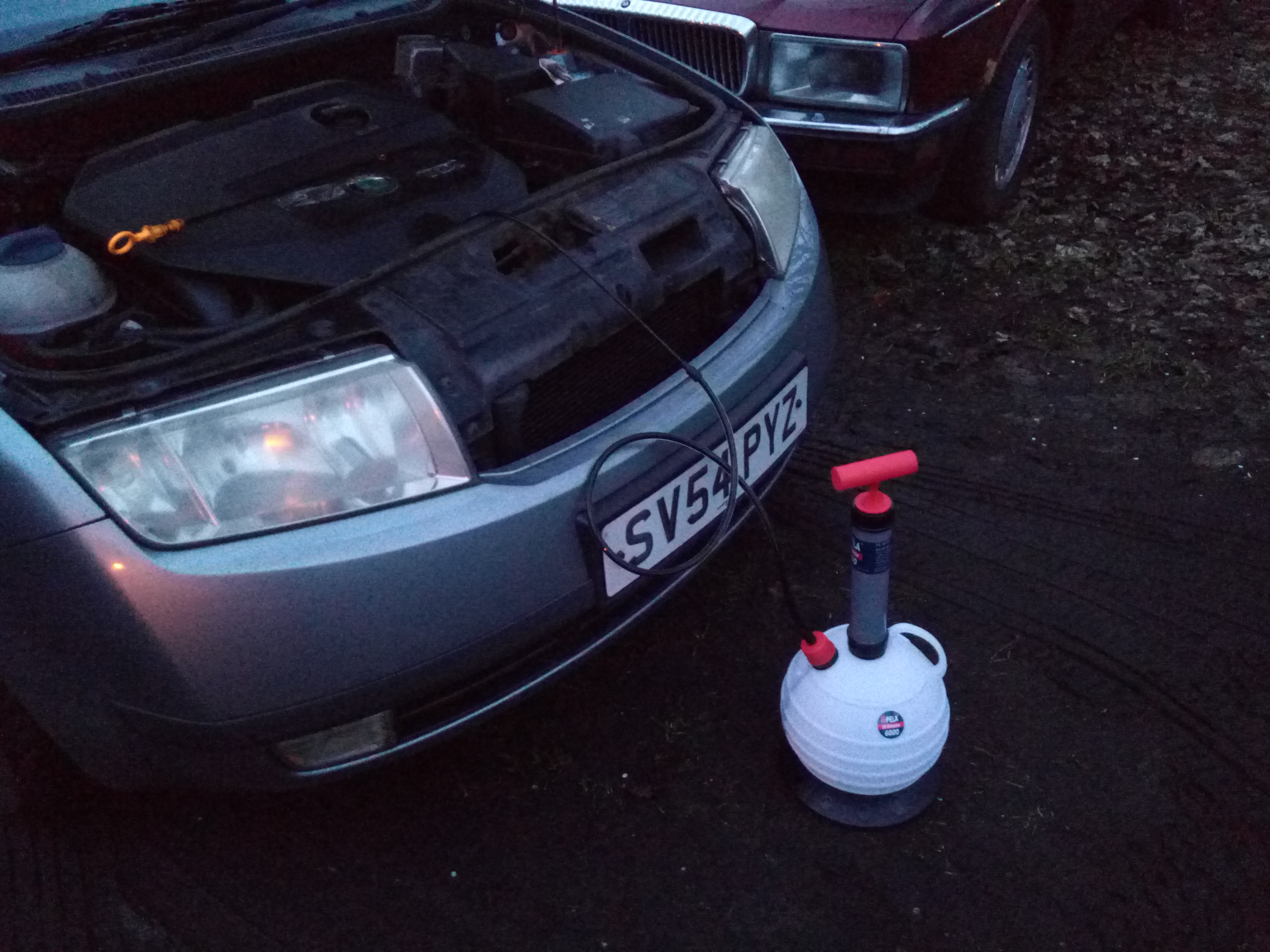

I changed the oil again on this today.
The filter was 13 weeks and 5700 miles old..

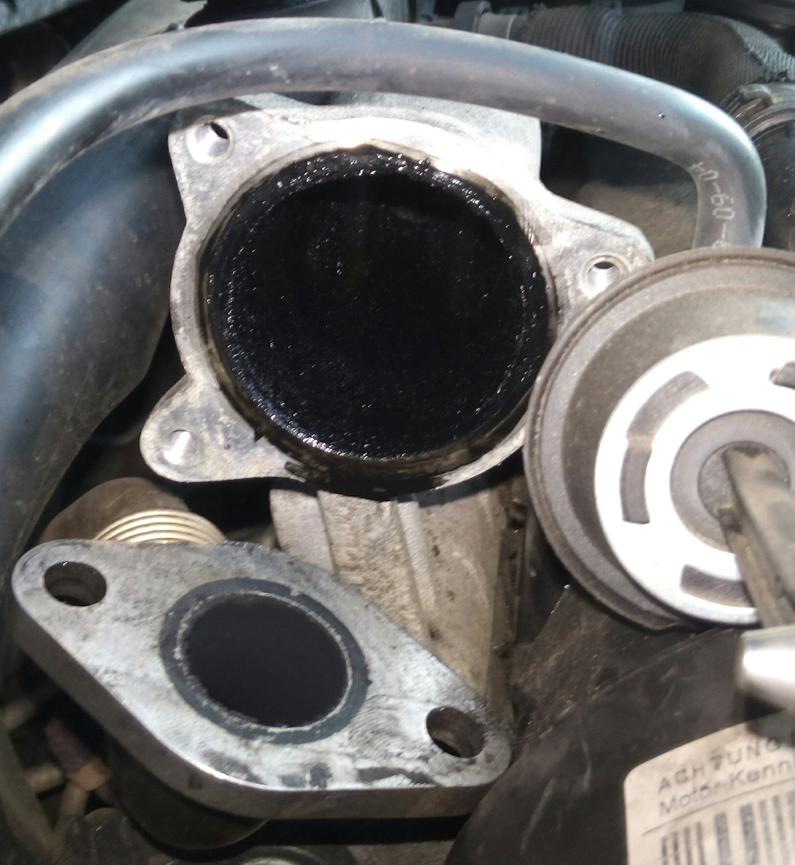

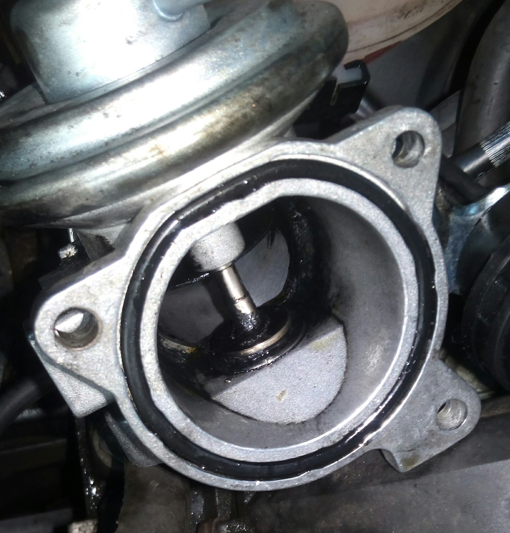

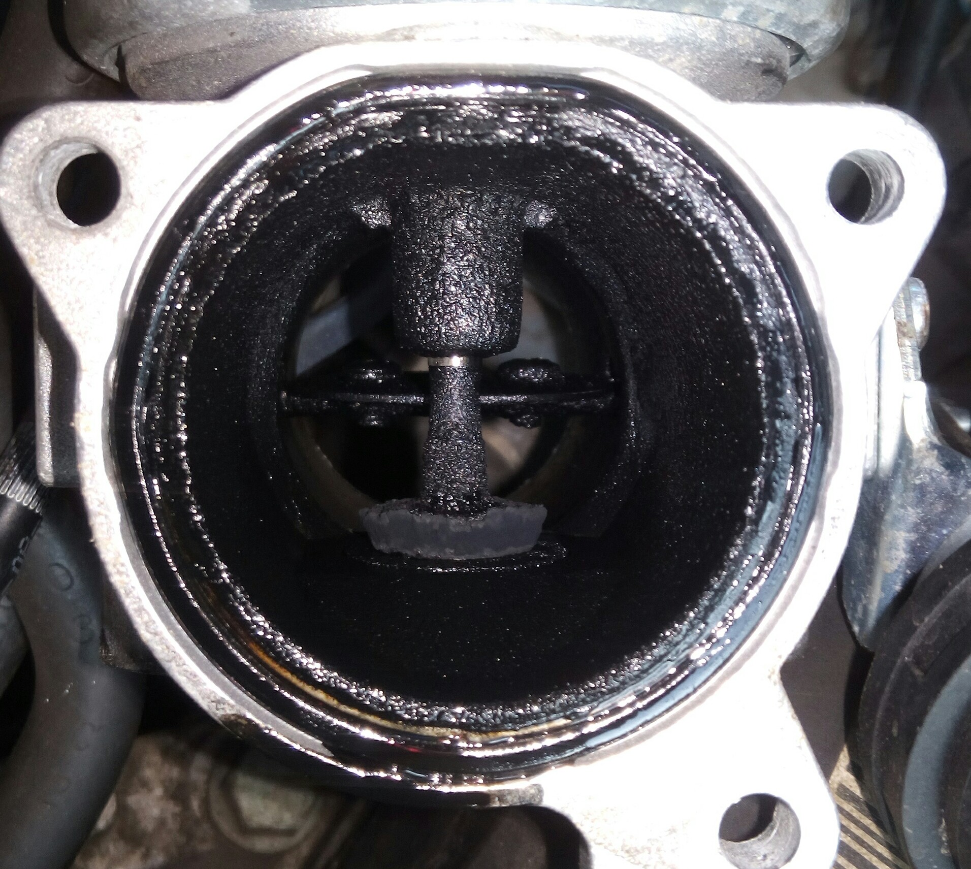

I wasn't particularly impressed with the state of it, so set about taking apart the EGR to see if it was blocked up.
It wasn't too bad, but gave it a bit of a clean and will see how we get on.
