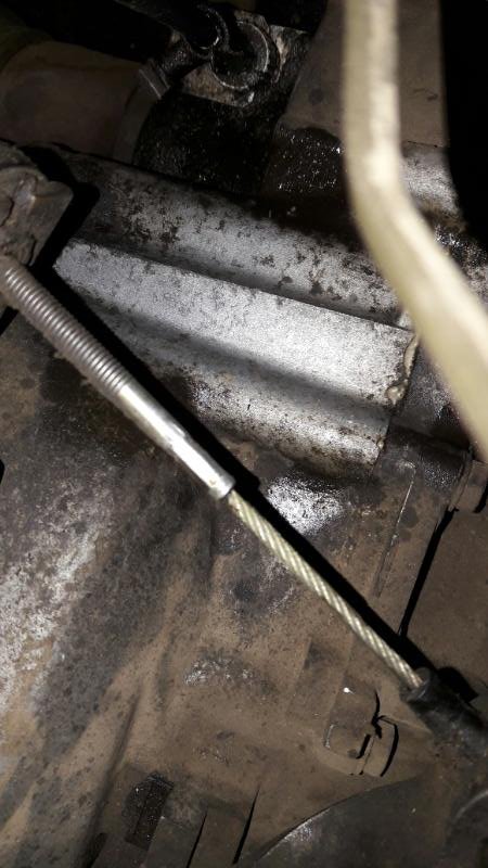

hi everybody i have felicia 97 and i changed 10s gearbox because it was broken but when i looked for part number in my new gear box 14sk but i was shocked when i dont found the part number please any one have information about this tell me

i mean identification number that should be in this place
OK, so we're talking about the identification number. By looking at your photo I see that the housing of the gearbox is very corroded and very dirty. Cleaning the housing resulted in identification number vanish. Skoda stamped the identification number very faint on gearboxes. You can hardly see it on cleaner gearboxes too.
Now you're probably asking if the identification number is stamped in another place. It isn't. The only other method to identify the type of the gearbox is by its exterior shape (see illustration).
Why is it important for you to know the identification number? What doubts do you have?

I clean it well and there is nothing and my reason for looking at it because the i dopt its 1.9d gearbox so i want to make sure also as i heard disel gear box have poor performance on petrol engines bec diff in final ratio
Yes, mounting a Felicia diesel gearbox on a Felicia petrol engine results indeed in poor performance. As I have said in my previous message, the easiest way to know what final ratio has your 14SK gearbox is to look at its housing. If it is not reinforced, it is for a 1.3 engine.

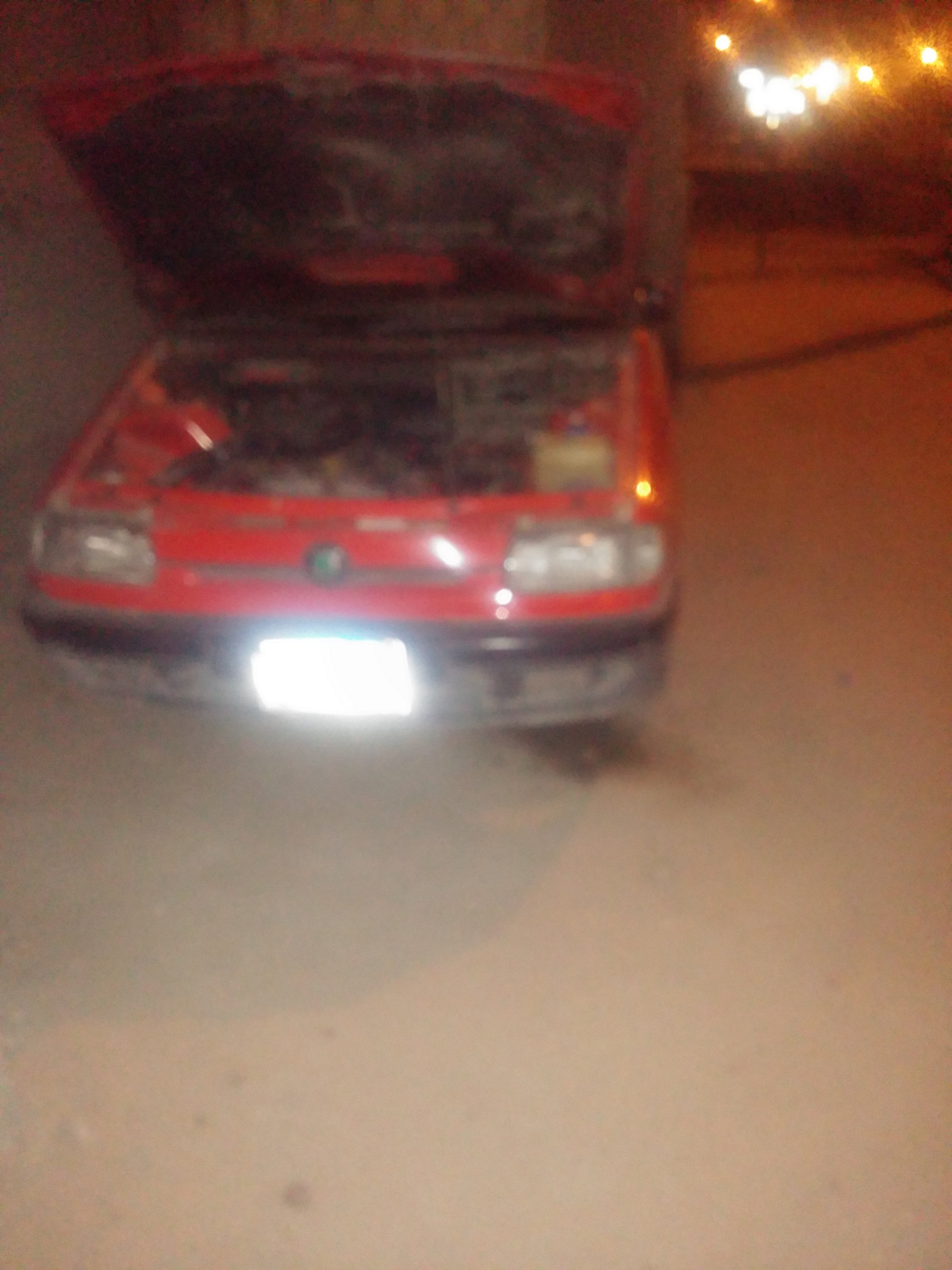

You claimed many tines that you live in Egypt. Show me a photo of your car.

Show me your car.

Idk what is the important of the photo to this topic :wondering:
