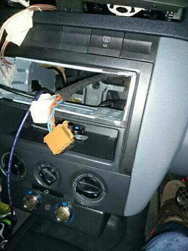

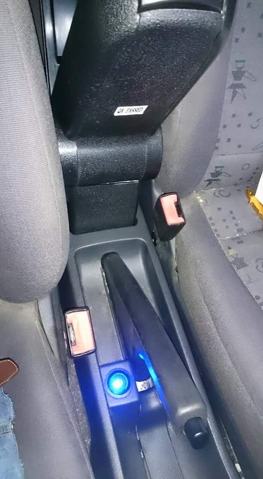

Rerouted mine, added on off switch too
I did as clarendon462 had done, bought one of those piggy back fuses and fed the dual socket and dual USB from the rear wiper fuse.
I have the sockets stuck on to the underneath of the centre console with Velcro and it is working fine thanks :)
