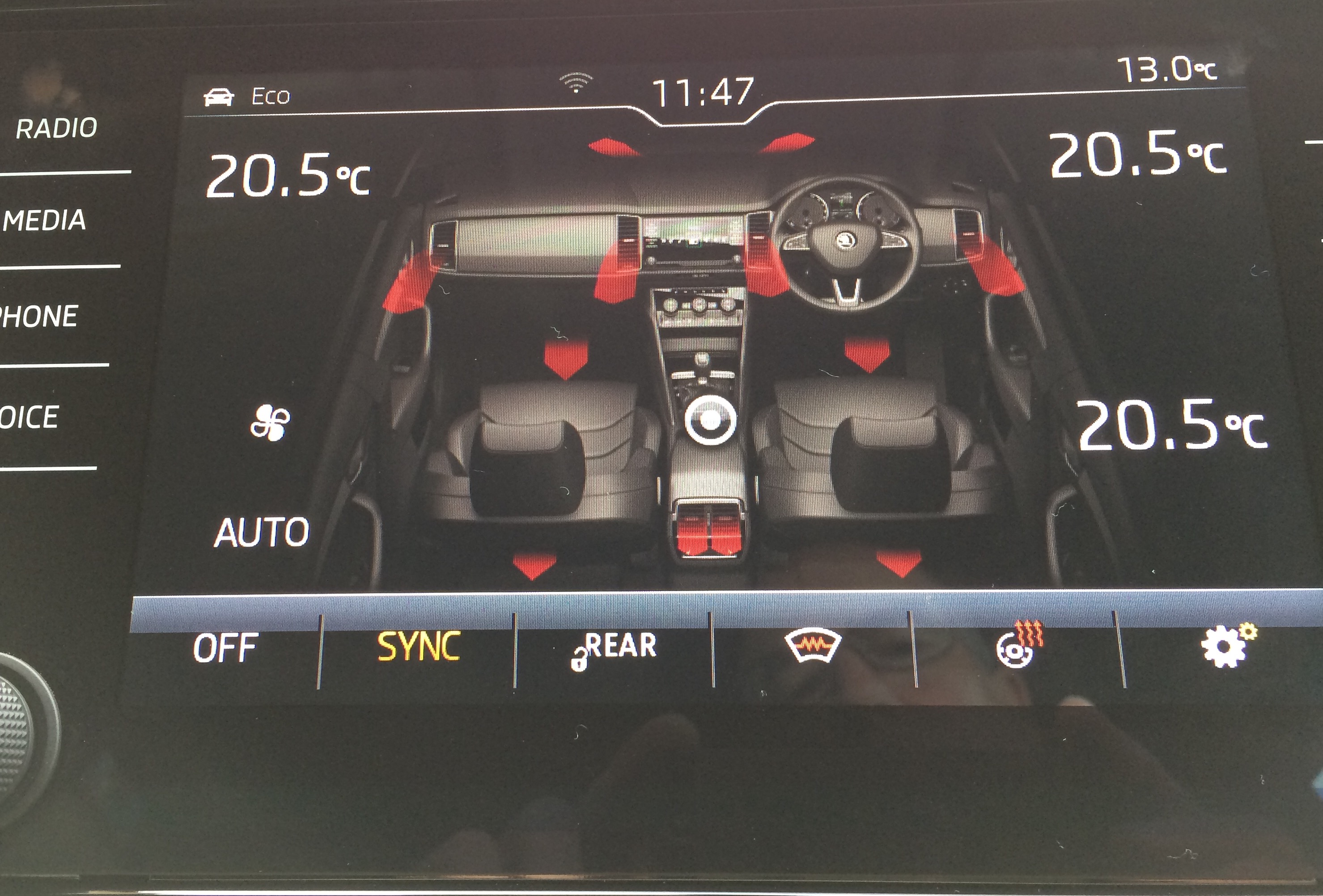

1. The temperature control SYNC button wrongly operated from the LH knob as it would in a LHD vehicle (as shown in manual)

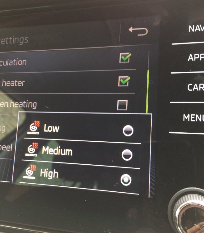

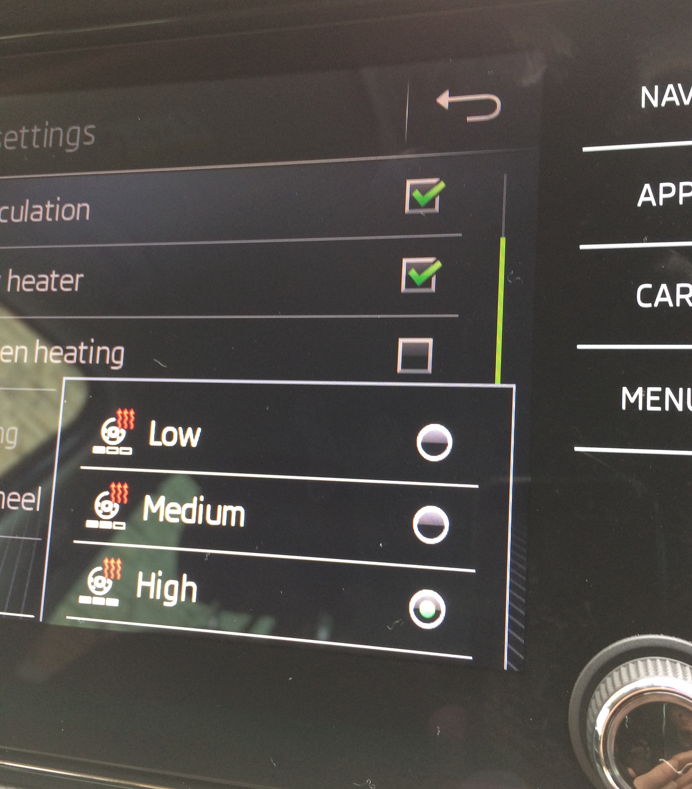

2. The heated steering wheel controller was absent from screen (surprisingly the hot wheel is automatically included with the DSG paddles)

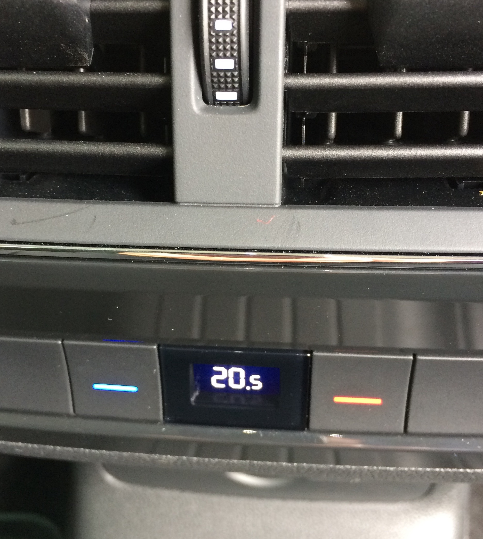

3. The rear seat Tri-Zone climate control display and buttons were absent from the rear seat (although I had rear temp control on the big screen)
On d-day I had noticed item 1, but even if I'd noticed items 2 and 3 I'd still have taken the car away for later remediation. I was very disappointed to be told this would not be a quick "while you wait" fix as they didn't know what the problem was or how to fix it or how long it would take to fix.
Turned out to be a a pretty quick fix though it took 3 shots with the config tool. The technician called me to explain how things had been fixed and the technician's report that was read out to me upon collection.
