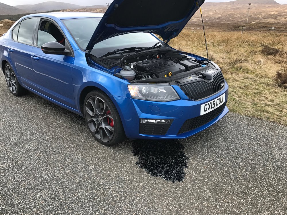

Hi Everyone, I have the car back! A bus journey in the Outer Hebrides, and then a horrendous 60 mile drive in snow and sleet, I am back on The Isle of Harris. I spoke to the sales rep who I dealt with when buying the car, and he will ring me tomorrow. The garage in Stornaway, charged me £120, which I paid, so I need to get that refunded. I am inclined to insist on a full check of the car when I get back home, would this be unreasonable? Or what do others suggest? I am not looking to 'cash in' on this, I just want peace of mind that its reliable.
Wish me luck for my 720 mile drive back to Brighton tomorrow night!
Christine

    That's why the plugs should be replaced as part of the service.    12 years in, all with VW Group, thousands of services done - never had a sump plug fall out or leak.
We had a spat of VAG group "sump plugs" falling out at work (halfords autocentre's) and it was nation wide (both petrol and diesel), it's now company policy to fit new sump plugs and torque up to 25nm's, this is then signed on the job card by the technicain who carried out the service and by a quality controller (of which i am one).
It was found  to be the threads in the plugs getting damaged as they were removed, when refitted they would not torque up properly and subsequently fall out.
Acouple of the local dealers by us are now doing the same thing as it has happened to them.
Not come across the plastic type plugs yet.
It should have always been company policy to fit new sump plugs.

The plastic plug on the tsi is fine.  its impossible to misthread, it goes in with only about 3/4 of a turn and snaps/clicks into position securely.  a 2 pence coin makes the perfect tool to remove and refit.
Does the MK octy have the plastic type or metal type?
Plastic on Octavia 03 VRS tsi

Sounds like the sump plug wasn't tight. Car on a long run, engine nicely warm and the plugs fallen out. Speaking from experience if you've stopped asap then it won't be a problem, there will have been enough oil coating the engine for it to be ok. Had a jet engine once where the mechanic failed to fasten the oil filler cap, light came on when it lost its oil, shut it down. When we got back, (we had two engines!) as we needed to go again, the mechanics checked it over by spinning the engine manually and checking for "any roughness" in the main bearings, filled it up with oil and off we went! Mind there was a war on! Still when we finally got back they sampled the oil for bits of engine and found nothing. The engine was still attached to the airframe 6 months later working fine!
