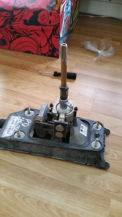

I'm in the process of making a short shift for my fabia vrs. I'm retaining the push down reverse and standard gear stick but am also making an extended stick depending on how short the throw ends up being.

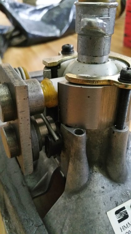

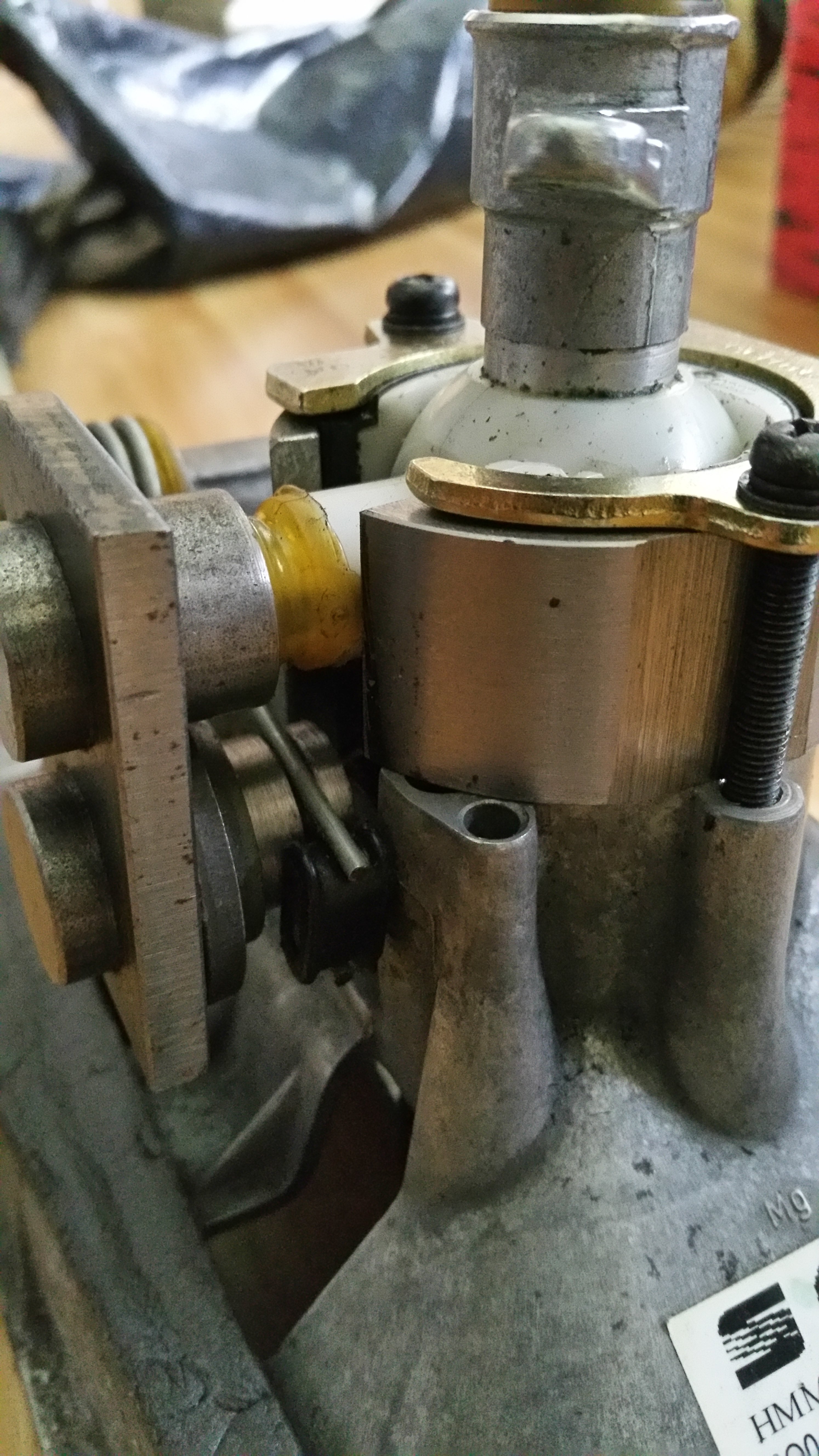

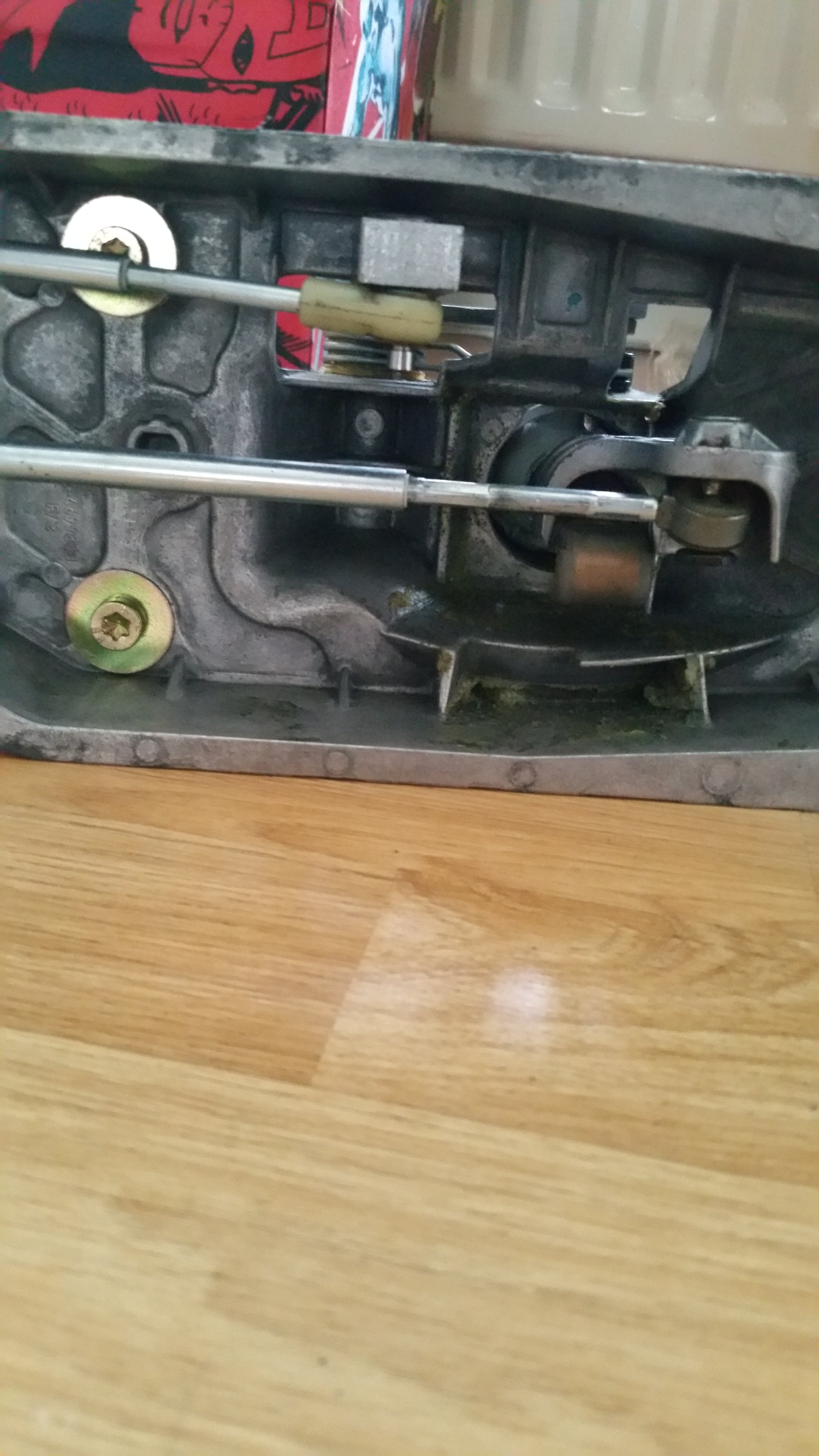

I've raised the shift point 25mm on the stick for the forward and back movement and extended it 25mm from the bottom for the left and right movement. It's still in the test stages at this point and  I'm probs going to need to modify the spring part which brings it back to the center position as it's sticking. I've not tried it on the car yet as it looks a bit of work to fit and a bit pointless until I can iron out the bugs on the bench.

It's an experimental project I'm doing in my spare time as there aint anything on the market I've seen to buy. I've seen plenty of threads asking about short shifts for the 6 speed box but no actual short shifts available so thought I'd make my own.

Will do. I only wish my mechanical skills were as good as my engineering skills....... these things look a right pain to fit and as my car is my daily it's putting me off fitting it lol
