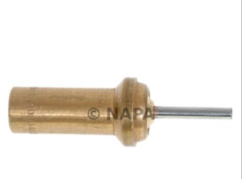

I checked the thermostat on the air filter to day, and some wirings. The valve - worm/cold air valve was locked at "winter position". I took the wax unit out and warmed a little with a lighter , but no reaction!
Then I locked it in "sommer" position with some wood parts.

Im looking for a new filter. If I can't find, I have to make manuel adjustment go take one from a Volvo or some standard from a water thermostat to fit in ?

I found two VW Polo filters with the same automatic adjustment to day! The thermostat was the same, but they was also bad! I four a third that was ok, may be, but I lose it inside the engine room. Unlucky!
So I will look more some other places and filter if I can find?
In the meantime I will make a manual adjustment.
That's a shame you lost it. Keep looking :)
Iwa inside a engine room, taking the plastic things away, and wips the little part was gone. unable to lift the car over and to move the polo under where I was. m not sure about the adjusting temperatures, but when there is 25 degrees outside, it should not stand on warm air position?
On the fine lost part the little pin stood longer out.
Like this:
nearly - the thermostat regulator

I think the regulator shall be like this i n20 degrees outside temperature - like a Volvo part...
