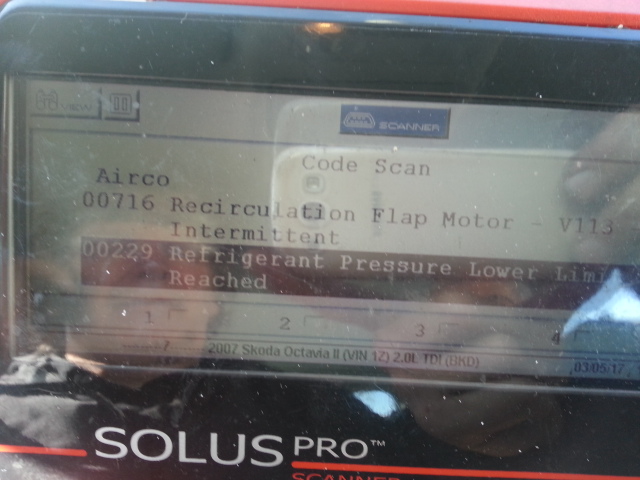

Are you able to assist in some way please?  I will try to be as concise as I can.  I have a 2007 Mk 2 Octavia, 2.0 tdi.  It has just over 100,000 as has during my 16 months of ownership performed without fault until recently. The car (having started without problem a driven several miles) refuses to start after a half hour stop.  It appeared as if the battery was flat but srated immediately with a jump start.  I recently drove it on a 500 miles trip without fault but two days ago I drove it to my home and this morning went to start it but it turned over as usual with no strange noises but refused to fire and run.  I changed the battery to a fully charged one and tried again without success.  Strange seeing as apart from a mystery battery discharge (mentioned above) there have been no symptoms.

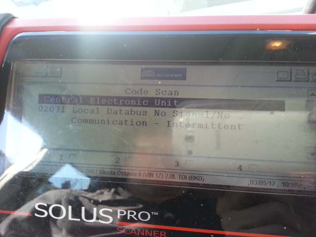

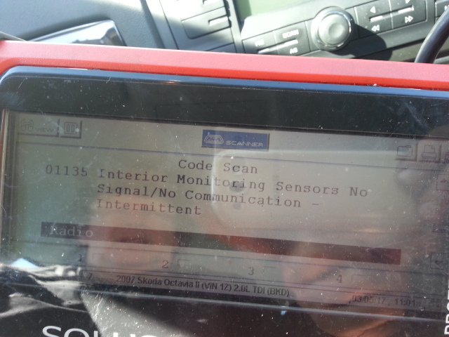

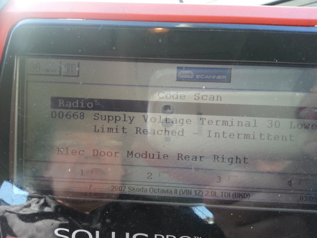

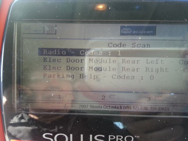

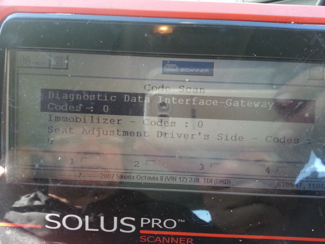

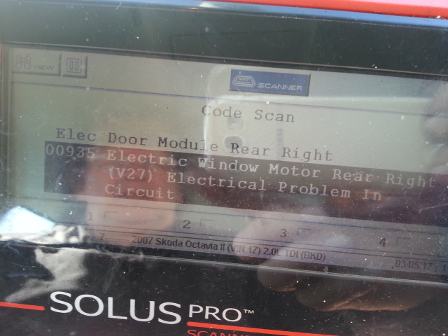

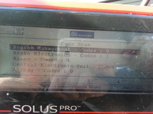

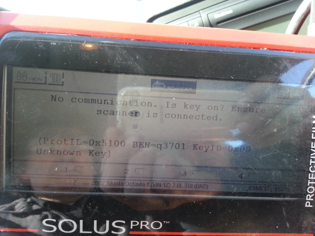

I asked my friend to assist with his Vag com (if that is what it is called) and I have photographed all of what he mentioned was the relevant info.  I add he is not an expert with the Vag com he simply borrowed it. I have attached the photos of the Vag com readouts.
I appreciate any information and help that you may offer. Thanks
Doh.. it's obviously not a Vag Com as its a Snap On Solus scanner.  As far as I know there were no fault codes and the engine cranked but showed no signs of firing.  The engine code is BKD.

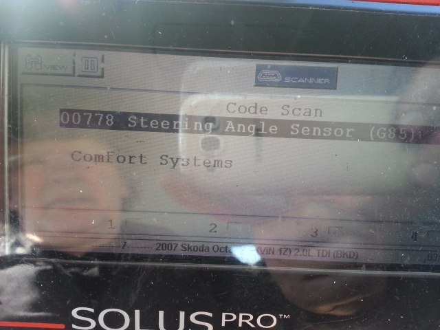

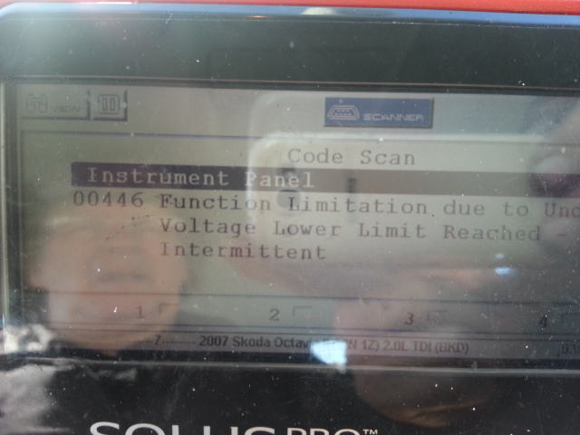

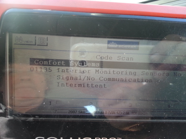

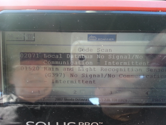

There is a lot of electrical/comm types faults there. None seem to relate to the engine not running. Diesels are pretty sensitive to good batteries and starter motors. If you are 100% sure the batteries are ok could it be the starter, you need to achieve a certain rpm before the engine can fire. Edit: did you try jumping again.

Thanks for your reply.  The engine is cranking well and the battery had just come off a full charge.  I have not tried jumping simply because there is no presentation of the engine cranking revs dropping or slowing.
 I'm guessing really with no diagnostic code relating to engine not starting.  Starter motor if it is not cranking at sufficient speed? VCDS may have a measuring block. Crank sensor.. No fuel - tandem pump or injector problem but would it affect all 4?.  I've never owned a diesel, so expect someone with more hands on experience may be along shortly...

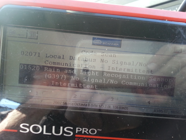

I have viewed the attached photos again and report that the Brake Electronics' fault (code 1) on the secong photo relates to a long standing dash warning light for traction control (skidding car) that I have yet to resolve but this has never previously prevented the car starting.

the first pic.......no communication with key....are you sure, the battery in the key is okay? Try your second key for starting! Look into the car´s manual how to reset/program  the key for the car....
