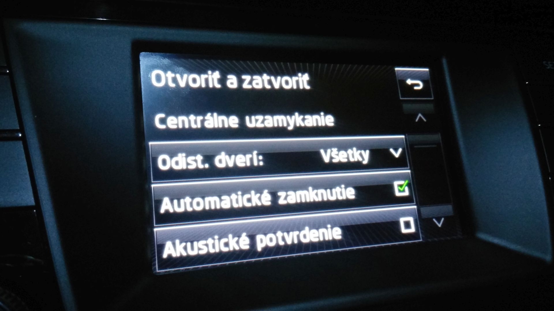

coded in my Fabia III 2016 Ambition Plus, Swing infotainment.
"Otvoriť a zatvoriť" mean "Open and Close" in settings
"Akustické potvrdenie" mean "Acoustic confirmation". car trumpet throught horn
(sorry for my english)
