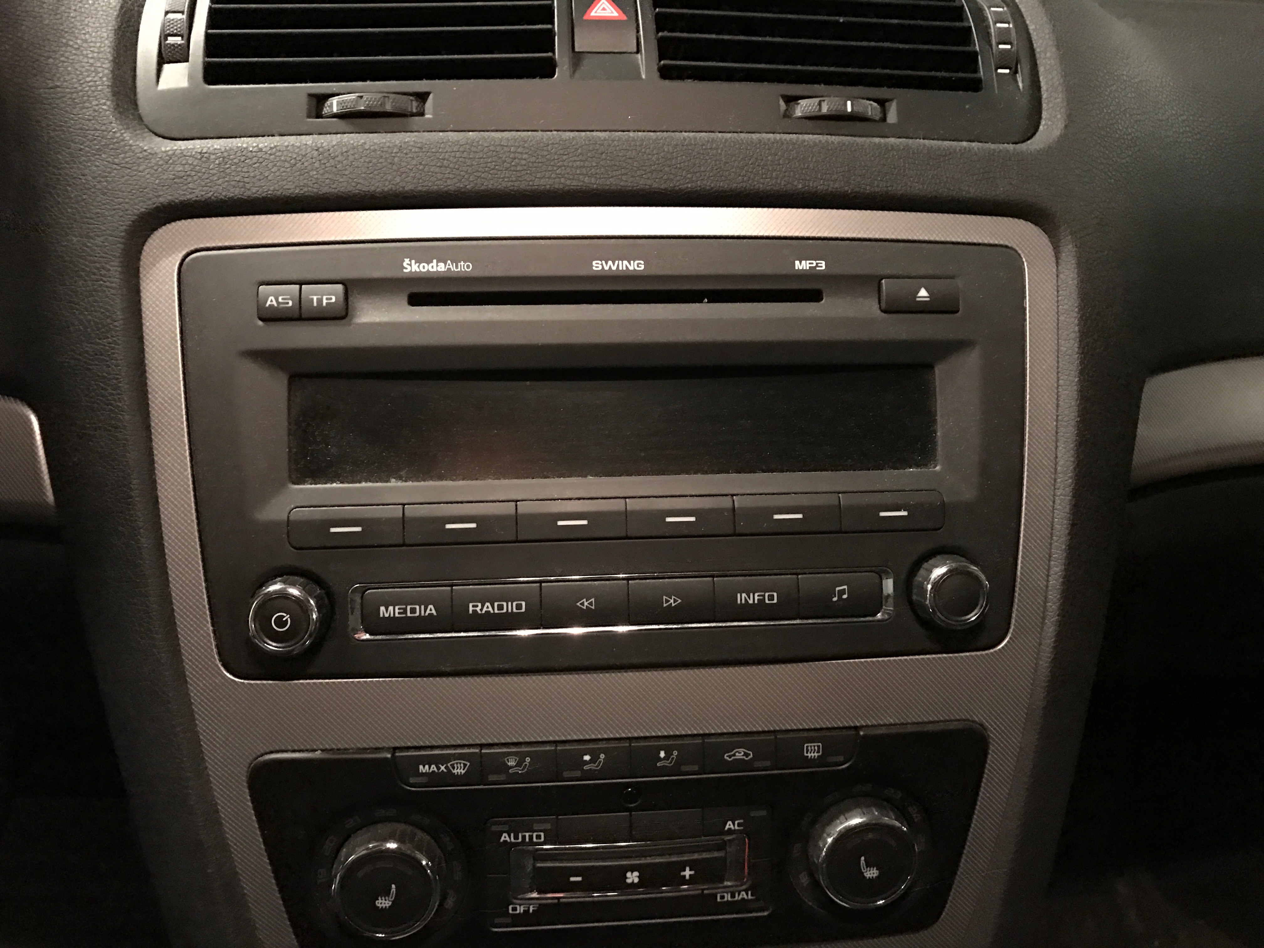

I will replace the original swing unit with a new Pioneer standard 2 unit player and I have a hard time finding what fascia to use.
I have googled and googled and even contacted Connects2 to get an answer. Connects2 said that they did not listing any adapters that will fit. I find that strange... All my local shops gives me different answers.
So, what Connects2 (or any other quality fascia) will fit a Skoda Octavia MK2 with a Swing radio?
I have found these two, but do the fit?
CT24VW12 - http://www.connects2.co.uk/Product/ProductItem/CT24VW12
CT23SK09 - http://www.connects2.com/Product/ProductItem/CT23SK09
Thanks!
Is it so that the Bolero and Stream has the same outer shape as Swing? So if an adapter fits Bolero or Stream it will also fit a Stream headunit?
  • 4 years later...
On 10/05/2017 at 15:40, langers2k said:
This facia looks about right: http://www.connects2.com/Product/ProductItem/CT24SK07
You'd still need a cage/adaptor to fit your headunit in though.
Thanks. After several years, I've found this one useful! Appreciate it.
