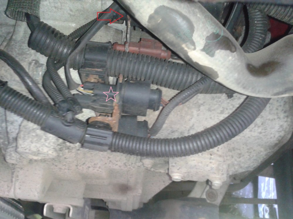

The first problem I encountered was that I found this wire down the battery.
After checking the source of the wire I found it came from t81a (ecu conector)
I have searched a lot and often I have not found the place of this wire or what it did.
Within the diagram it appears that it goes to point (6) but I have not found this point in the remaining diagrams.
Does anyone have any idea?

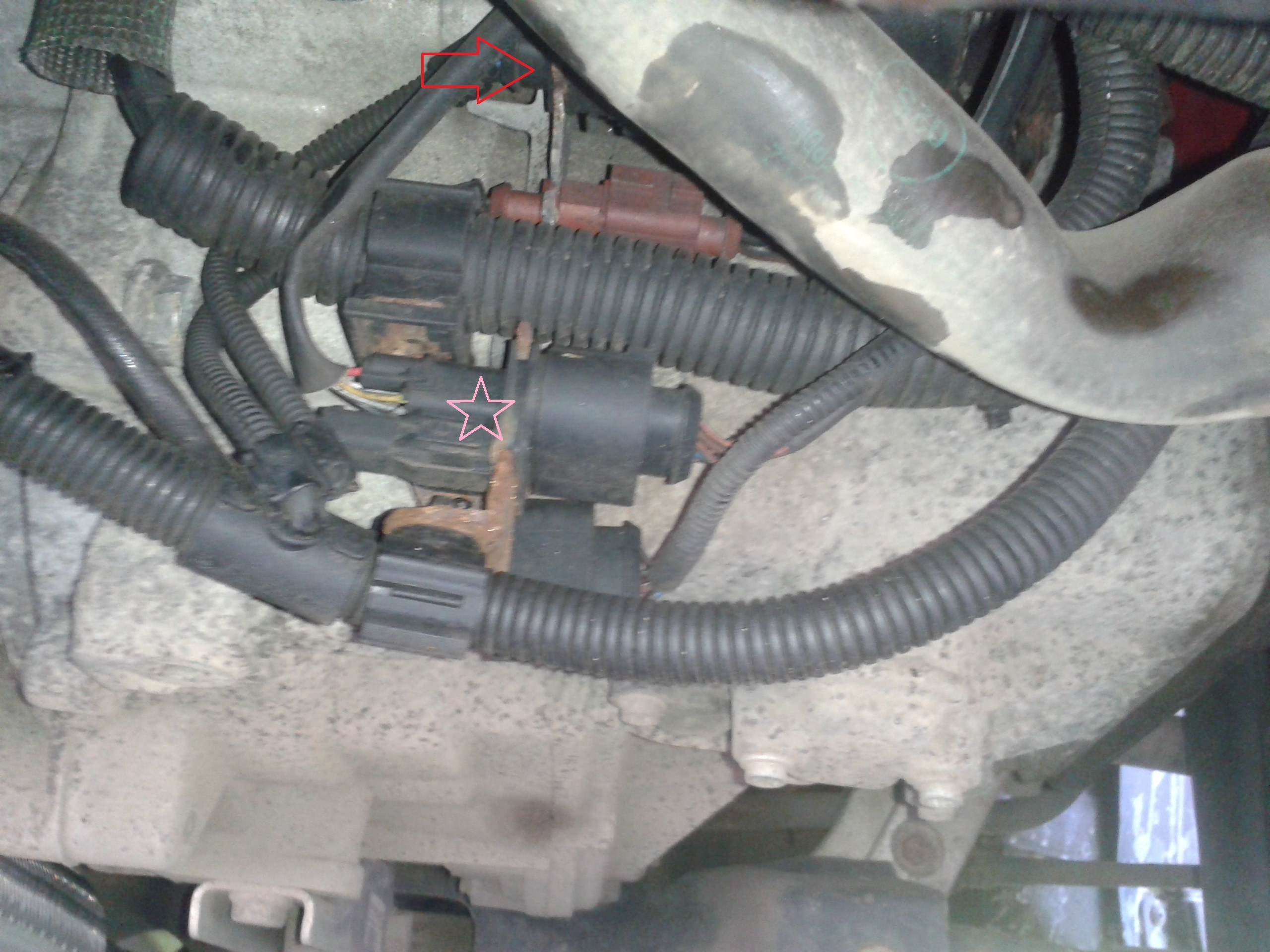

That's the DFM wire, originating at the alternator (brown where it comes out of the 2-pin connector at the alternator).  There's a plug/socket pair on a bracket at the front of the gearbox where the wire changes from brown to lilac/green.  The red arrow in this image shows the connectors on the bracket:

thank you very much.
I will connect it tomorrow.
