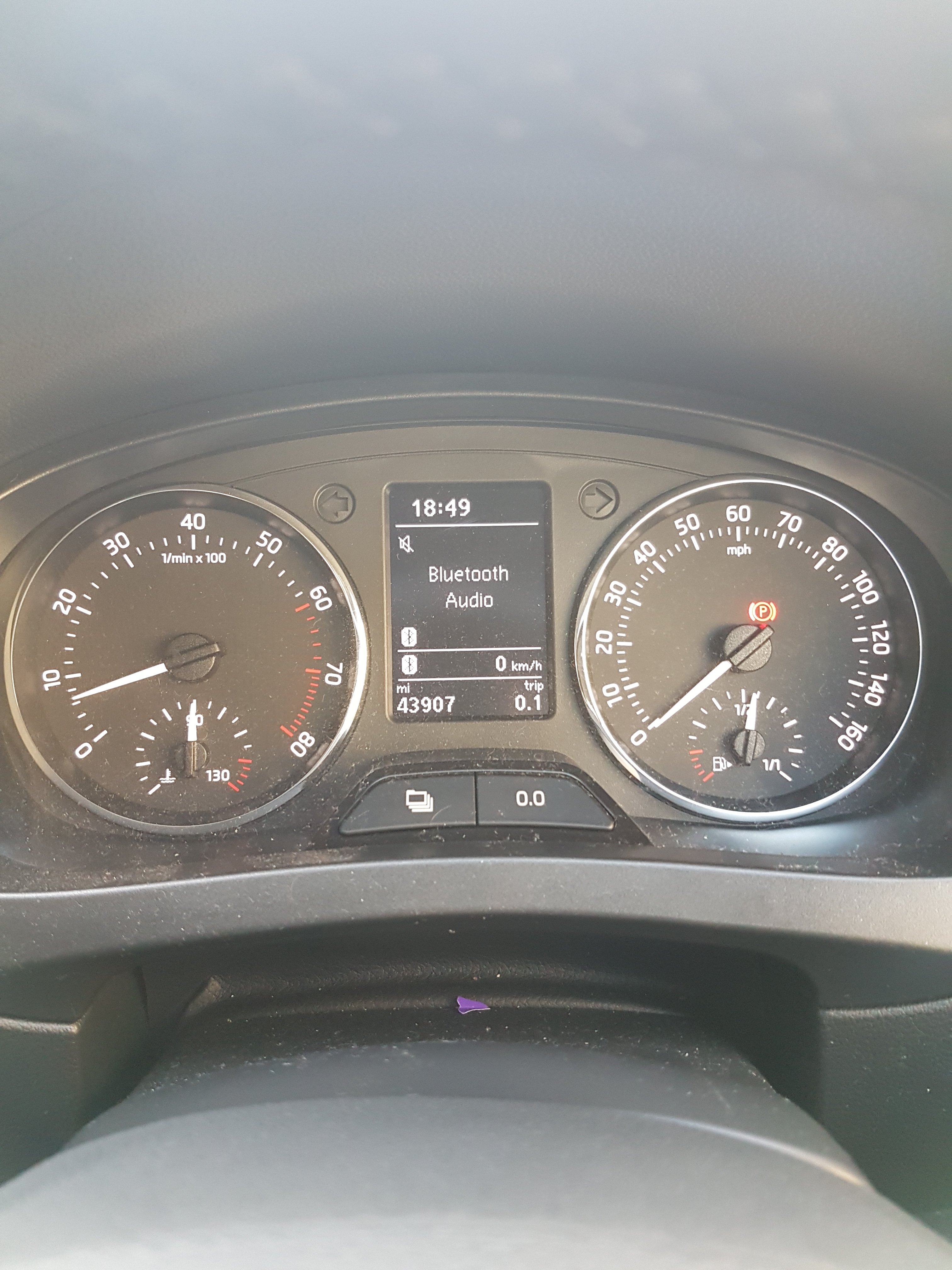

Anyone know where the bluetooth port is in the 2013 rapid? Bluetooth seems to be stuck in mute and resetting to factory hasnt helped...sound works for radio etc. Just not bluetooth...forgot connection tried multiple phones etc. No dofference...any ideas? Its driving me nuts
