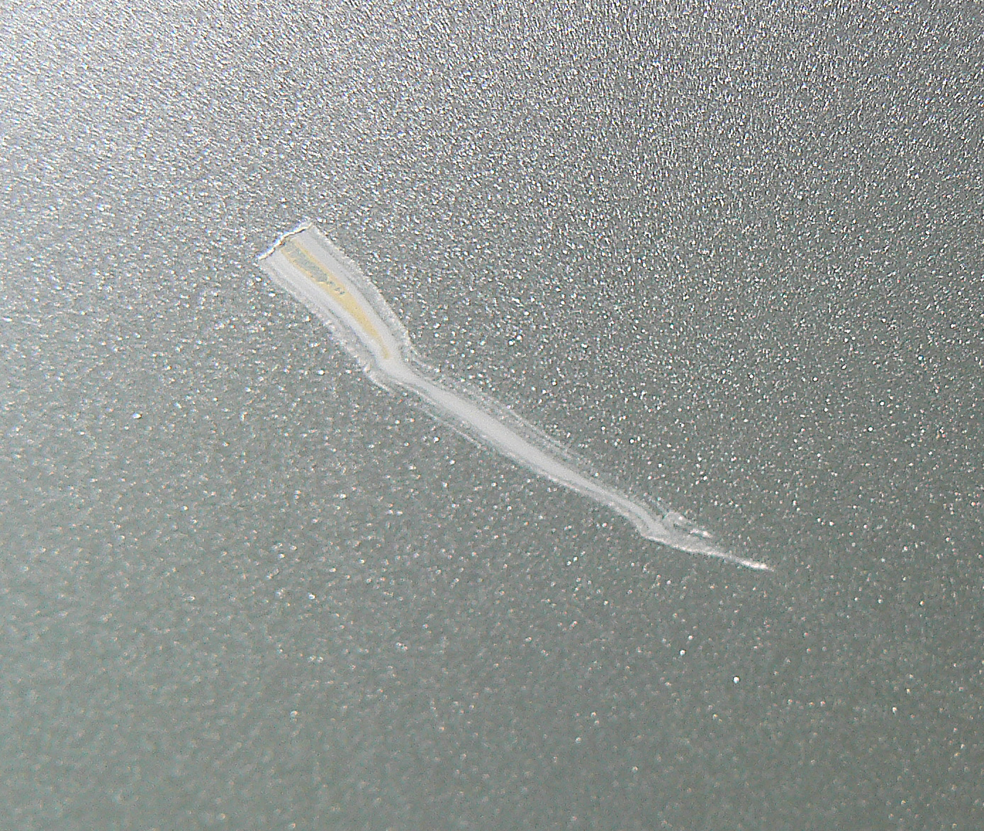

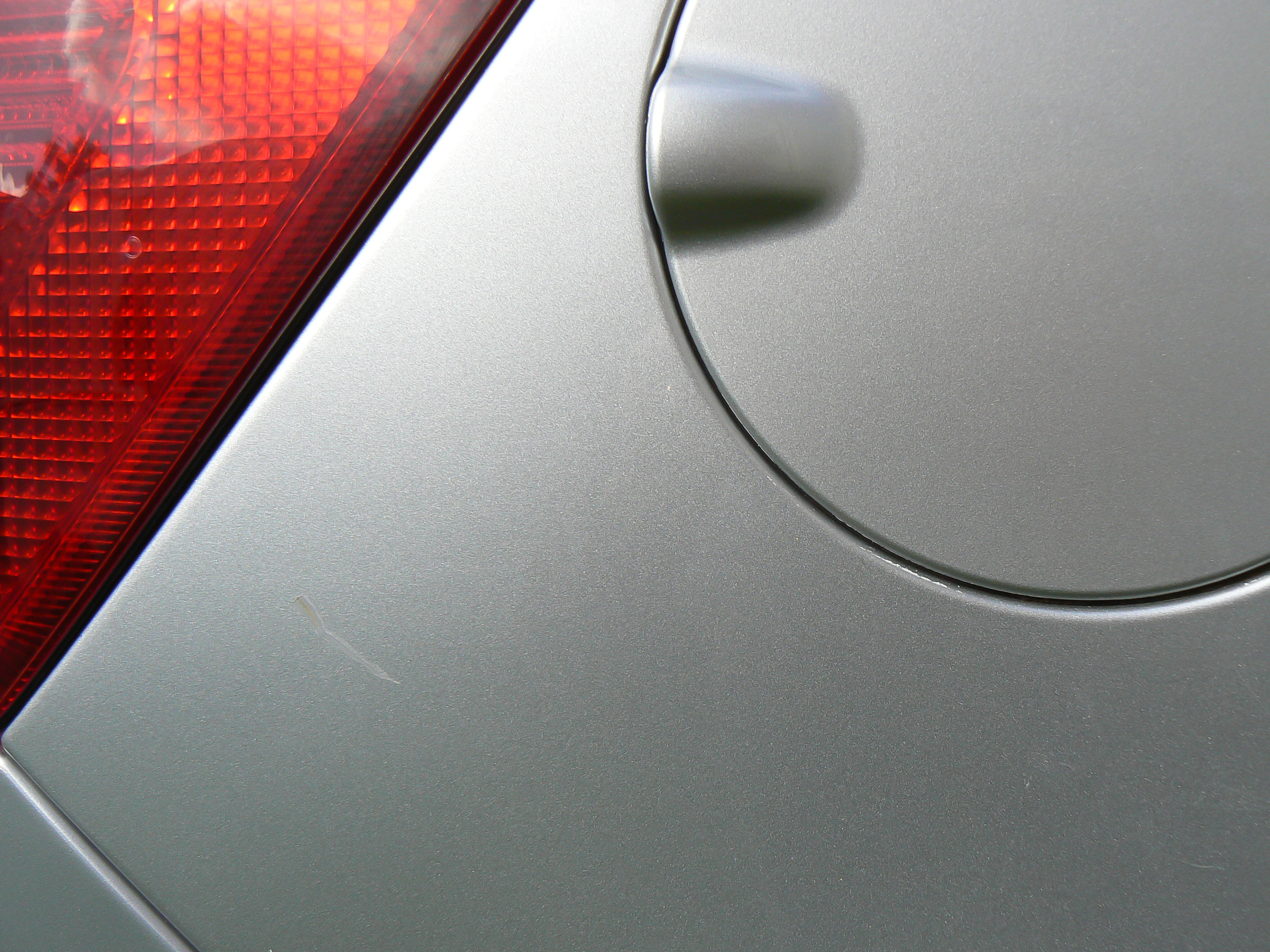

here are two photos
one showing the position relative to the filler cap and one a sort of close up
hope you can help
i know its a little b****r but i hate those nicks and knacks which grate on my mind
cheers
geof
Good photos.  Fuel fill nozzle accident?  It's not so bad, on close up, as you say it looks like it is certainly not through to metal. It is a bit hard to tell if it has broken the lacquer everywhere.  It has certainly scraped up some paint to the scratch edges. Doesn't seem to be a dent.
I'd probably try first with a quality scratch remover and see how well it comes up.  Search some detailing forums for recommended products, cleanyoucar dot co uk have a big range of products.  I have used meguiars scratch x before. It was ok, not amazing, think there may be better available.  Try to keep to the area of the scratch and not rub out a wider area.
If you are not happy with that, then you are going to have to try and smooth the edges of the scratch and in the scratch a bit with some fine wet and dry grades and then cut in, maybe with some addition of paint and clear coat, but you will probably see it.

i think i will have a go to reduce its prominence to my eye
its not a big deal i know but i am going over this second hand vehicle ... new to me to get a good shine and clean interior
there are a few little mini dings where the paint isnt broken...those can stay as they are as the car is 9 years old
