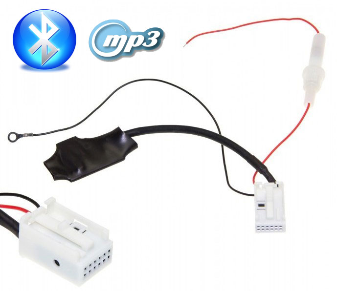

The Columbus doesn't have Bluetooth built in. You need a separate Bluetooth module fitting to the car if you don't have one already.
Not sure what use that would be. It appears to be a bluetooth unit for streaming music somehow, but how effective it would be I don't know. Certainly you'll have to use the phone for all control of the music, which will gain you some points and a fine when the Police catch you.
If you want Bluetooth streaming and handsfree phone functionality then something like this would be good. It's the factory fit kit for that purpose.
If you just want to use your phone for music then this would be a good solution. Again, factory fit and goes into the armrest (if you have one fitted). If you don't have an armrest then the same kit can fit inside the glovebox, either remove the actual MDI unit from the armrest kit and mount that, or buy a bare MDI kit like this.
Those are just 2 or 3 examples of what you can use. You'll probably find them cheaper if you look.

Make sure you get one which has the correct cables included. There's the wiring loom adapter with quadlock connectors on either end (rather than the bare wiring one which needs cutting and soldering), then there's the short adapter cables at the other end which clip into the MDI and connect your device. There's a USB, an iphone early, and an iphone lightning, so you'll need the correct one for your phone. Not sure if there's a USB C type yet.

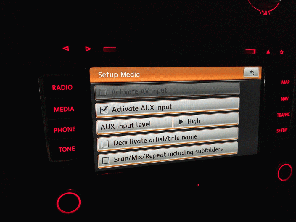

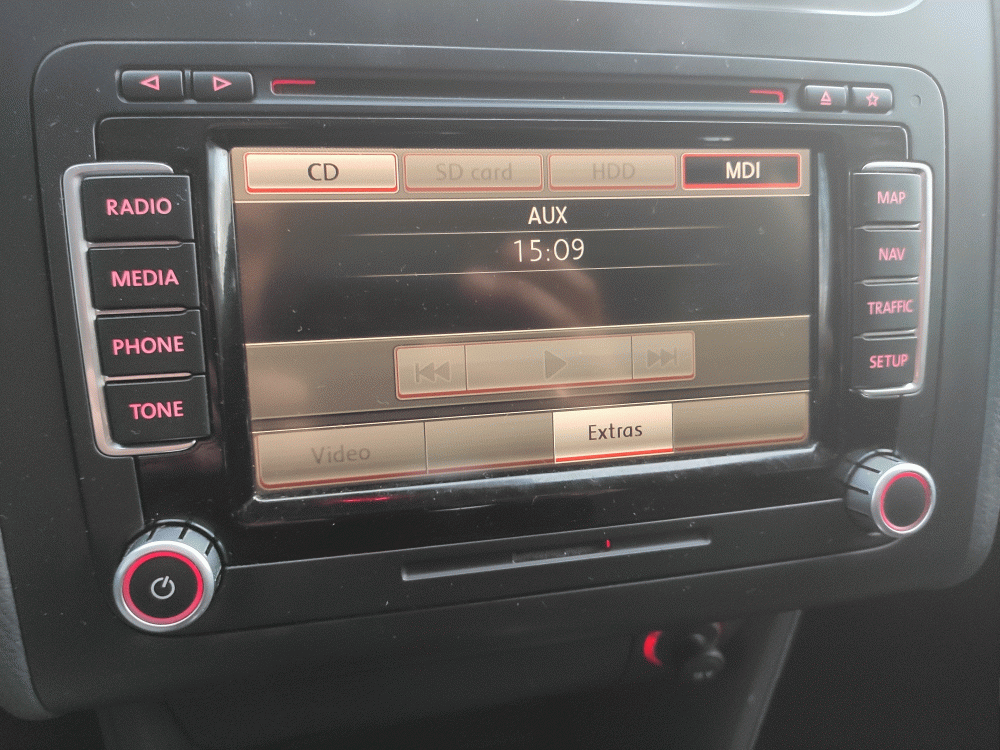

I have problem with my Touran 2011 RNS 510 BT audio streaming.
It does not shows as that kind of option at all.
I can connect my phone, calling, recive calls, but cannot find how to enable BT audio on.
Some pics of my unit.
Thanks!
