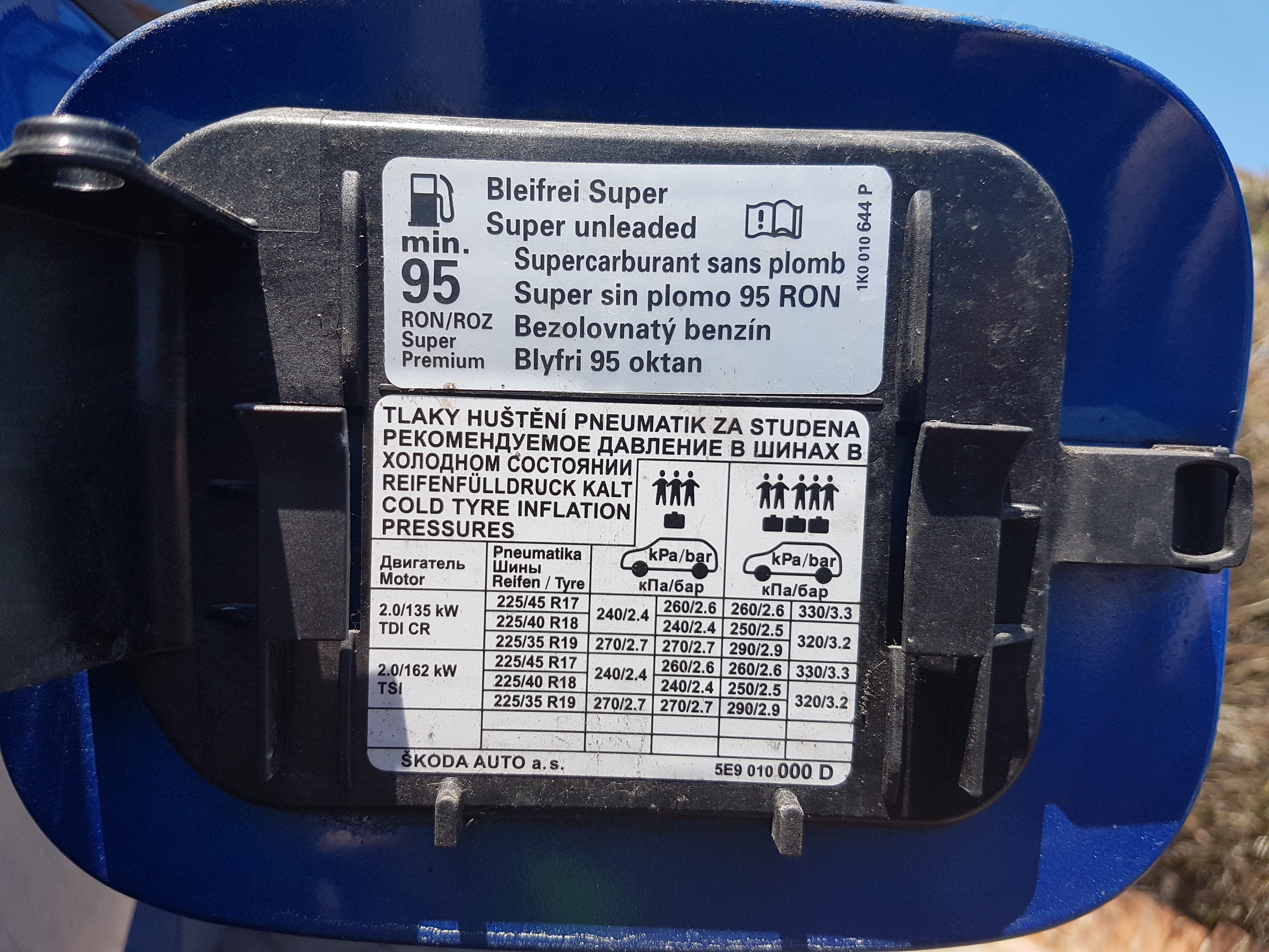

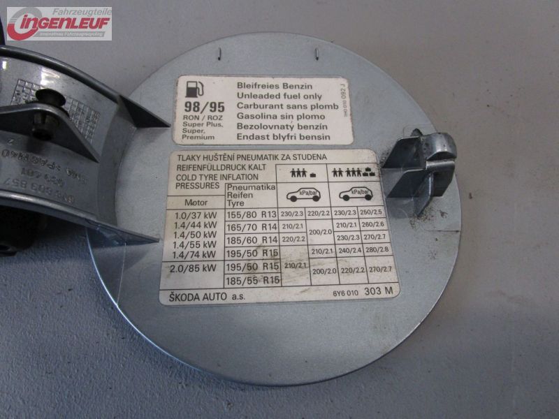

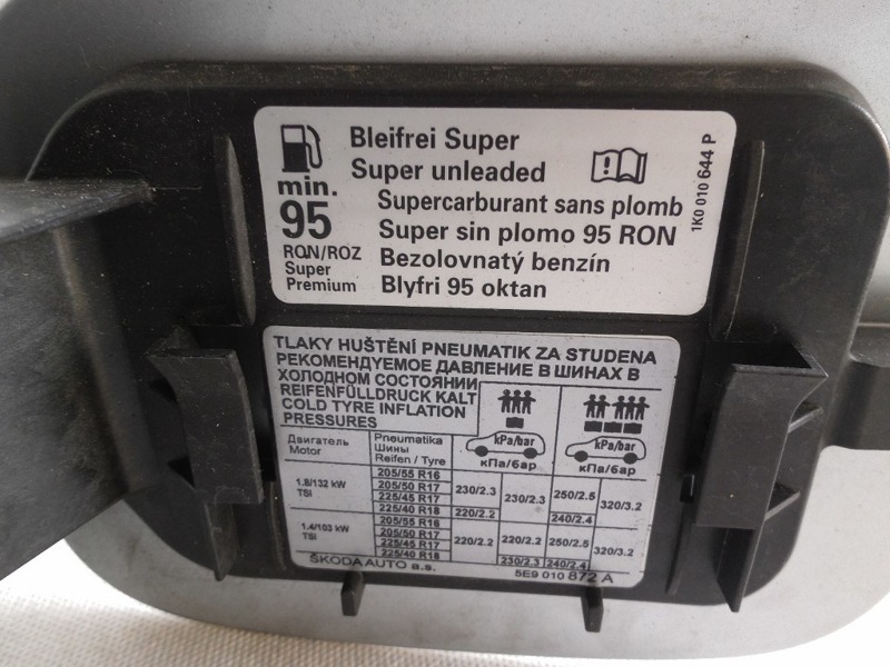

http://volkswagen.co.uk/need-help/owners/Fuel
What does your VW Group Vehicle show on the Fuel Flap?
Edited by Awayoffski
My label is not identical to any of those.
The third one down, mostly. But the ECO tyre pressures are slightly lower at 2.5bar front, and definitely min 95 RON as I've said before.
My VRS says Min 95 RON. Many countries sell fuels with significantly lower RON, but for the UK and most of the EU 95 RON is the minimun you will find available.
Remember that all fuel sold as 95 RON will be a minimun of 95 RON, and may actually be closer to 96. 97 etc. Likewise minimun 99 RON could be higher still.
Adding octane booster may reduce performance, as most otcane enrichers are derived from ethonal which will dilute the energy content for the given volume of fuel. It is similar to adding salt to water to increase the boiling point. Unfortunately it is hard to tell which brands use higher base quality fuel within their Super-derivatives, and which mix additives to artificially increase the octane level. Hence, somtimes random 95 RON will perform better than random Super within the same engine. Ethonal-enhanced RON can also negatively impact fuel economy bacuse you need more volume to release the same energy.
