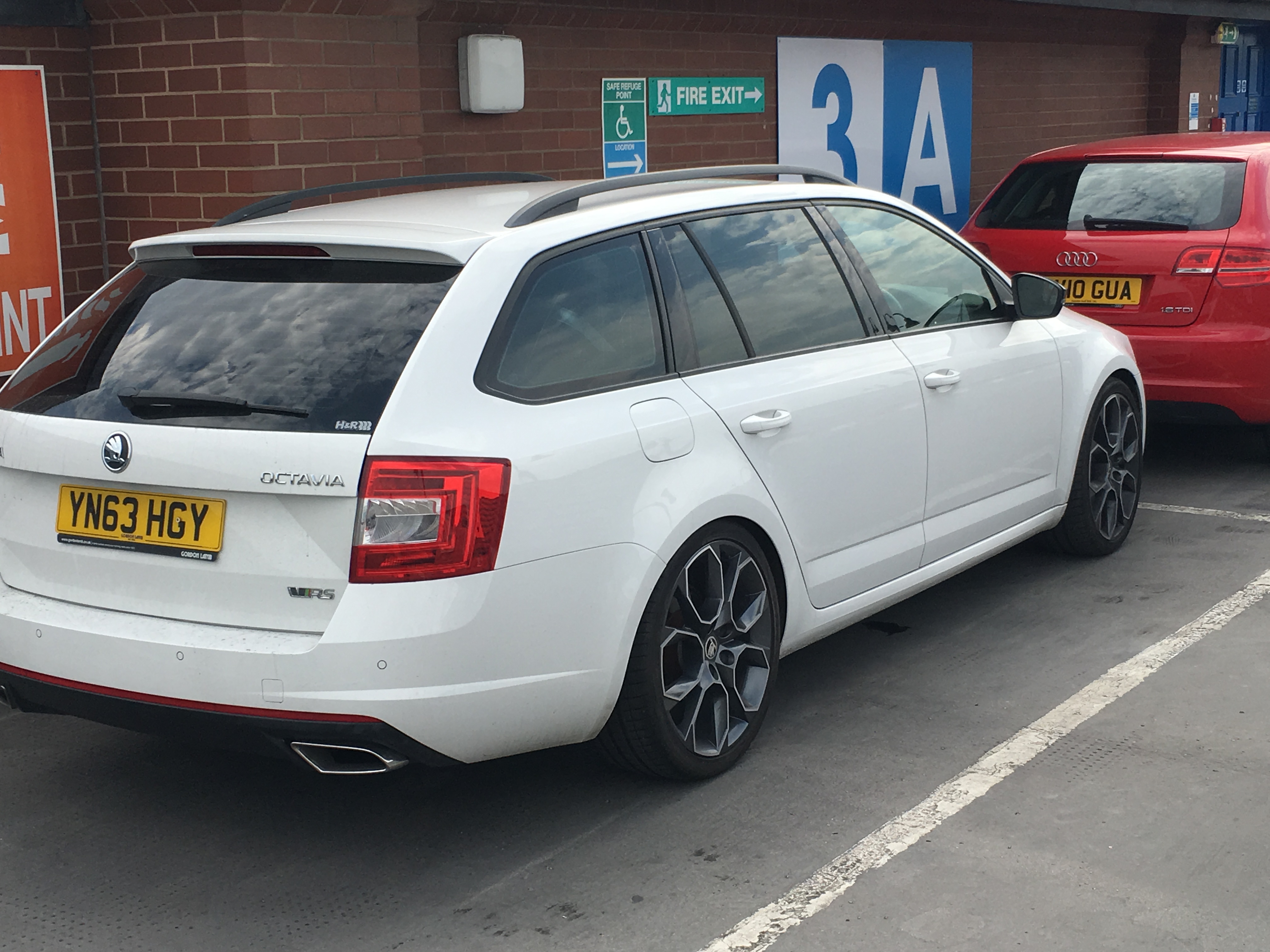

Hi guys. I have found some wheels that I like the look of. Not to sure if the width and offset would work.
Ive got a VRS estate with 18s as standard.
