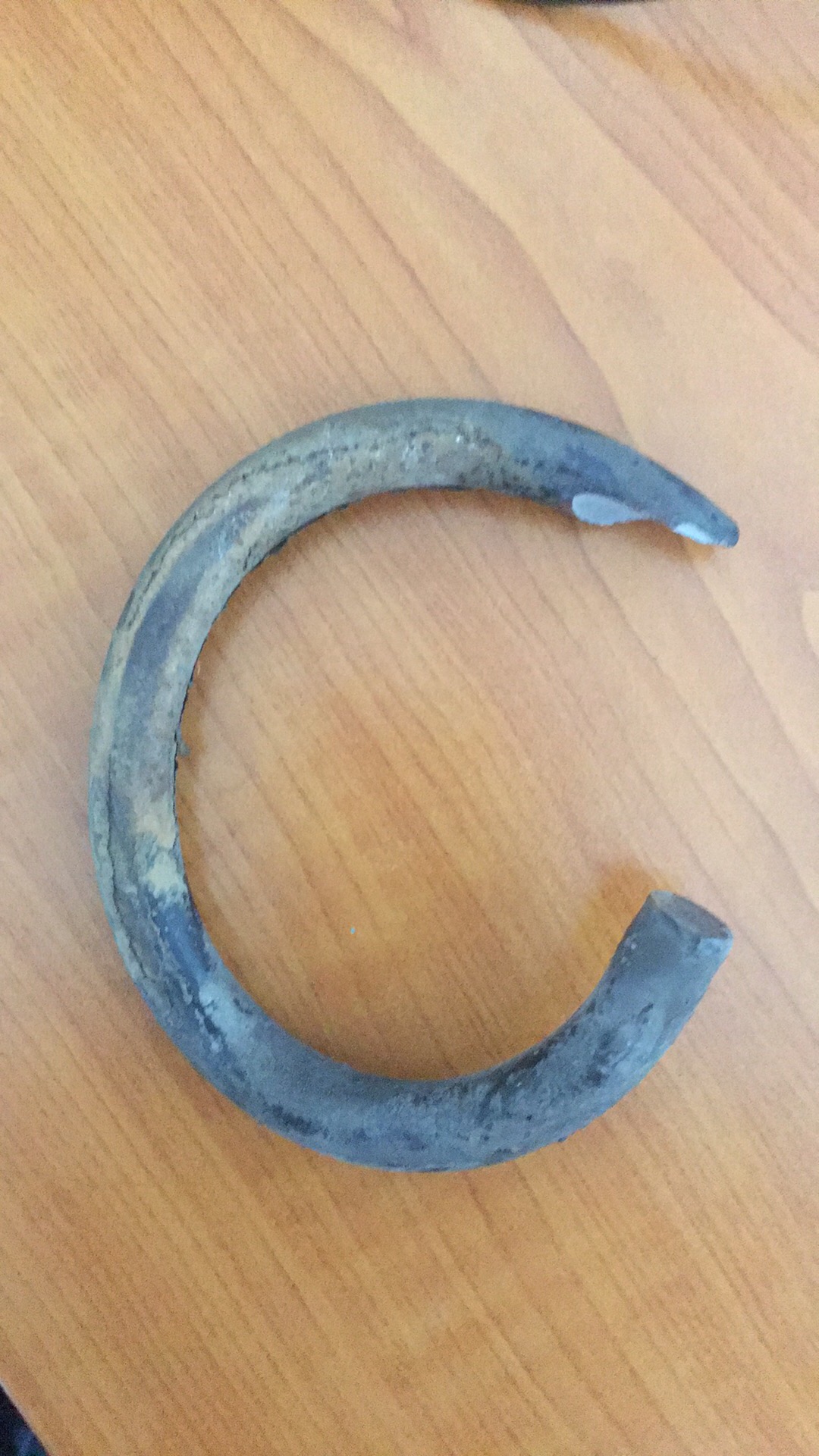

Damned front spring broke - easy or hard?
So had a rattle like a bunch of keys this evening, only to get to my hotel and find my front offside spring has busted.
Is this a mega nightmare to change both front springs?

Not the worst of jobs to DIY but you will require some beefy tools and a spring compressor.
Plan on a lazy couple of hours per side and expect collateral damage when seized/rusted fasteners require grinding off and new parts fitted.

You should be ok as long as the broken spring doesn't force its way past the cup to the tyre!  Not a great situation.  I couldn't imagine a dealer or independentnt charging much more than 2.5 hours for both sides so it depends on their labour rate, anything from 60 to 140 plus vat depending on which way you go. PLus, as pointed out, you may require some ancillaries when doing the job.
well thankfully it broke and stayed in the cup. and it also broke on the inboard side not wheel side
