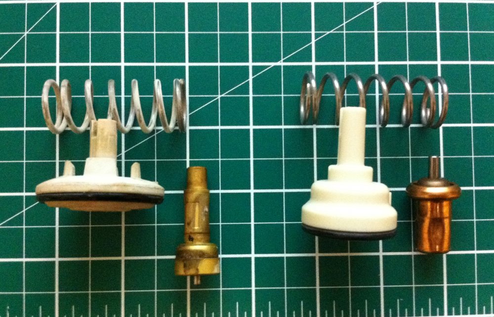

Hi all...I have a 2008 Fabia 1.2 and I'm in the process of replacing the thermostat. Does anyone know if Skoda revised the design of the thermostat?, as the one I've purchased from my local Skoda garage looks completely different. The thermostat on the left is the original I've removed from the car and the one on the right is the replacement. The part I've been supplied is no 03C-121-110-AA.

As far as I can see from this page, the right part number for your car is 03C121110A (item 24), and google image results for that number resemble your original rather than what you've been sold.

Cheers Wino, I'll take the part back with the original and see what they have to say.
