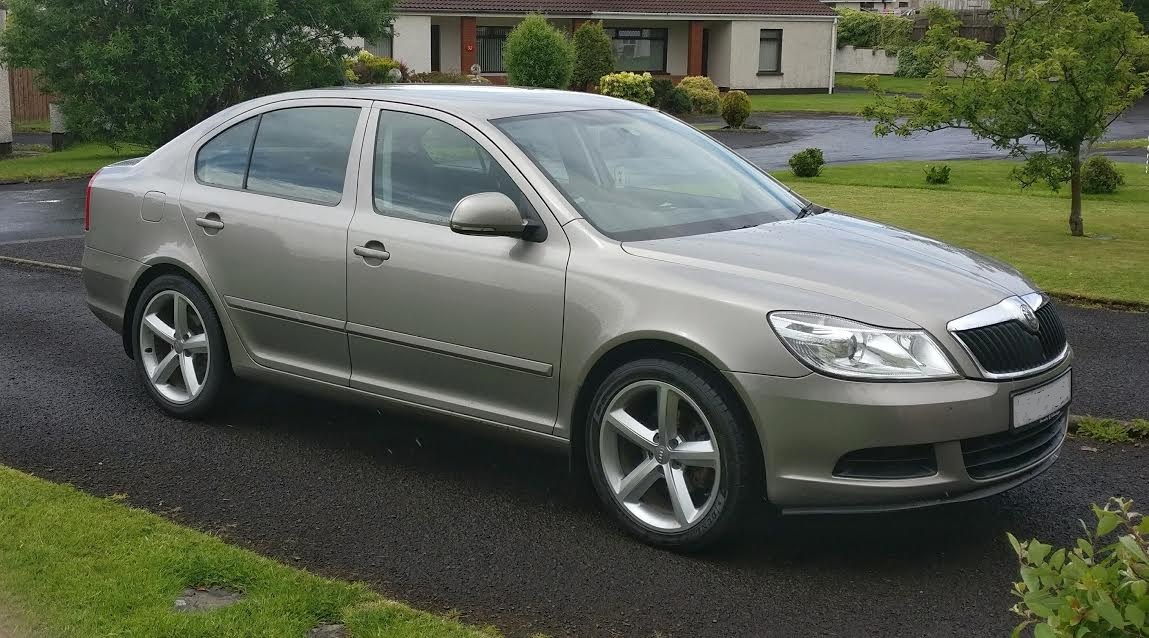

Thanks for the replies folks. I sourced a set of ET47 18" S-Line wheels with good tyres for decent money and am very happy with them.
The rather large 245/40 tyres really fill the arches! But no rubbing so all good :)
