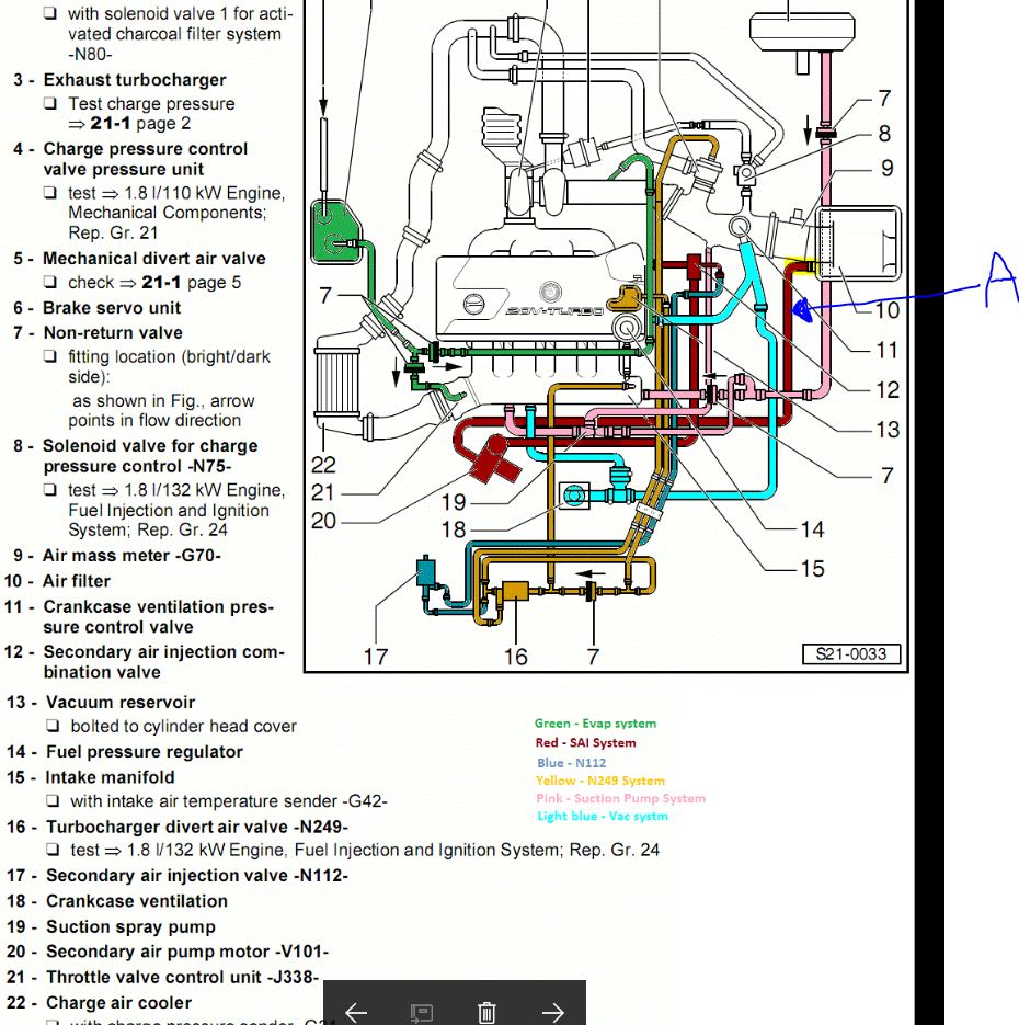

I've just been browsing some of the threads on here as you do, and came across the piping layout for the engine....my car doesn't have the red pipe I've labelled as "A".... it has a blanking plate on the air box?? It was like this when I bought it, can this pipe be taken off??
I need to check nothing else has been removed

@Tomlin8 - On the basis that the red pipe connects to 20, the secondary air pump, then yes it can be removed, in fact it's a fairly common modification and doesn't normally cause any problems. Quite the reverse; it's normally done to cure noisy cold running!
