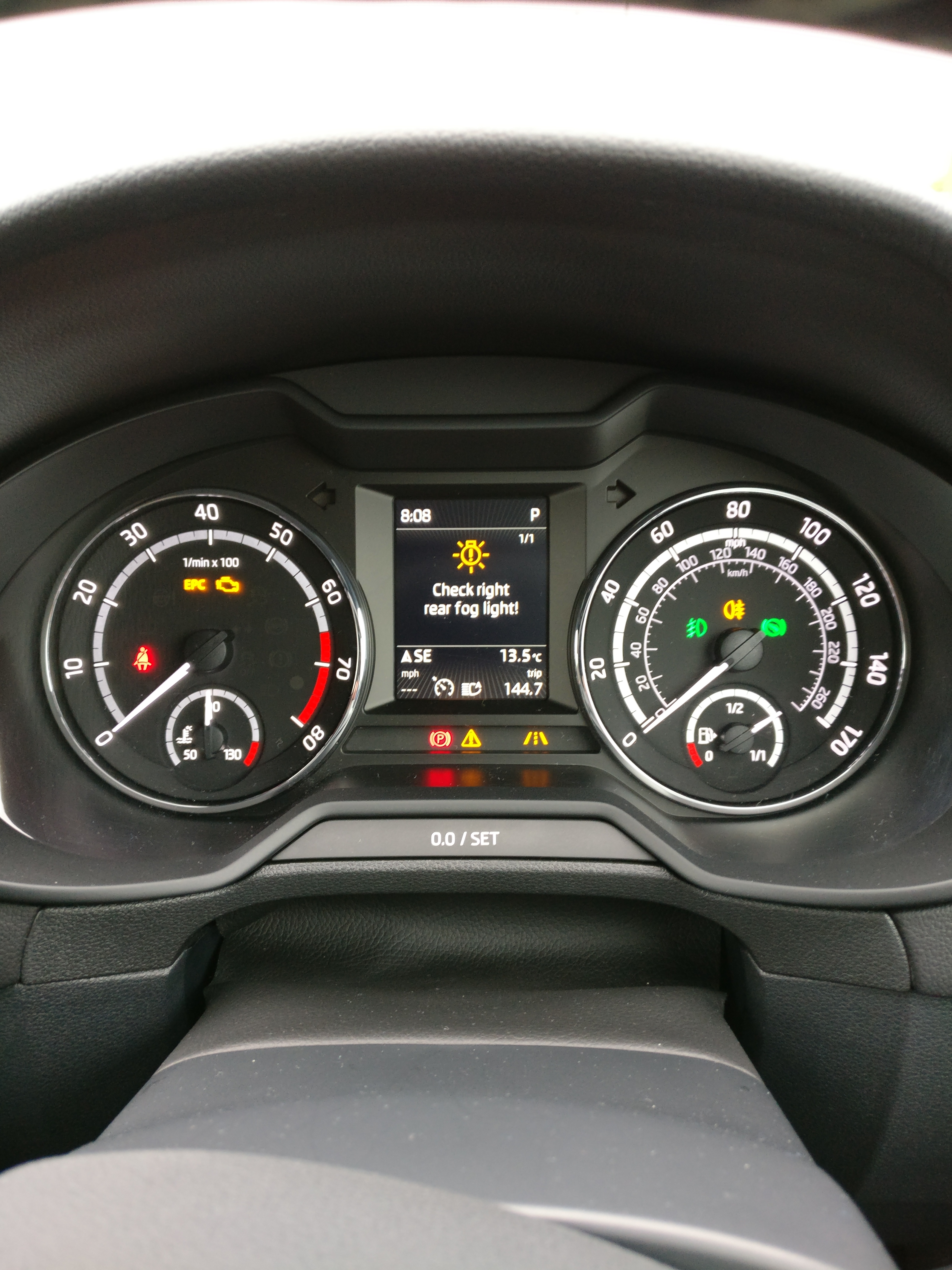

Hi guys, did a search on a few different variations of the term "rear fog bulb" and can't seem to find the answer. Was greeted by a bulb out error this morning for my right rear fog. Does anyone know what the correct bulb type is? I have the rear led units if that makes a difference (though the fog bulb is halogen I believe).

Think I've found the answer according to an online version of ETKA; comes back as a H21W 12V 21W.
Yep, that's correct if you have the LED rear clusters.
