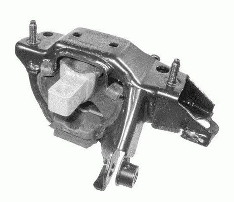

8 minutes ago, Bertie90 said:
Identical to you, noise, movement etc!! i replaced the lower mount as well and didn't do much. so it's the top engine mount/s?  can't seem to find the original ones on ebay. I'm worried i'll order the wrong part.
I ordered mine from a dealer, they can look up the right part for you (and the bolts) - although if you want to save a little money I believe the OEM mount is made by Lemforder, who sell a little cheaper though ECP. The dealers will definitely be able to order you the right part though.
I've not don't the right (oil filled) engine mount yet, but just the gearbox mount was a fair improvement.
is it similar to this by any chance?
Looks very similar!
1 minute ago, pixelated said:
Looks very similar!
Cheers, i found the correct one on ebay. Did you had to take much stuff apart to get to it?
Not today bad. Battery out, battery box out, air box out (or moved out of the way).
Hold the gearbox up with a jack (with a bit of wood between the jack and gearbox).
Undo two 16mm bolts mount to gearbox.
Either use your 16mm spanner or drop the engine down a bit to fit a ratchet and undo two sideways bolts to car.
Undo top top bolt to car, switch mount.
Body bolts can can be reused. 40nm + 90 degrees.
Engine bolts replaced. 60nm + 90 degrees.
