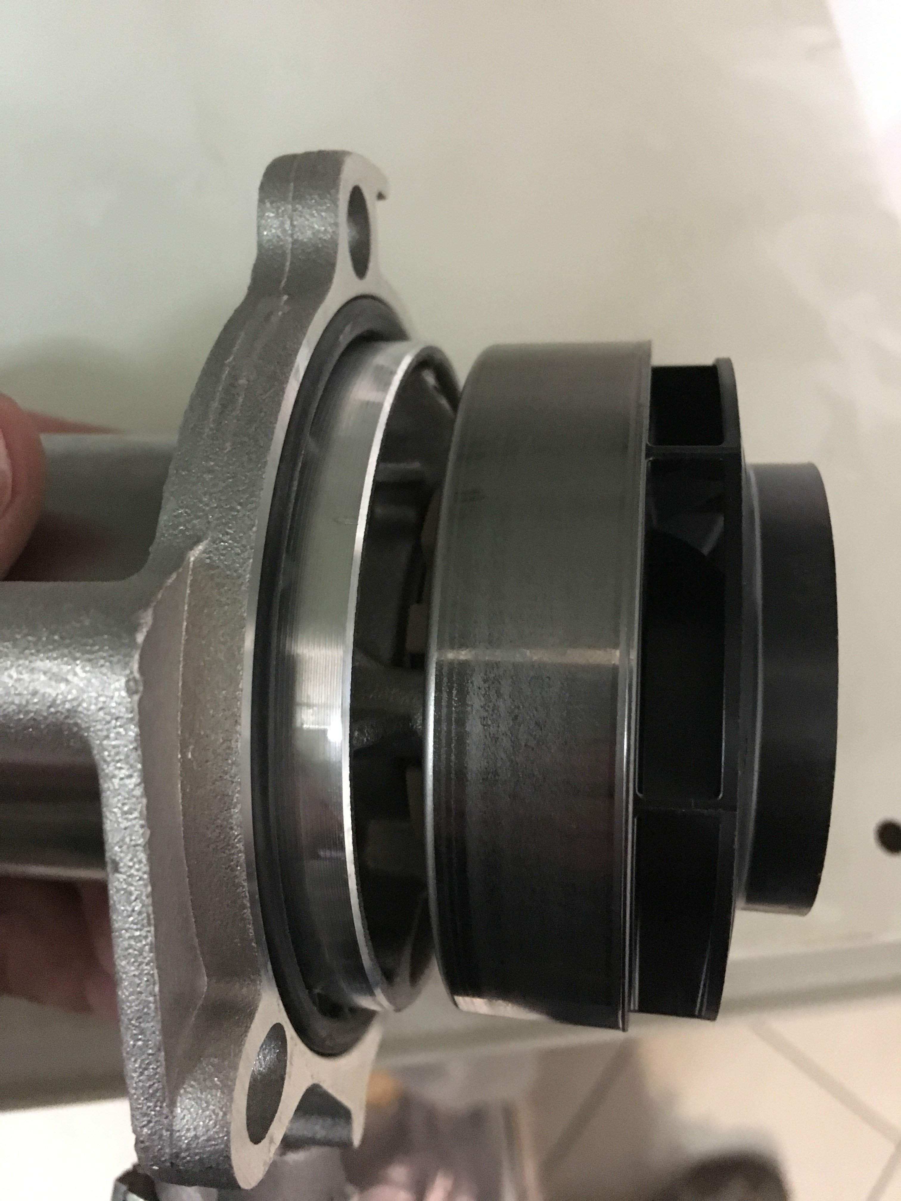

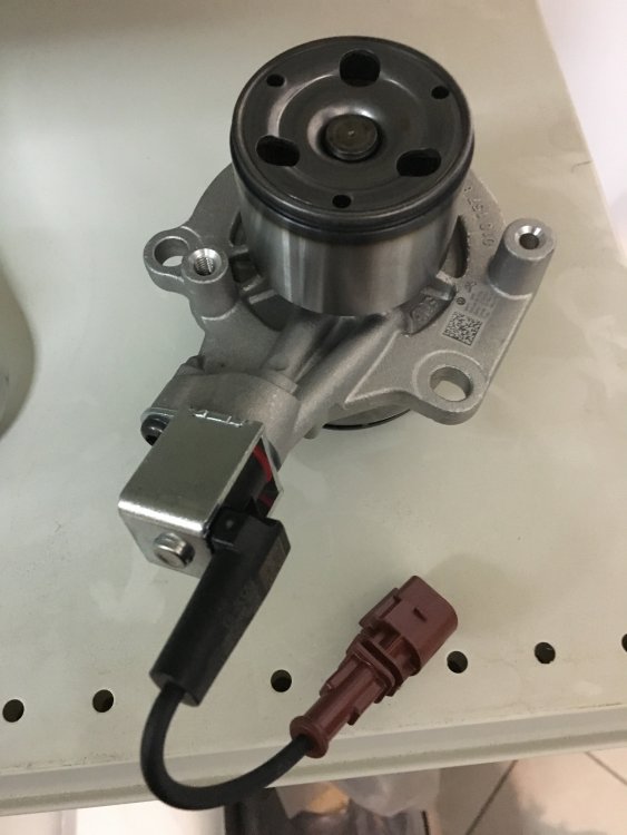

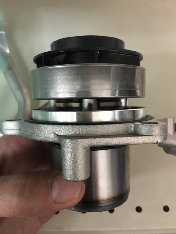

Water pump
Water pump literally just had mine replaced

Best to check with the dealer for sure but I believe the new pump has a metal sleeve instead of a plastic one which causes the early failure..
Same as old one
