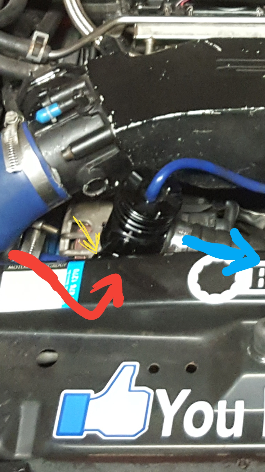

So finally got my 2003 VRS running well and all standard. Unfortunately the better half likes the woosh of a dump valve. I threw the nasty atmospheric one in the bin when I first bought the car. I know the standard recirc is the best for stock, but the boss thinks otherwise. Bought a split one to satisfy the ecu and the misses.
Instructions that came with it suggest to fit the boost pressure pipe to the bottom of the piston outlet and the side of the piston outlet into the intake pipe. Is this correct? Boost pressure acting on the piston?
Please lets not get into a discussion which type is better, I already know, but I just want a quiet life. Happy Wife, Happy Life..
So Correct way
And Wrong way ?
Red arrow is from boost pipe post-turbo, blue arrow is going back pre-turbo to the 'hockey puck' and yellow arrow is pointing to the funnel vent. I have a forge splitter. No fault codes yet (: and many whoosh whoosh sounds!
