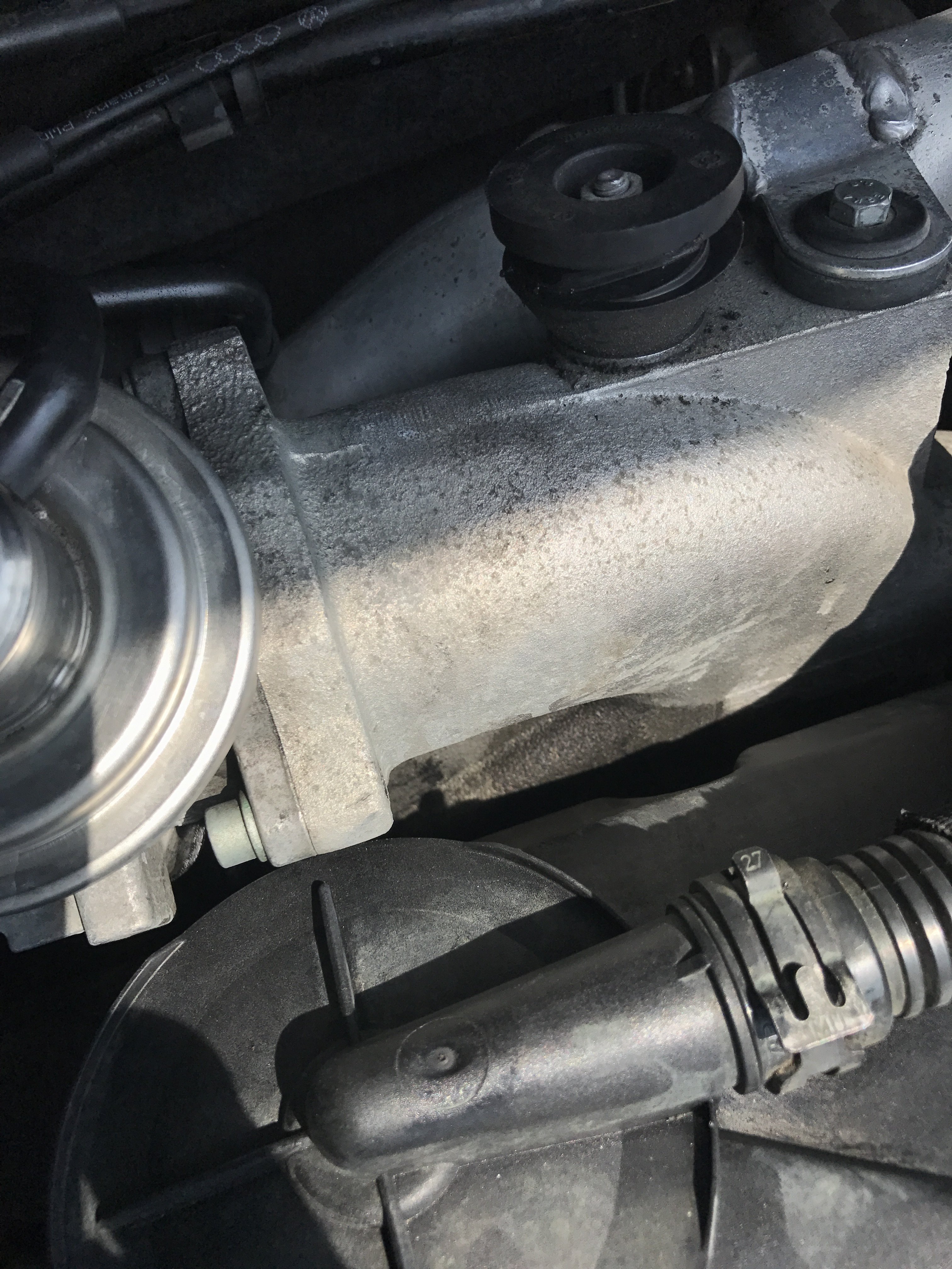

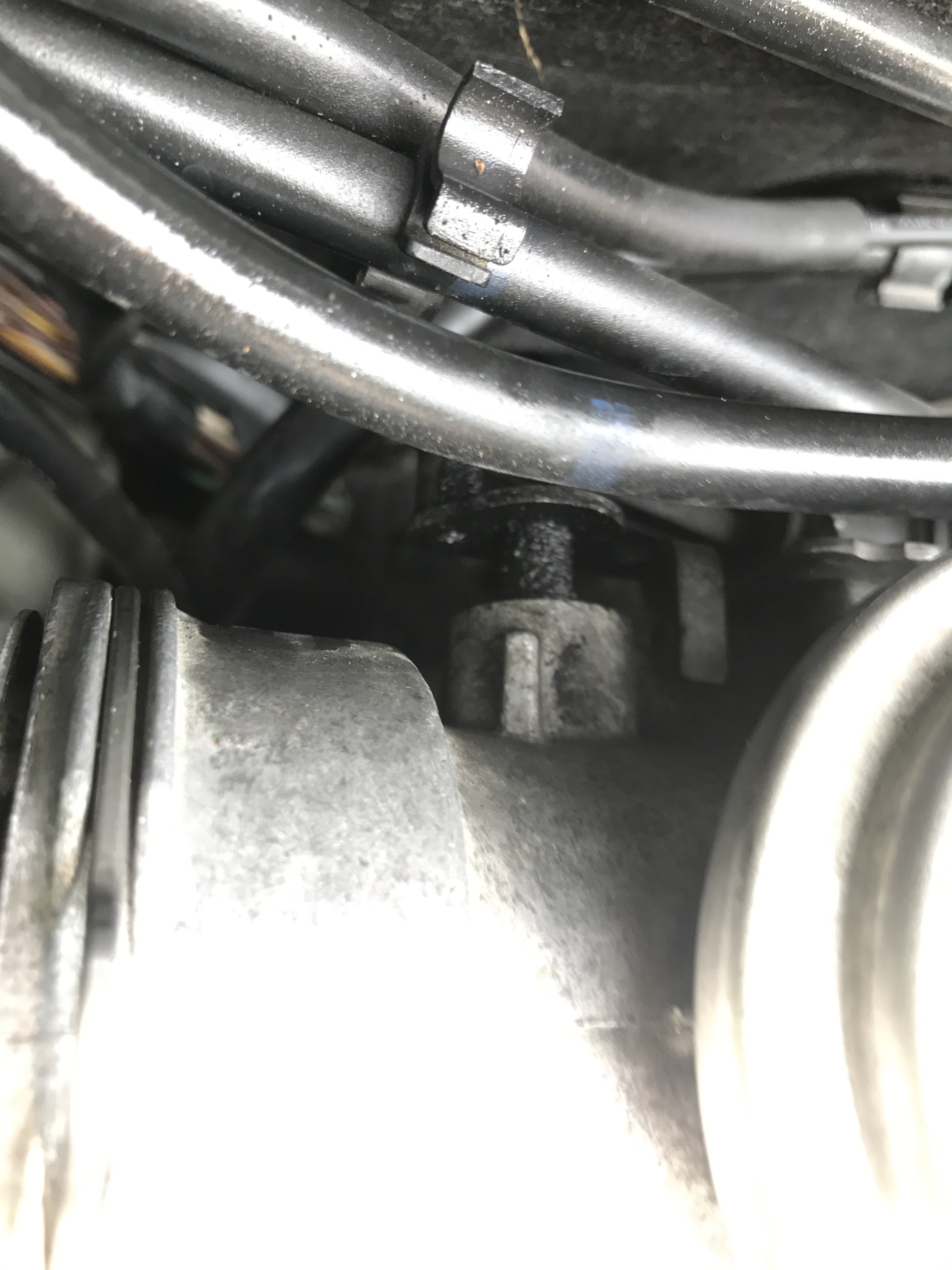

Also the EGR valve join seems to be a little oily. I will add a photo imagine could benefit from clean or delete?

I did clean the area to see the extent of the leak with degreaser however on the inlet you can see some of the residue and also on other parts of the EGR. The join where the hex bolts are was where the soiling was

Egr weeping is normal to an extent,  I got rid of mine. If turbo oil seals weeping then it would see more oil. Would make sense of your whistling turbo if its over loud.
