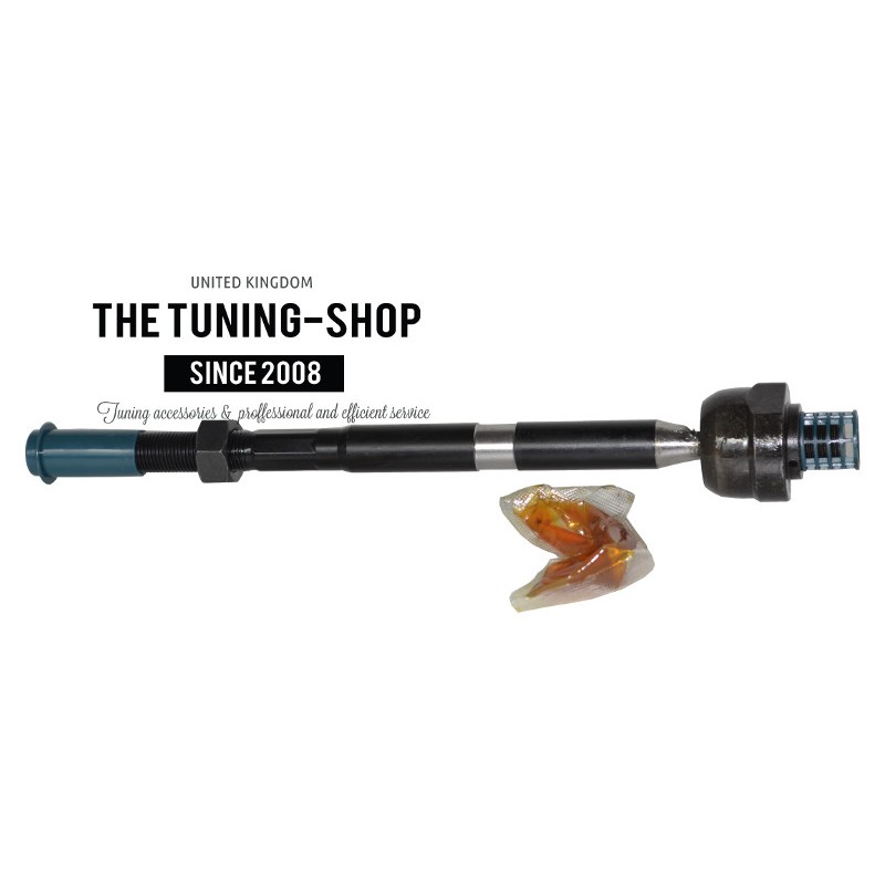

Are you sure it's not just the inner tie rod that's worn,quite common
Thanks for the reply @gizmo98 - when you say inner rod do you mean steering arm that screws onto the rack with the trackrod end on the other end?
Yes had both replaced with OEM arms and track rod ends  and balljoints
Edited by nidgep
Yep these,quite common for them to have play in them ...
Really?
I could understand cars of a certain age/mileage having some play.
So even new OEM steering arms have play in the joints at the steering rack end?
I took my car to the local VW main dealer after the Skoda dealer fitted the new arms etc.
The mechanic put the car up in the air and showed me the play by pulling at the top/rear of the front NS wheel.
I took the car to a local respected VAG independent garage who said the same - that it was the rack. They said that they had seen the exact same problem (thumping noise over various types of bumps) in BMW's where it was the rack at fault.
I'm not sure what else I can replace/test to disprove that it's the steering rack that has play.
Car has done 148K.
Edited by nidgep
Additional info
No I didn't mean there should be play in them,just saw that you've already replaced yours with new ones so probably is the rack that's faulty
