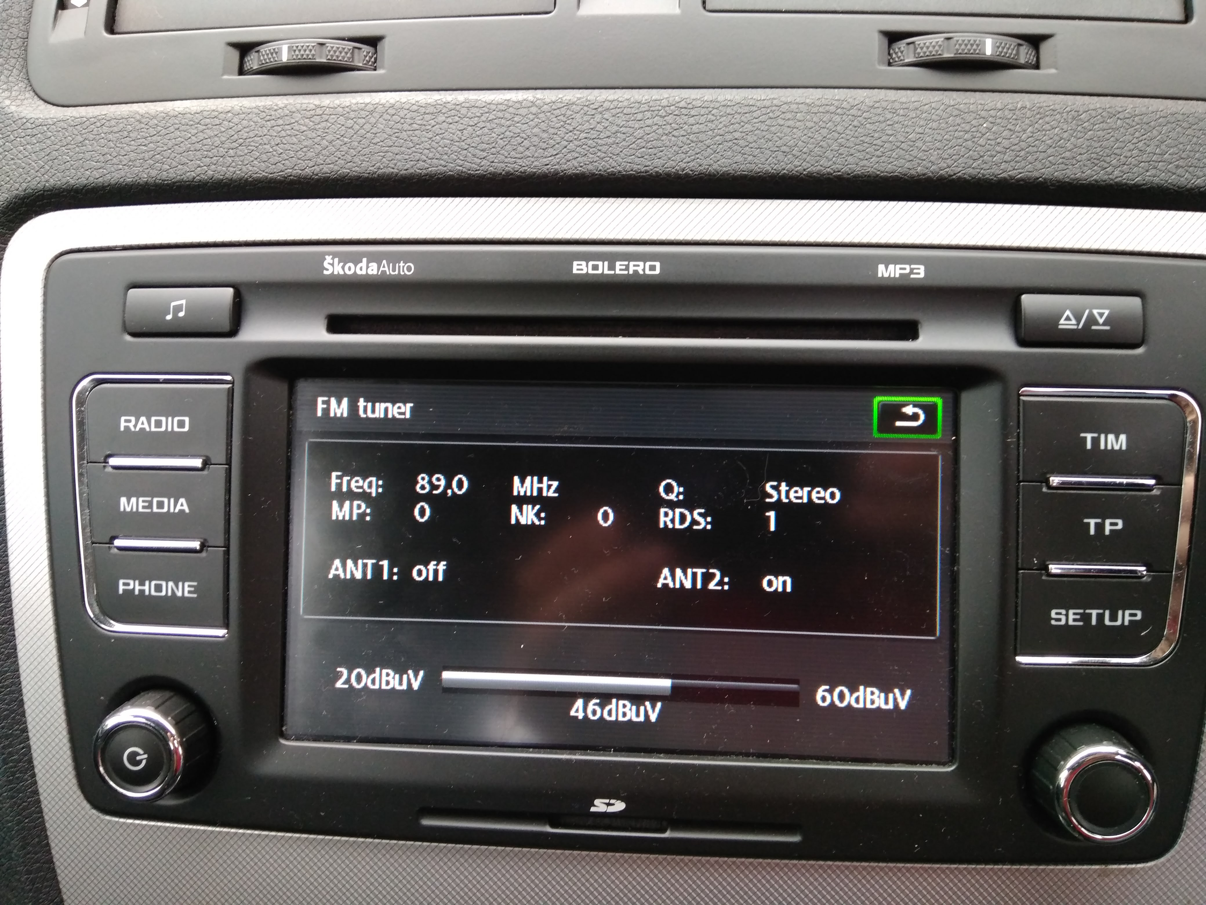

I've recently bought a MkII Octavia estate and (other than an AC issue - which I've posted about in another thread), most things are going well... however, the radio seems to have a terrible problem picking up any station well.  It's a Bolero and having followed the method for the secret radio menu online, I found that ANT1 is reporting itself as "OFF".  I worked out that ANT1 is the one on the roof as ANT2 which is reporting as "ON" goes "OFF" when I disconnect the rear window antenna from the cable where it's connected in the rear door pillar (C pillar?).  So, I'm guessing that OFF on ANT1 means it's disconnected but I've removed the radio and it's clearly connected there!  There appears to be no snagging or squishing of the cables as far as I can see in the dashboard before it gets tied into a bit of loom, so my question is, where is the most likely place that this "break" has happened (I'm presuming it's a physically cable broken or damaged somewhere) and what's my best course of action to rectify the problem as it's awful trying to listen to radio when it spends its whole time dropping out!
Thanks in advance for thoughts / replies!
Neil
PS - pic of the screen showing what I see.

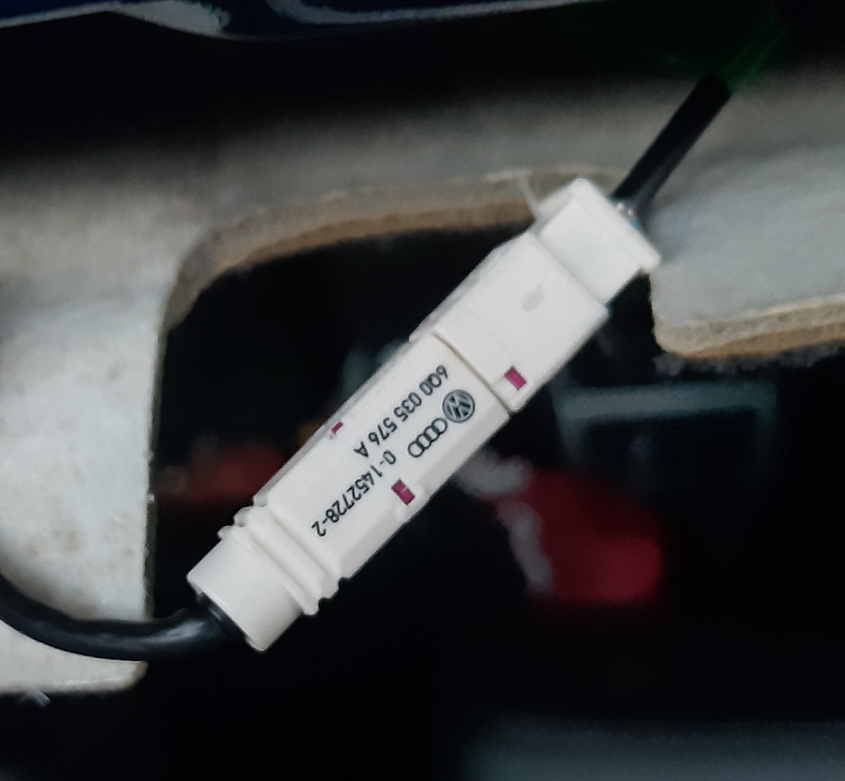

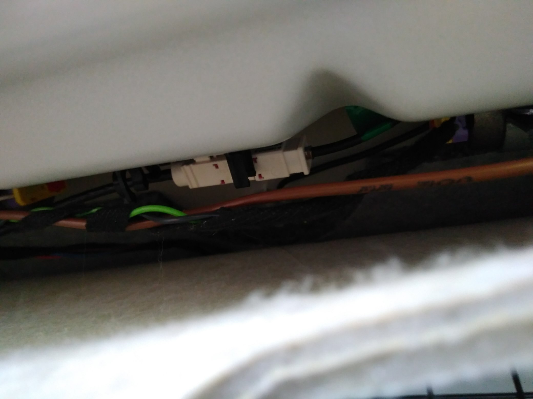

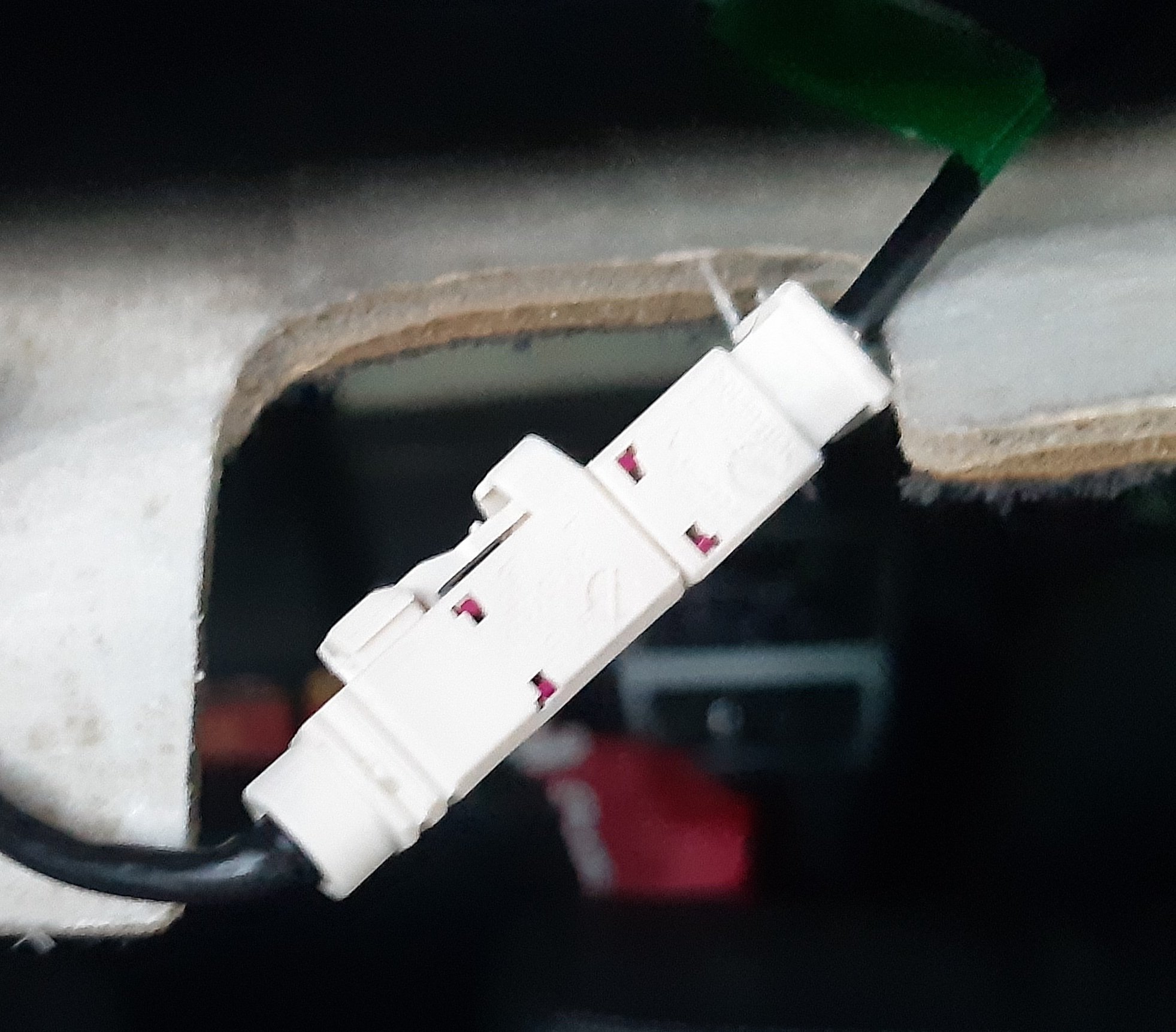

Since you had both said I was going to have to replace the aerial base, I thought I'd see how easy it was to get at, so I popped out the middle section of the plastic around the boot to make get to the edge of the ceiling panel, and then slid my hand up inside the roof lining carefully to have a bit of a feel around.  I left the radio turned on at the time on the off chance that perhaps I'd wiggle something and it would work better, and would you believe it, I found the little plug/socket that's clipped up onto the metal roof wasn't tight, so I carefully pulled it apart, and re-joined it again, and the radio immediately got a lot better!  I went to have a look at the diagnostics screen and now it says both ANT1 and ANT2 are on!  Brilliant!  Maybe I've just got lucky and it'll stop again on the next pothole or perhaps it is oxidised somewhere and it's just working at the moment, but it is pretty coincidental that it started working just as I pushed the plug back in!  Here's a photo of the bit I'm talking about in case it's useful!
So thanks again for the pointer - I would have started at the radio end and worked towards the antenna if you'd not said, and that would have been a long job!

Yes, exactly that, with the radio on, press and hold setup button for a few secs, then a settings menu appears, then press FM and it gives you the screen shown in my first post.

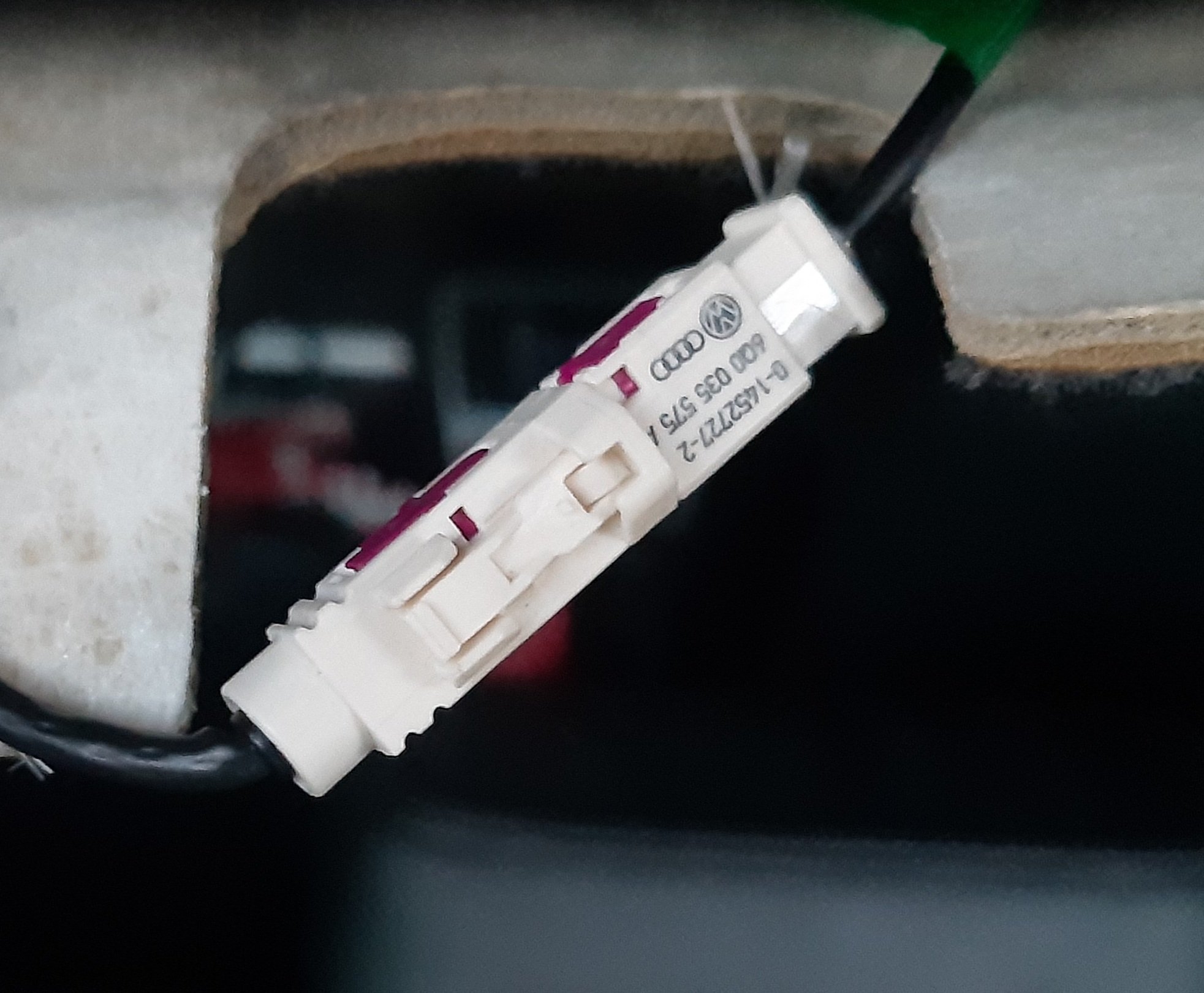

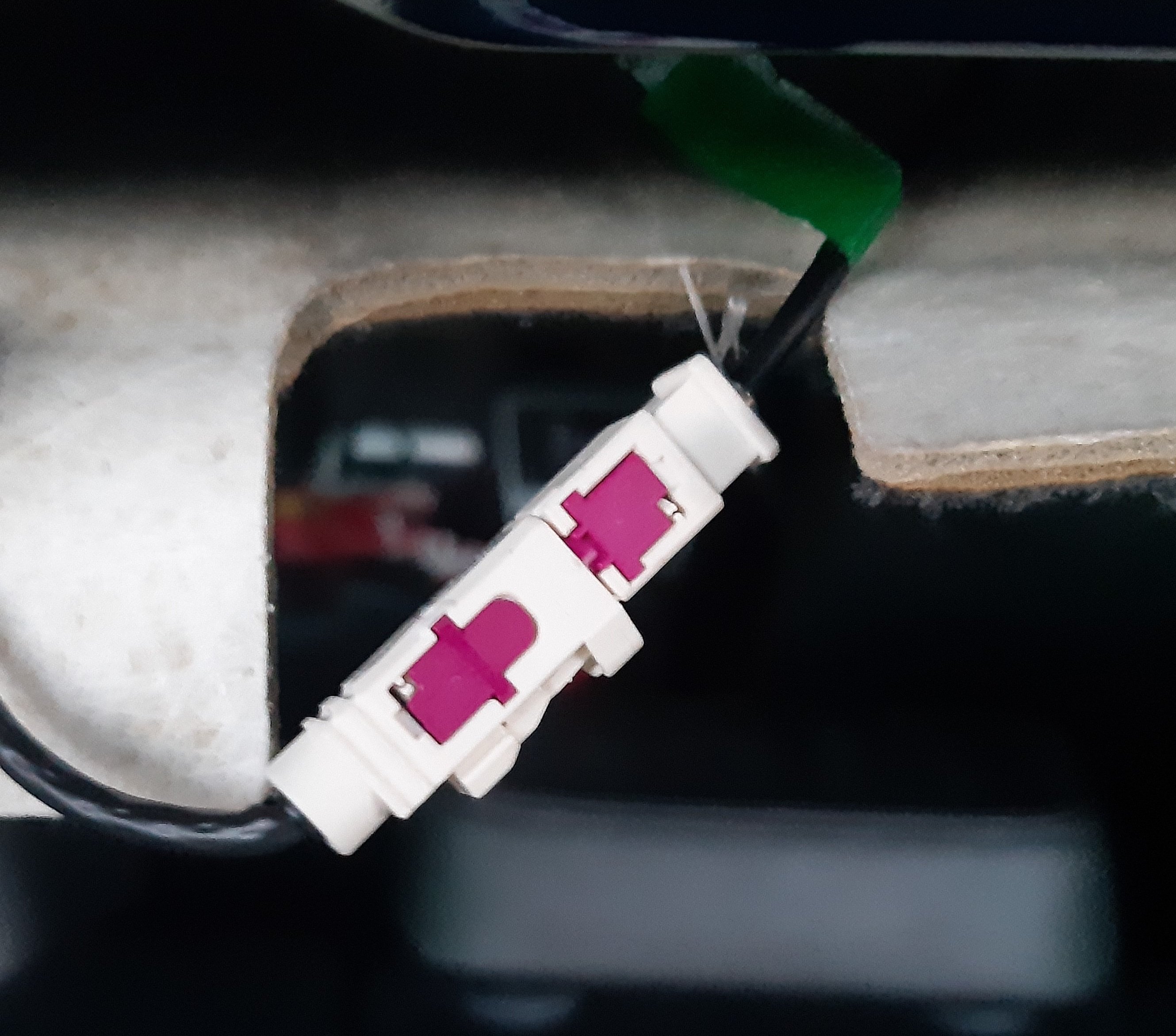

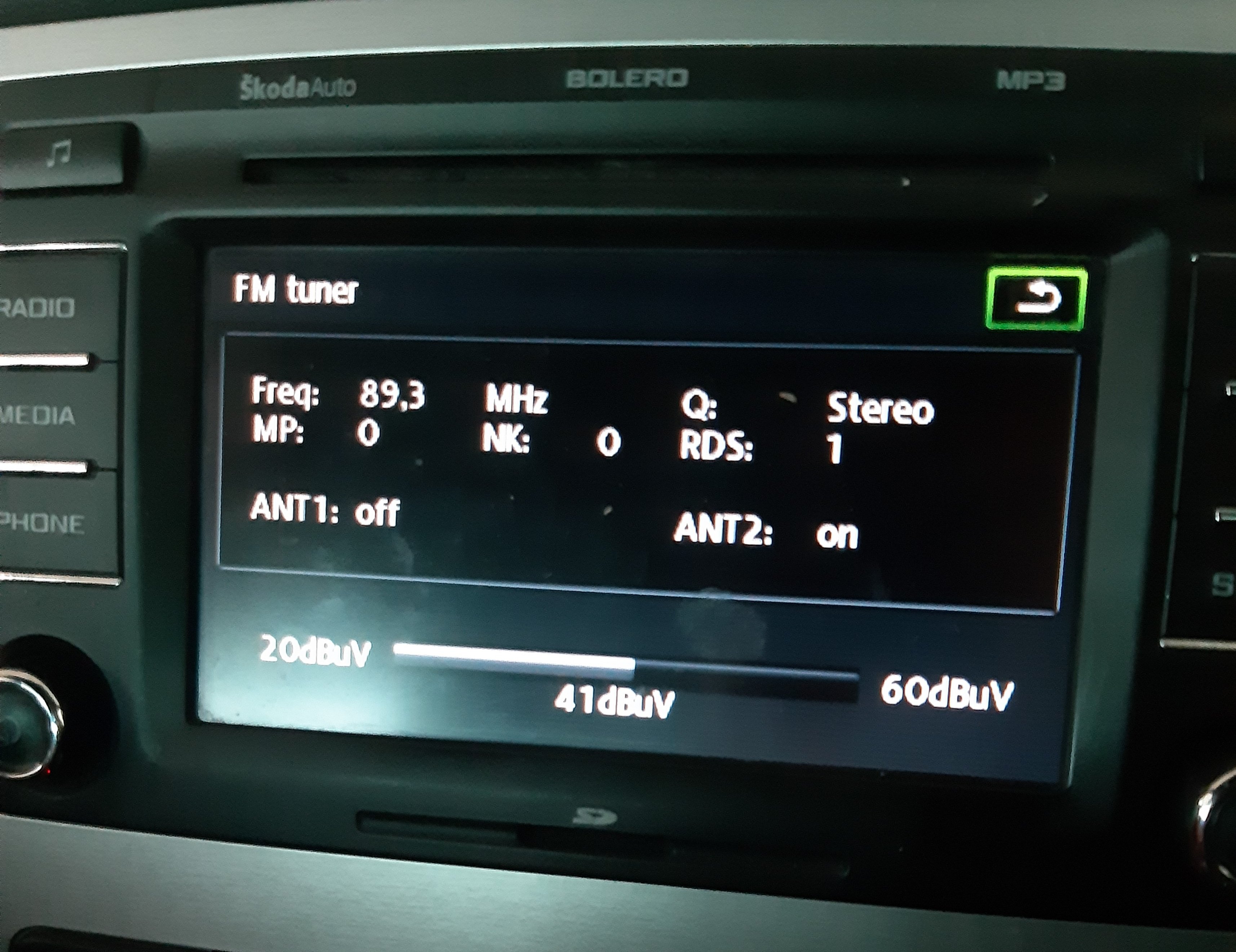

I have exactly the same issue as you described. I hope my solution is as easy as yours but I cannot figure out how to separate the connector (even when operating the little arm either way). The connector seems to spin around without any force. I don't have much room and don't want to damage it. How to separate this connector?
