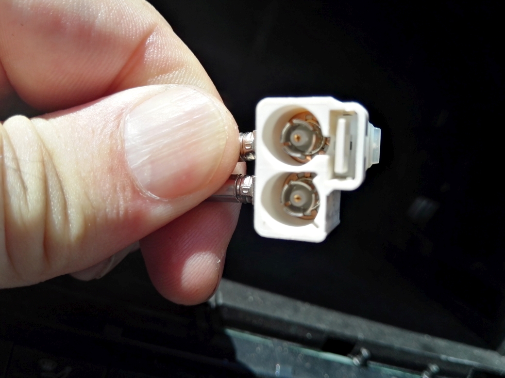

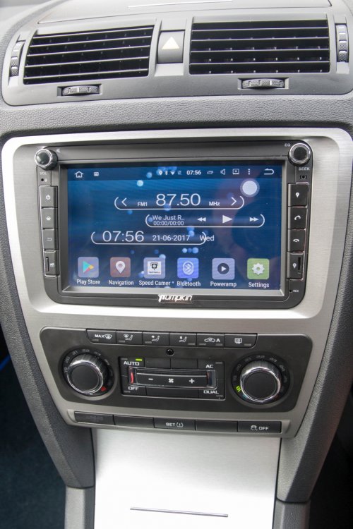

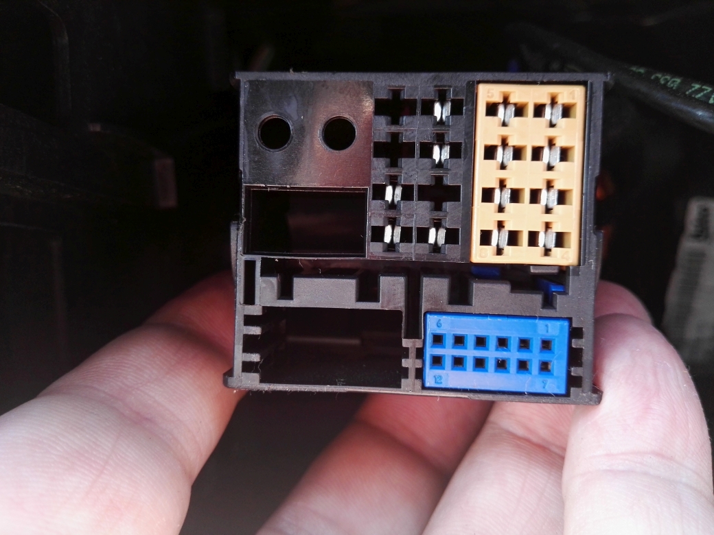

One of the reasons I bought this particular model was because it claims to be completely compatible with the existing wiring in my 2010 (Facelift version) Skoda Octavia VRS and I’m pleased to say it was a perfect match (see the wiring photos). I could have had the radio installed in less than ½ an hour including removing the old one and it only took longer due to the fiddly part of finding a suitable spot for the external mic. The neat GPS module slid easily into a space below the top storage area and was kept there with some double-sided tape, it gives a very good GPS signal.
Please note that I have not installed a reversing camera (yet) and my car doesn’t have steering wheel controls.
Also remember that a new surround is needed which cost less than £20 from a certain auction site. The finish on the Chinese surround is grey-silver rather than VRS silver but it looks OK. It also doesn’t fit exactly right around the a/c controls (it stands proud rather than flush). It’s £20 rather than £90 or whatever from Skoda though! I need to check I have all the clips in properly before I go thinking about splashing more cash.
Perhaps also of note is that once the key is removed the unit powers down automatically after about 10 minutes (although I haven’t timed it). Unlike the Bolero, the key has to be inserted and turned (ACC setting?) before the Pumpkin can be powered up.
Pros: Build quality seems excellent with no loose buttons and the appearance is great. Installation was a doddle,

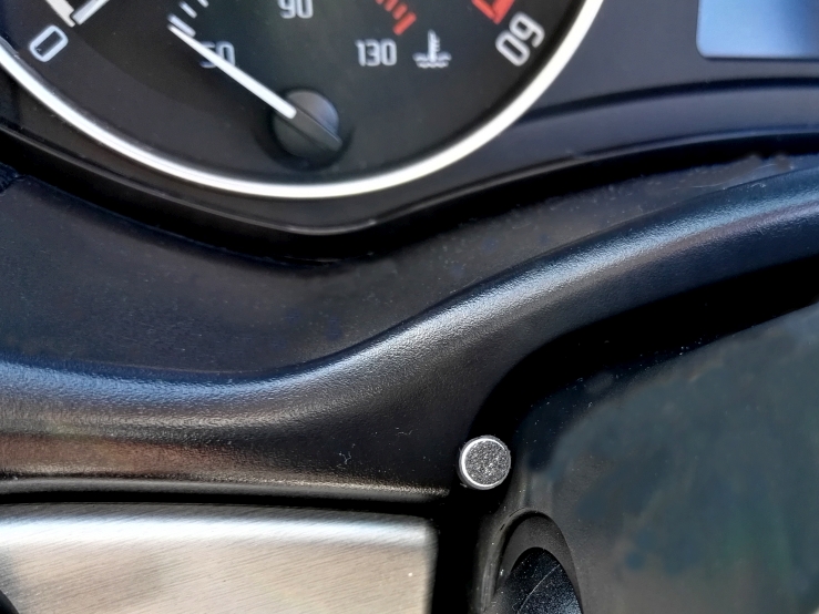

Cons: The external mic lead is too short to allow placement near the rear-view mirror or on the driver’s A pillar. (I ended up placing it under the instrument cluster, see photo). External mic is non-standard fitting, i.e. not a 3.5mm jack so is not easy to substitute.

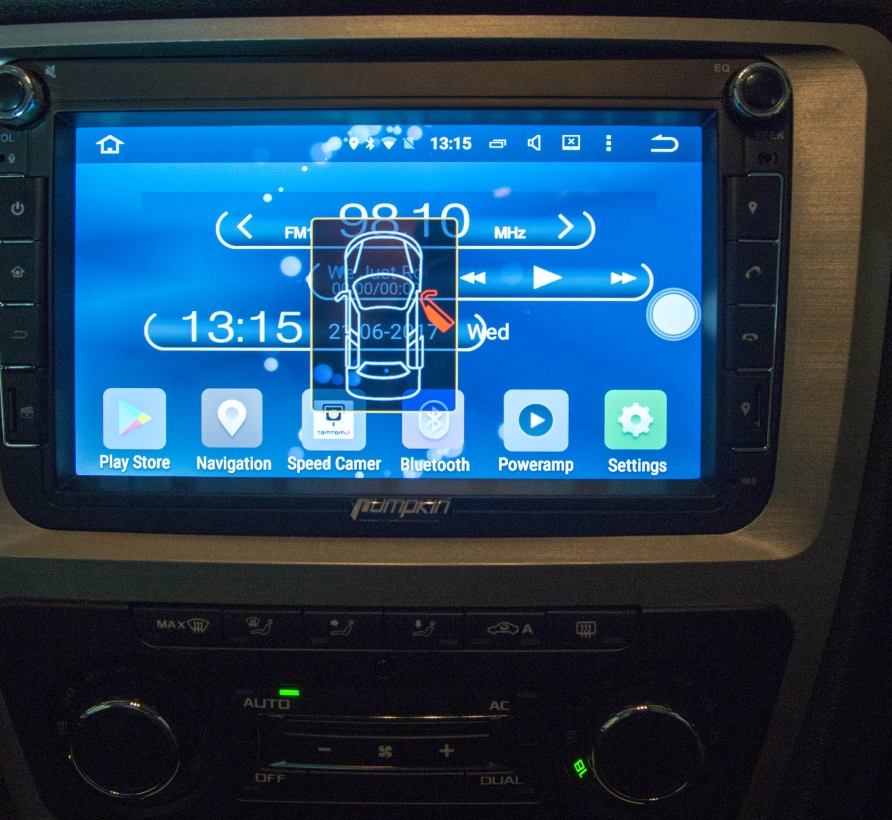

Display, connectivity, setup

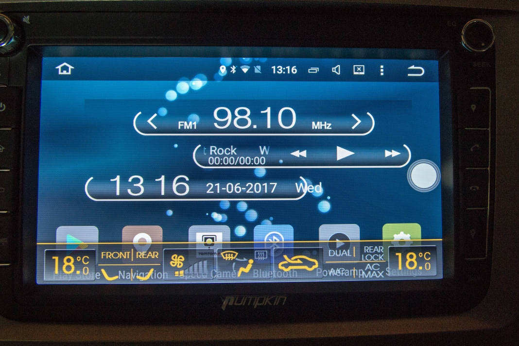

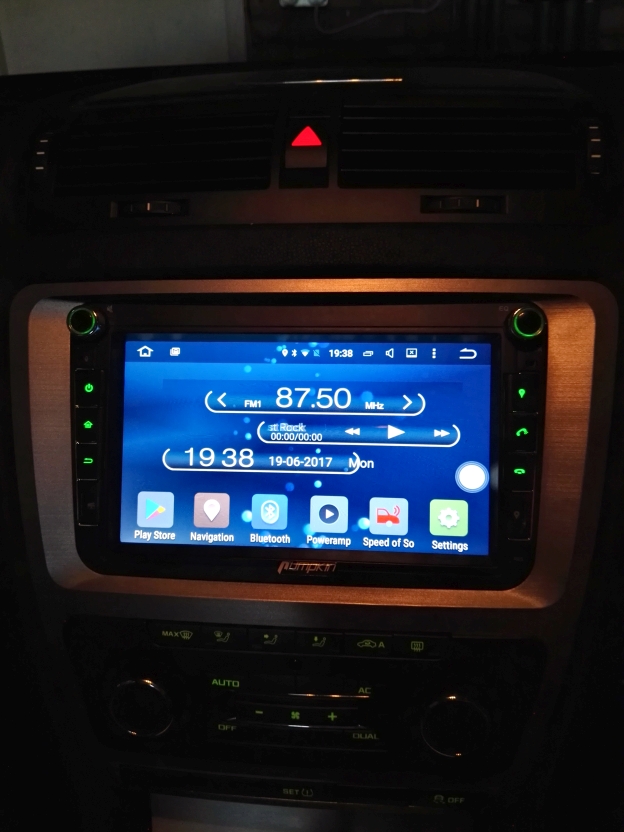

The display is perfect and has been bright enough in the recent sunny days. I haven’t been able to try at night yet. It’s extremely responsive and a great improvement over the old Bolero.
Connecting to my home Wi-Fi from outside the house and to my mobile (Huawei P8) was as simple as anything you are likely to see; if you are used to Android there will be no issues with this or the Bluetooth setup. Hotspot setup was also straight-forward but allowing Wi-Fi hotspot internet access seems to work better than Bluetooth, especially when using the “OK Google” function (see phone calls section).
Icons can be moved around but to get them to the adjacent screen means moving the icon as far to the edge of the screen as possible – it took me a while to realise this, it’s not as easy as on my smartphone.
The widgets for radio, music and clock/date on the home screen cannot be moved or changed which is a shame (although quite common with similar units as I understand it).
There are the usual array of Android settings and under “GPS” you can allocate your favourite map app to the map button on the unit itself. Factory setup contains further options including useful max volumes settings (although working out which setting relates to which app is trial and error); the access code is “3368”.

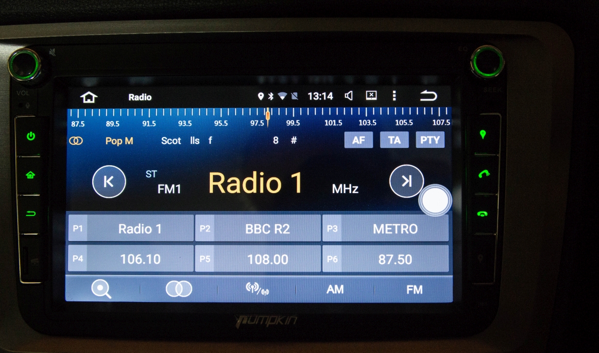

Music, radio and video

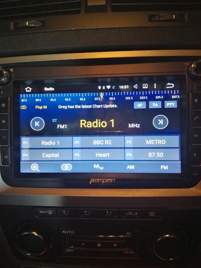

Very good audio but it’s not for the audiophiles out there, however it doesn’t cost £1000 and has more functions.  I can now use my favourite music app, Poweramp, which makes changing playlists and albums a joy compared to the sloooooow and clunky system used by the Bolero. I’ve only tried video from YouTube but it looked fine.

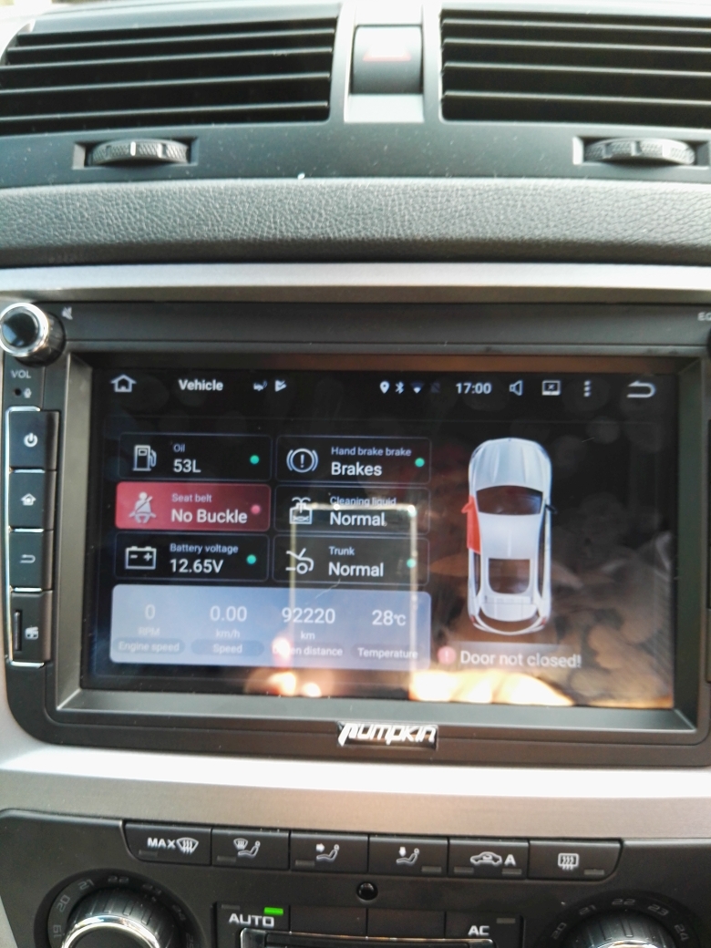

The radio is odd though. Radio stations are lost if you go into factory setup to make changes to such things as the CANBUS setting for the correct “door open” or to change maximum volumes for example. Autopumkin confirmed to me that it is a software problem that they hope to rectify. In addition, the TA function isn’t like anything I’ve had before. Normally you can listen to Radio 1 for example, set TA and local traffic will interrupt the Radio 1 broadcast. On the Pumpkin, you have to select TA and it will only select local stations carrying the TA broadcast (so no Radio 1 etc). Maybe I’m doing it wrong but it’s not very intuitive. This part is a work-in-progress for me.

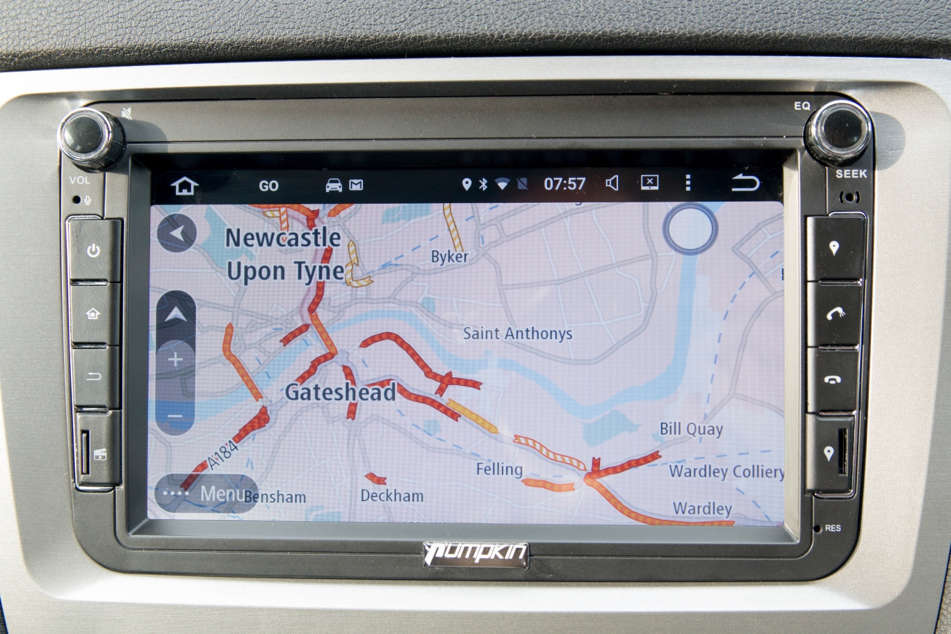

Pick your app and it will likely work. Google maps is great for voice search but I prefer the paid-for TomTom Go because I’m used to it.

The TA system is about the worst feature as when you select this function the radio cycles the local stations picking up traffic announcements as they are transmitted. In other words, you can listen to local stations with TA but not the likes of Radio 1 or 2 with local TA interrupting as is normal on car head units. Odd but not a deal breaker.
