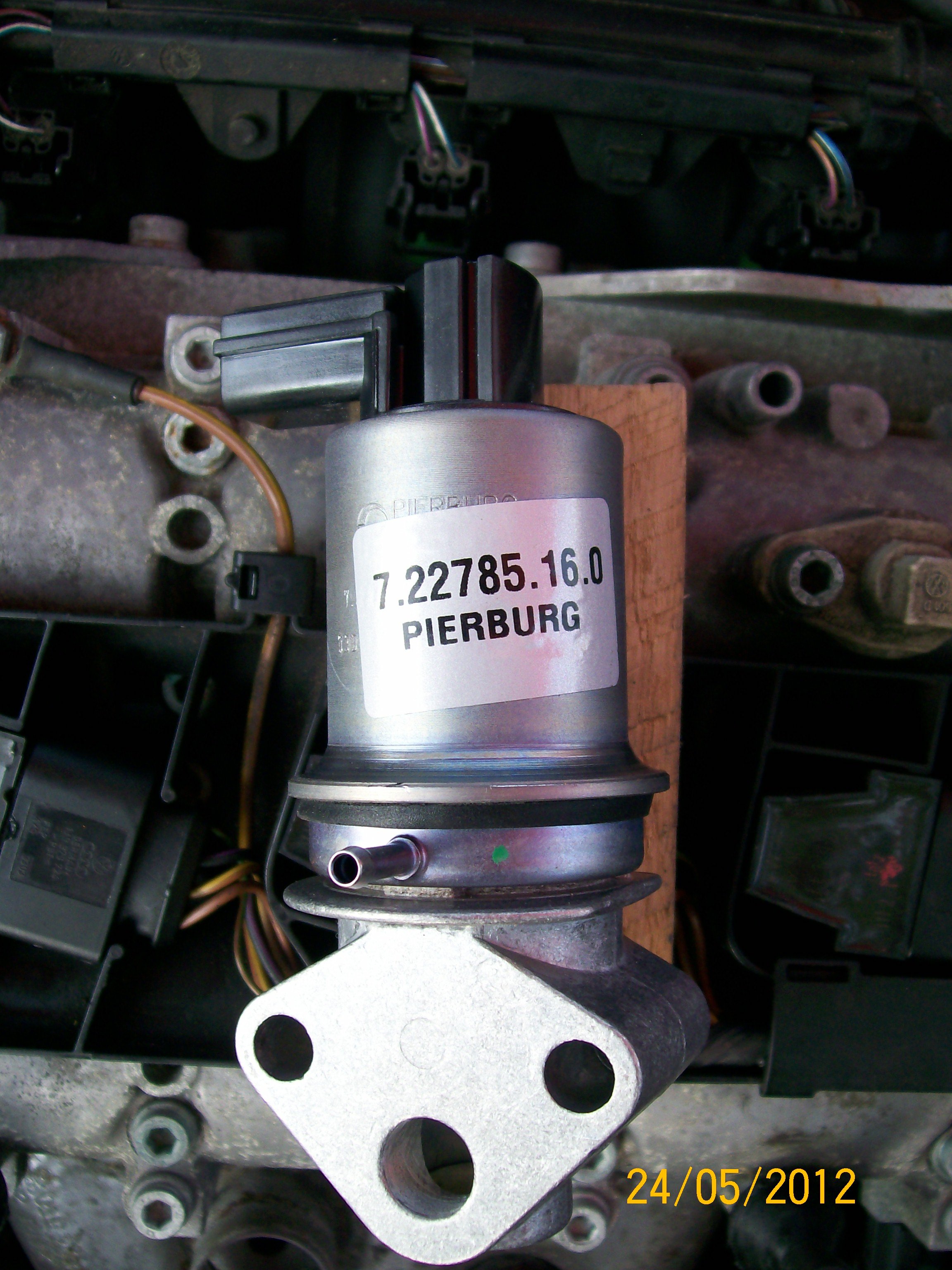

Try giving the EGR valve a tap. If it is stuck fully open it would make starting difficult.  A physical hit with something on the outside of the valve body may dislodge it and let it close again.
You know where the EGR valve is, right?
Just noticed that this isn't a new thread, and that the original post is about a completely different engine. What year is the car you're talking about Cris?

OK, so your EGR valve looks like this, and lives at the front of the engine next to the exhaust manifold:
