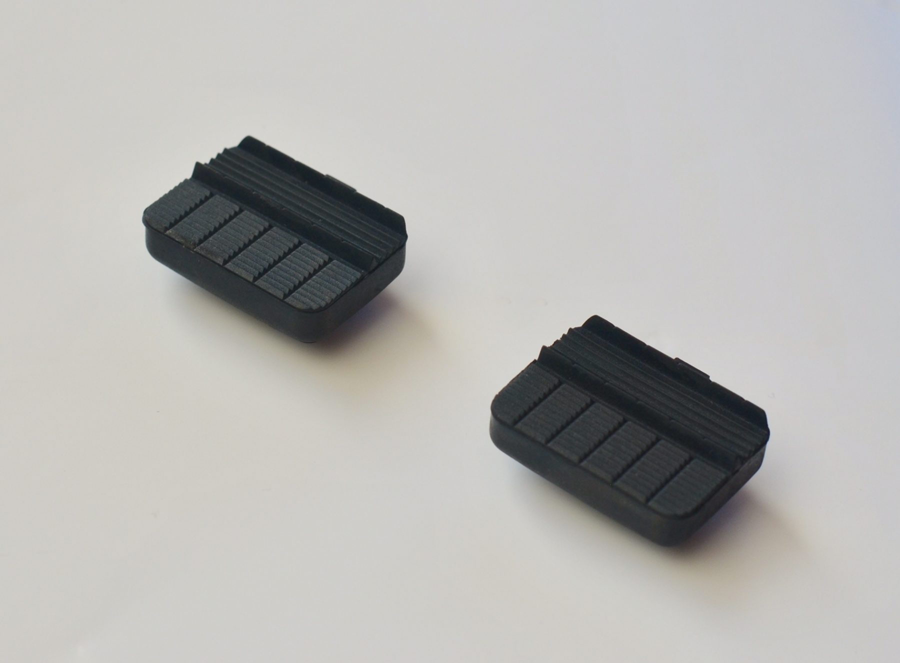

From The Caravan Shop here https://www.thecaravanshop.co.uk/milenco-mgi-spares/spare-aero-pads/aero-f-pads/prod_1323.html
I've checked the product number against Milenco's own website and they are the correct ones. They came as pack of 4. The picture below shows the ridge that goes into the gap on the door mirror surround.
