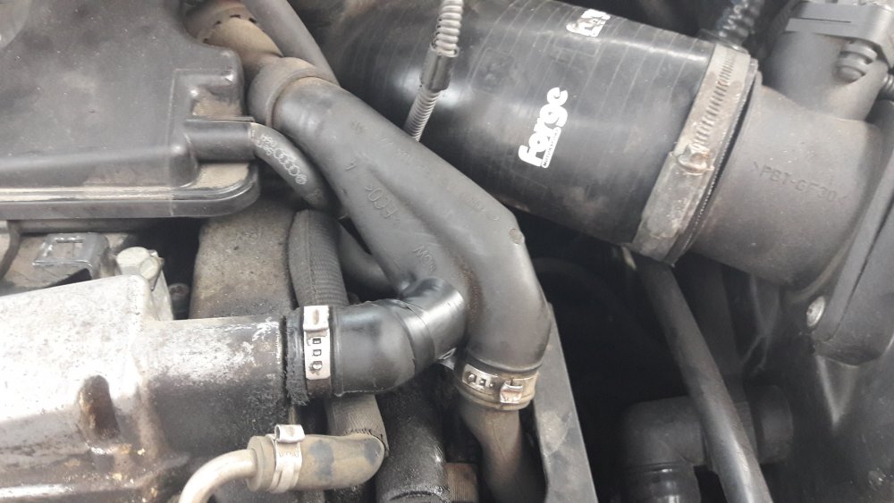

Hi guys having a couple of problems with the car cutting out and found this split in this hose. I'm not sure what it's for really so thought I I would put it too the members. Also ran a diagnostics check and these 2 codes came up. 17554 and 17608
Thanks in advance
It's part of the engine breather system and it's a very common failure point. Search this site for Y-piece hose.
Easy to replace and can lead to poor running if it is split.

Much thanks for the reply mate. Wasn't too sure as have quite a bad boost leak. Originally thought it was a boost hose but stumbled across this tonight. Also coil number 1 and 2 was popped up a bit. Pushed back in and that caught my eye.
