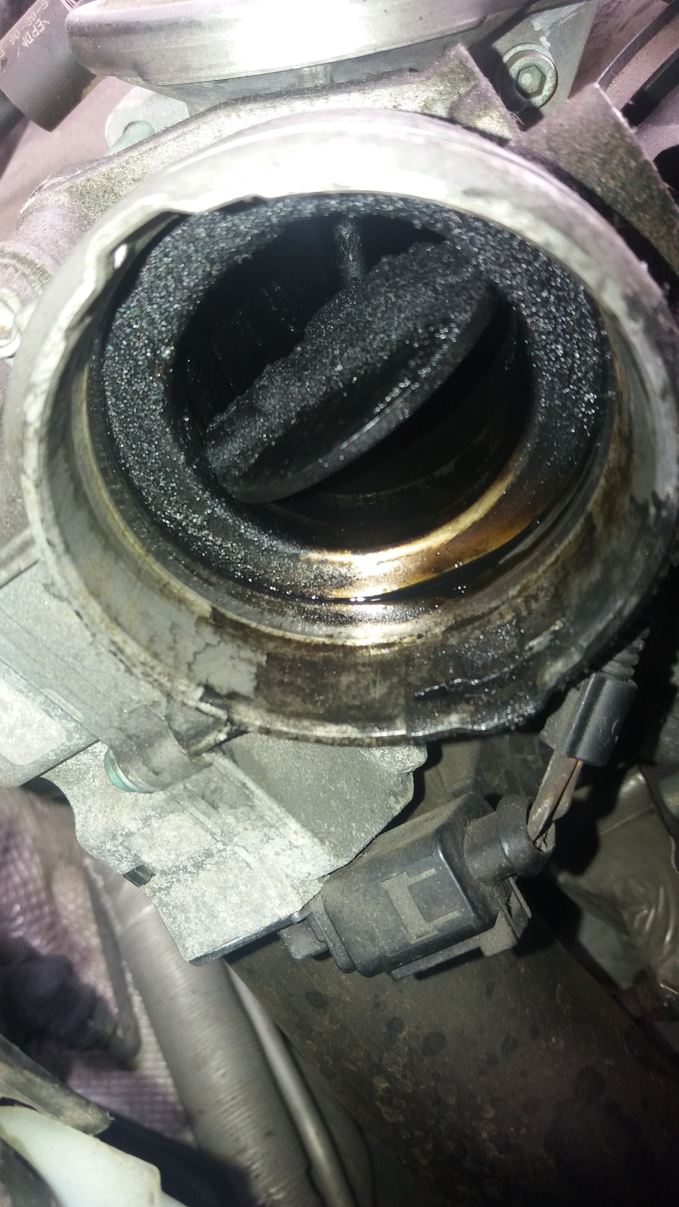

I've seen the best way to clean EGR is to take the full manifold off with the EGR and do the lot. Though I'm not that confident and have bought a spray cleaner. I have a video where the guy removes the rubber hose and sprays the cleaner straight into the EGR.
Compared with photo's of other's I've seen mine doesn't look bad, though welcome any advice I can again get from the forum.

Id be wary about the muck getting pushed further in rather than getting it out if you leave it in place.  On my 54 plate 1.9 PD I just took it off.  A ball ended allen key helps no end to get the bottom bolt out.  New gasket and large o-ring are relatively cheap from the dealer.

I can't comment on removing the whole manifold, I just removed the EGR as that's what I thought the problem was.  Its a 5mm ball ended allen key for the 3 EGR bolts (a normal one will do it but the bottom one is a pain) If you don't have a ball ended one then once you remove the exhaust feed to the EGR (I cant remember now but its about 6mm allen key for those two) you should be able to get the bottom EGR bolt out as you can move the pipe slightly out of the way.  It also helps to remove a couple of the mounting bolts for the black air pipe that runs across the back of the engine and down the left side (one located at the top and a second below the EGR valve). Once the EGR was off the car I used an old screwdriver to gently scrape the sticky gunk off before using carb cleaner and a toothbrush for the remaining carbon deposits.  Wear old clothes or coveralls as the sticky black stuff seems to get everywhere and doesn't come off you clothes.  I used an old plastic bowl to clean the valve in to prevent staining of my path.  It's a very messy job but mine looked almost like new by the time I'd finished.  I replaced the bits in good old Haynes fashion with a new gasket for the exhaust feed pipe (about £3 from the dealer) and a new rubber O-ring type thing for the EGR to manifold joint which I can't remember the price of.

If there are no issues with the car that can be directly attributed to the EGR I'd leave well alone.
The best methods to keep the EGR clean:
  • Regular oil changes using the correct grade of oil.
  • Use of good quality fuel.
  • Regular exercise through the rev range and gears (i.e. occasional spirited driving).
If the above is done the EGR will look after itself.
Sometimes sprays and other snake oils dislodge some of the crud / carbon which then results in adverse affects that wouldn't ordinarily have appeared.
