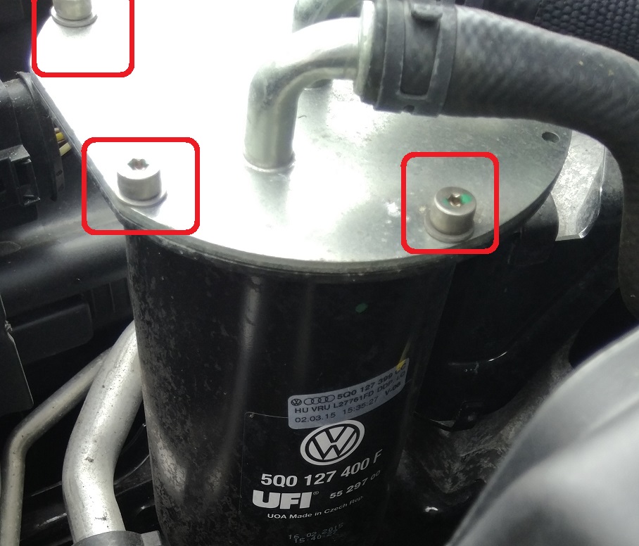

I`m looking to change fuel filter on my car. I came across this statement:
"Changing the filter on a fuel-injected vehicle can be tricky. On fuel-injected vehicles, you need to disable the fuel pump to relieve the pressure on the fuel lines."
Does this apply to my car or its only for petrol cars?
Also, when changing fuel filter, do I need to pour diesel into fuel filter housing before closing cap? I`m thinking about too much air in fuel system if I don`t.
Thank you for any help.
I spoke to Michael from Listers Skoda who told me there is no pressure in fuel filter. Took me 10 min to replace. Undo torx screws, replace filter element, put screws back. Took some 5 seconds to get it started, then another 15 seconds uneven running and then it ran like normal. Just be careful/slow when lifting a lid, fuel will be dripping from it, about handful. Put lot of paper towels around filter. There is no need to pour fuel in filter before putting lid back.
Don`t be afraid to do small stuff like this yourself!
Edited by Robertino
