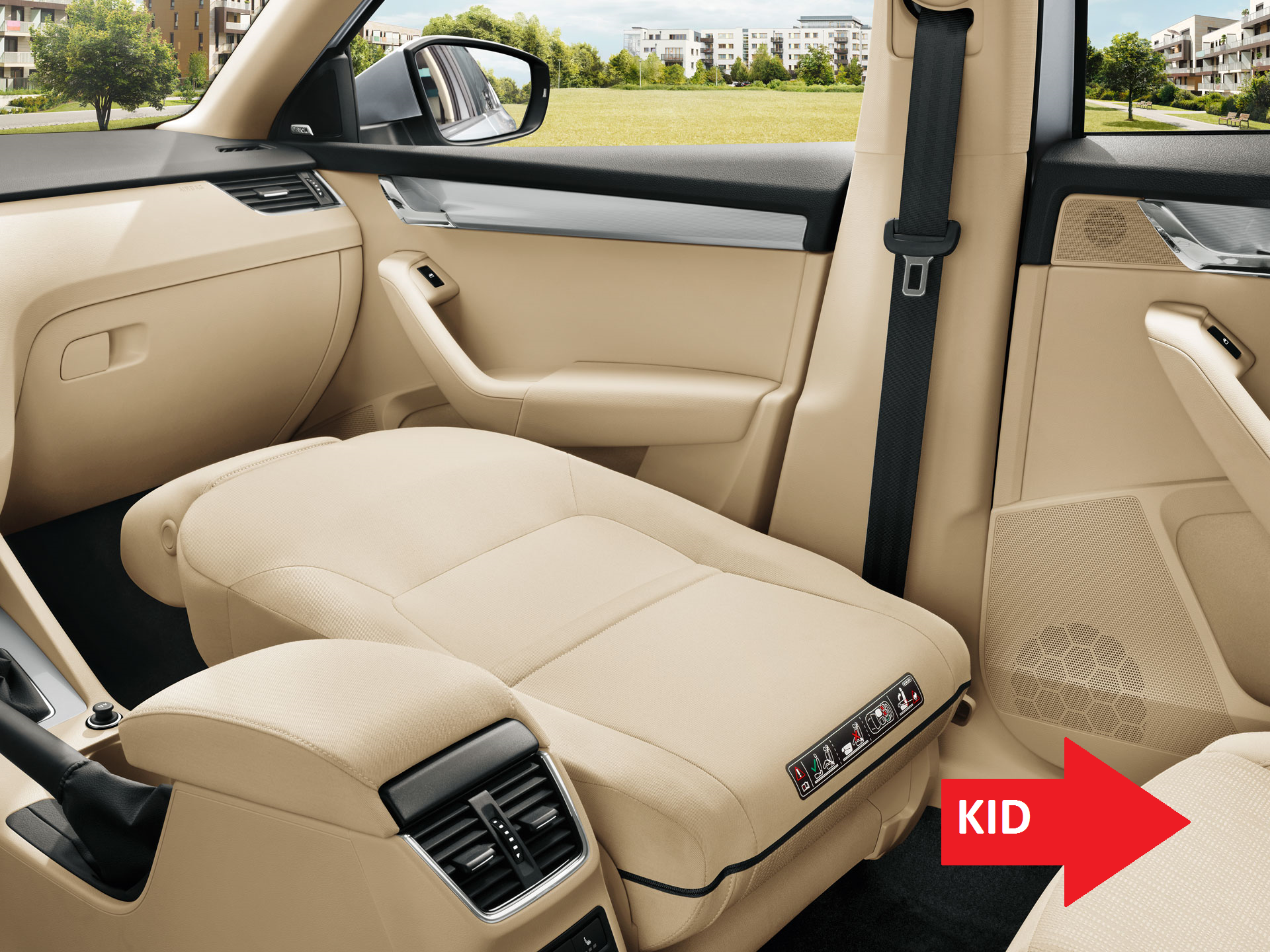

Child seat behind foldable passenger seat?
What's the reason for the signs on the seat? What are the risks of folding the seat while having a 3y kid in the back?
The thing is that folding the seat offers the kid a great view - makes it much more interesting.

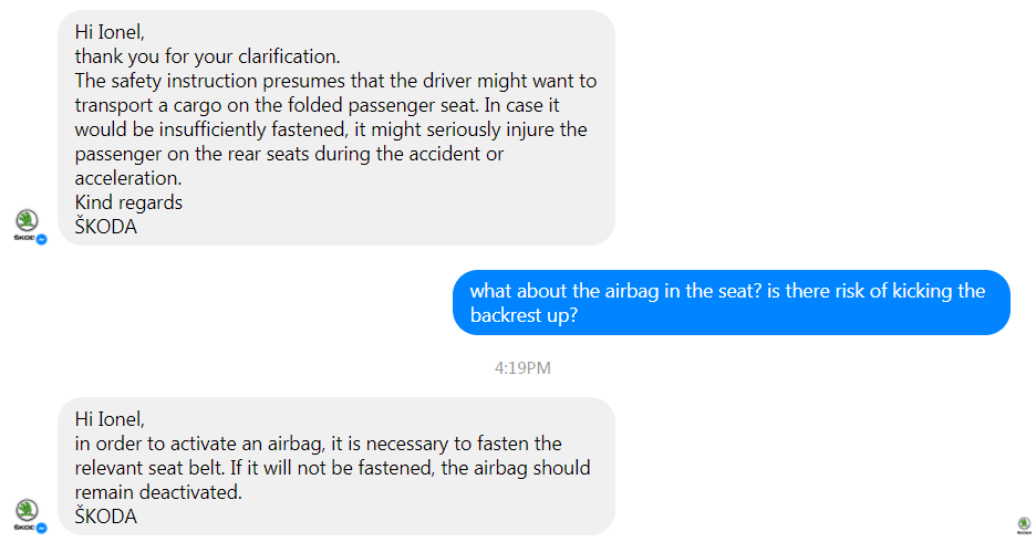

Finally, an answer from Skoda:
