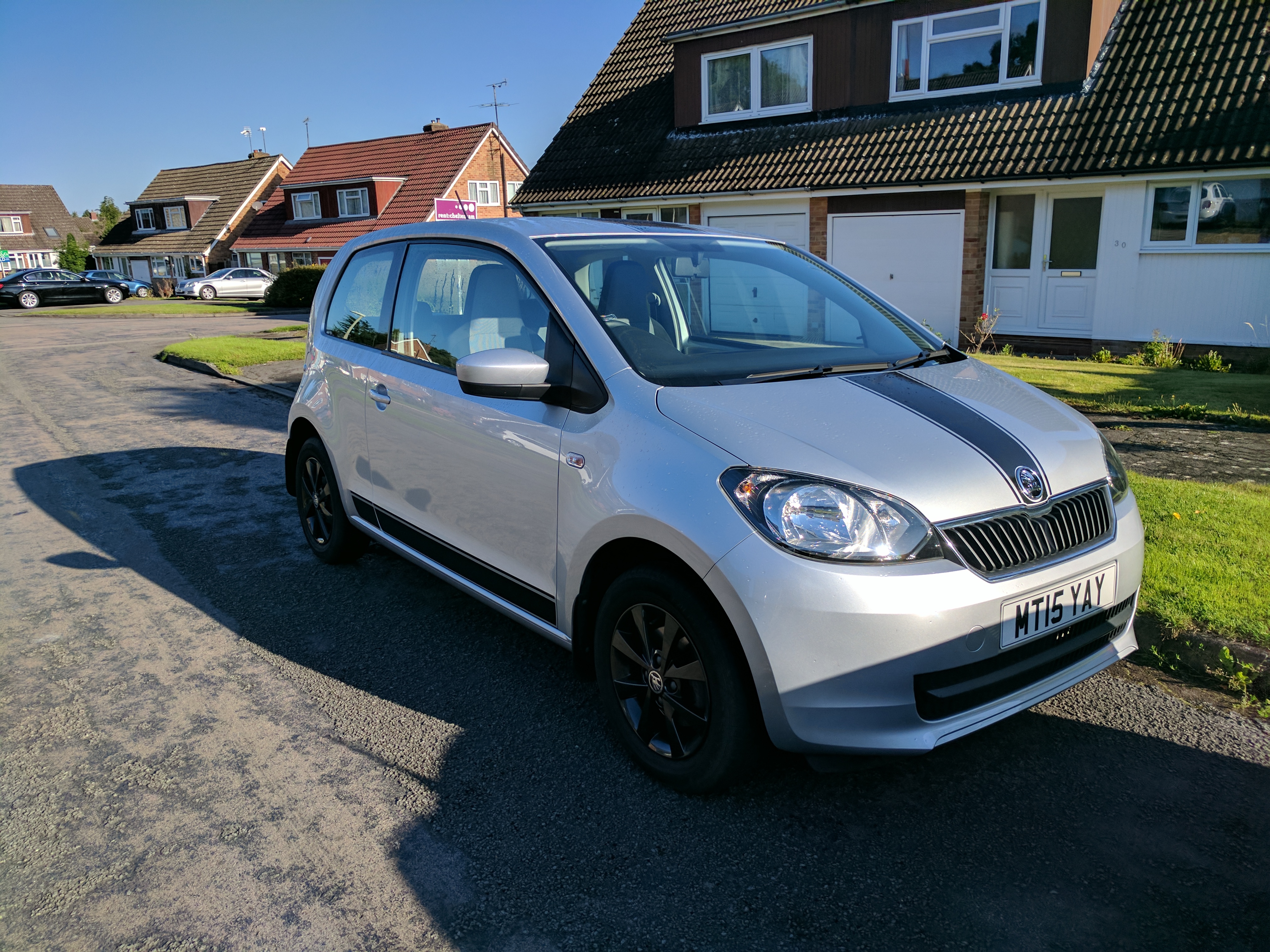

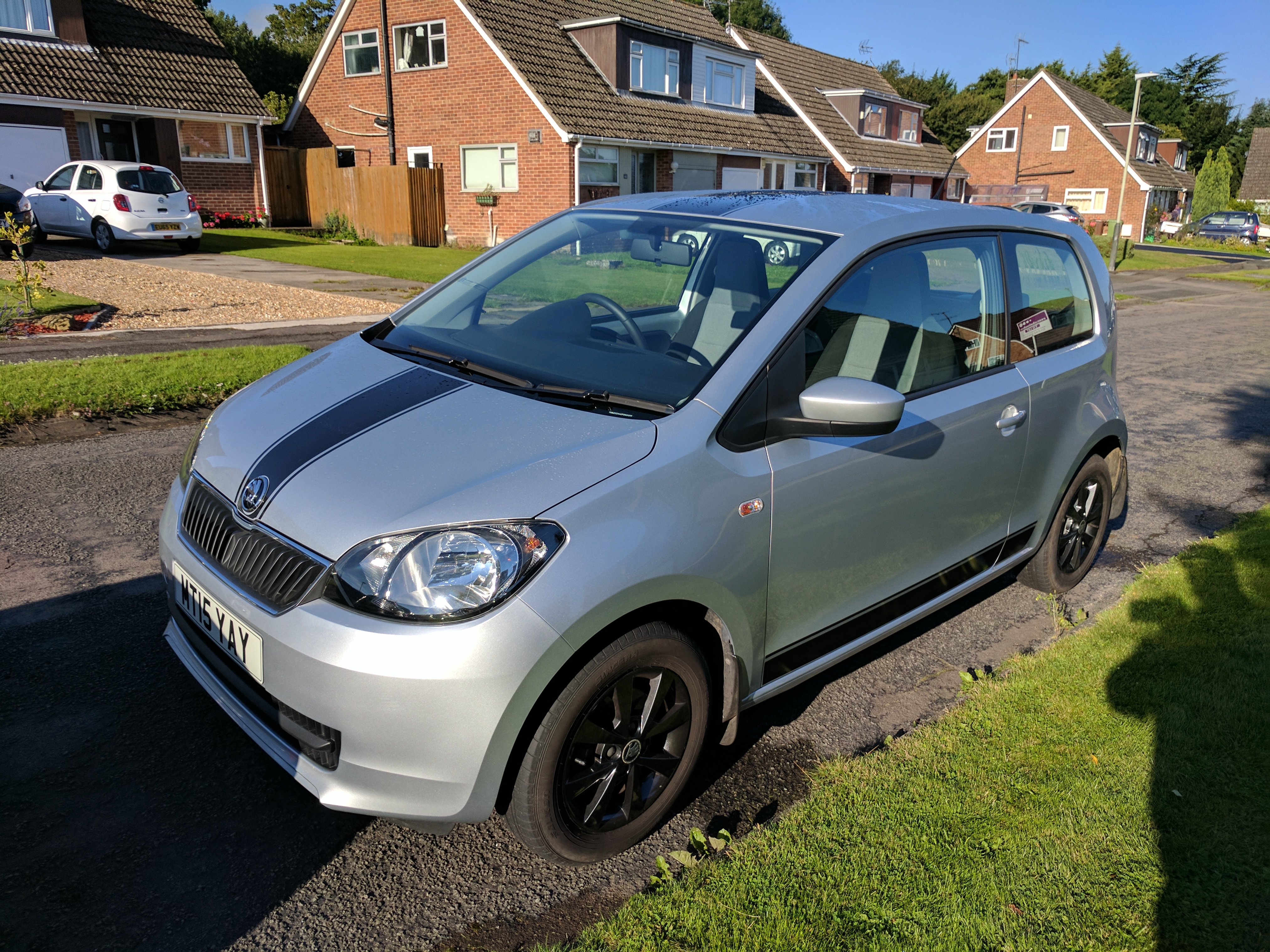

In the end I took the part-complete kit to the local vehicle graphics people and they made up the ones to replace the missing ones and fitted them all.
Worth noting that the current Skoda price for the kit is now £120 inc Vat, but the fully fitted price is £180 inc Vat which isn't too bad.
