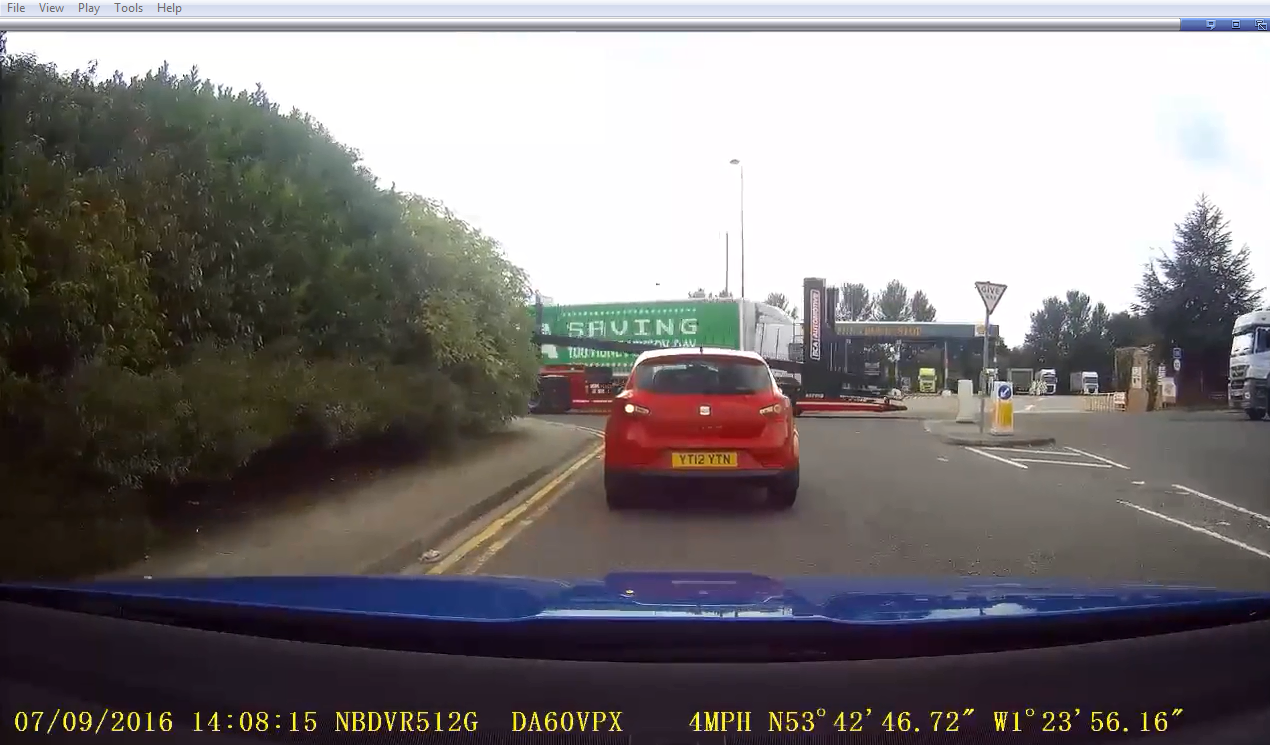

I also have a 512g dash cam. Video quality is crystal clear.
