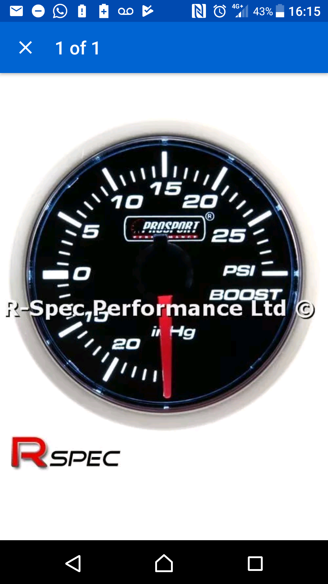

Where did you get this gauge from?
6 minutes ago, KenONeill said:
@Saints92 - To start with, engine off I'd expect a reading of 0PSI (relative pressure) or 15 (absolute pressure). A reading of -20 is impossible because that means that the transducer is being pulled on rather than pressed on!
That's the gauge. Saying -20 is wrong, but it's the 20 below zero at idle. I think it sits fractionally zero when the cars off.
@Saints92 Ah, any numbers aside from the -20 had been PSI.
So what I now know is that that's a relative pressure gauge, calibrated in inches of mercury. In that case, having an induction pressure below 0 at idle revs is entirely normal. With how close you can read the gauge, treat 2" gauge pressure as equivalent to 1PSI.

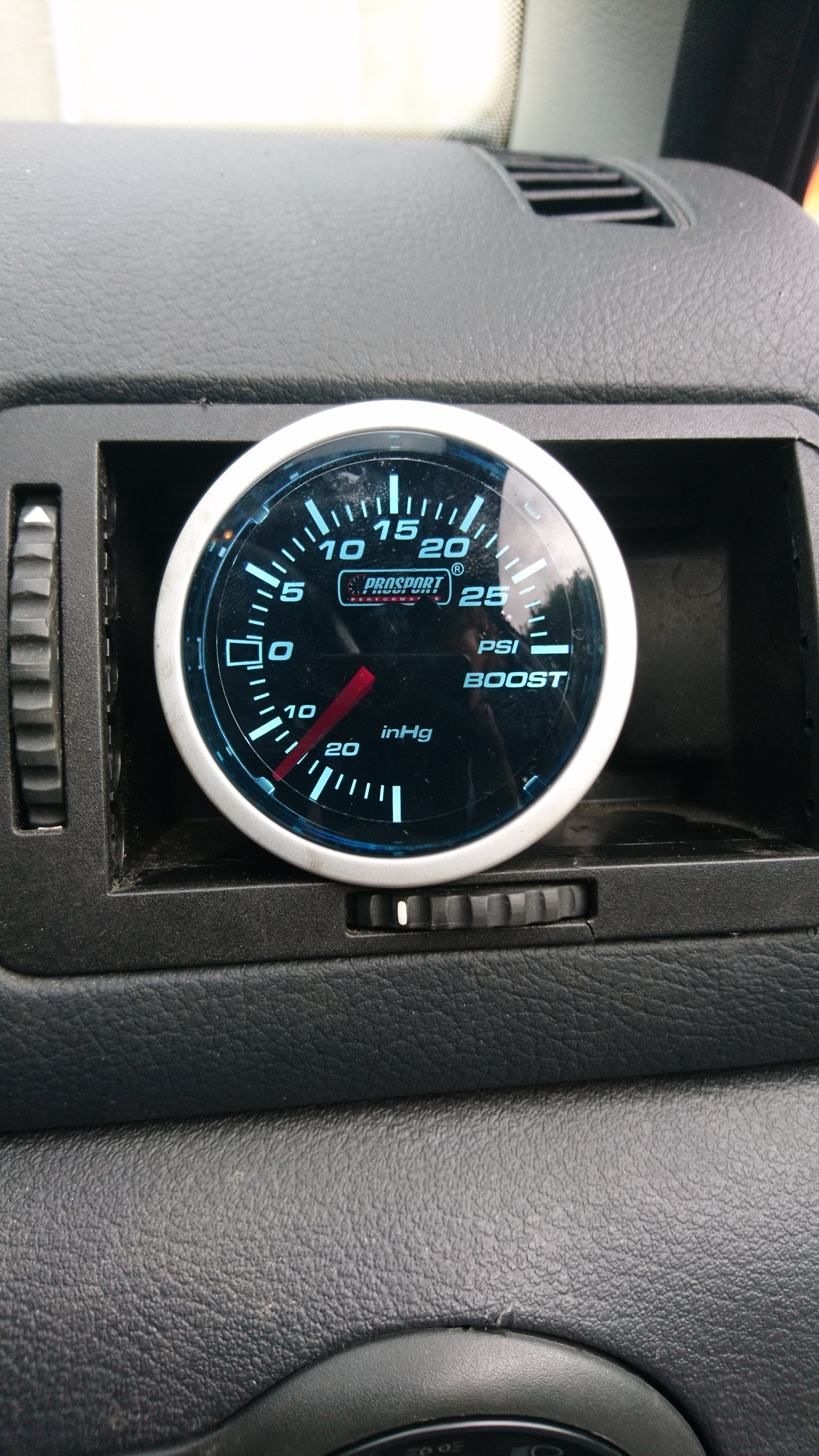

This is where It sits when you start it cold and let it idle, slowly drops down to the 20
@Saints92 - That's not unreasonable for an idling reading: In fact, if it was a non-turbo car the vacuum reading would stay in that sector all the time.
