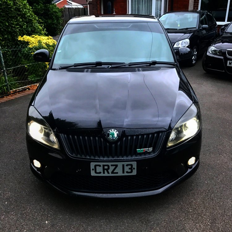

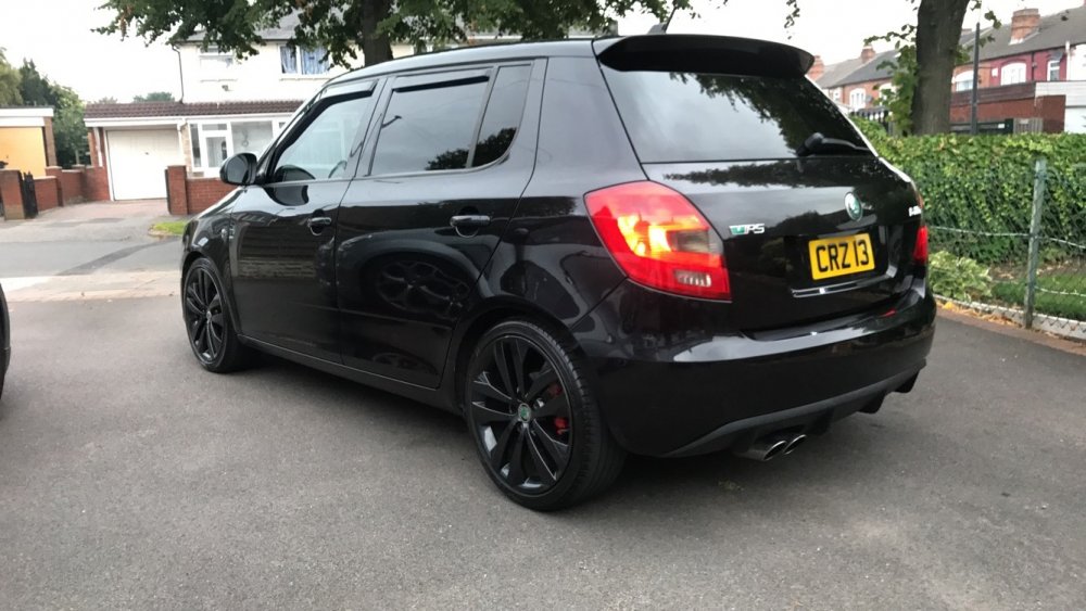

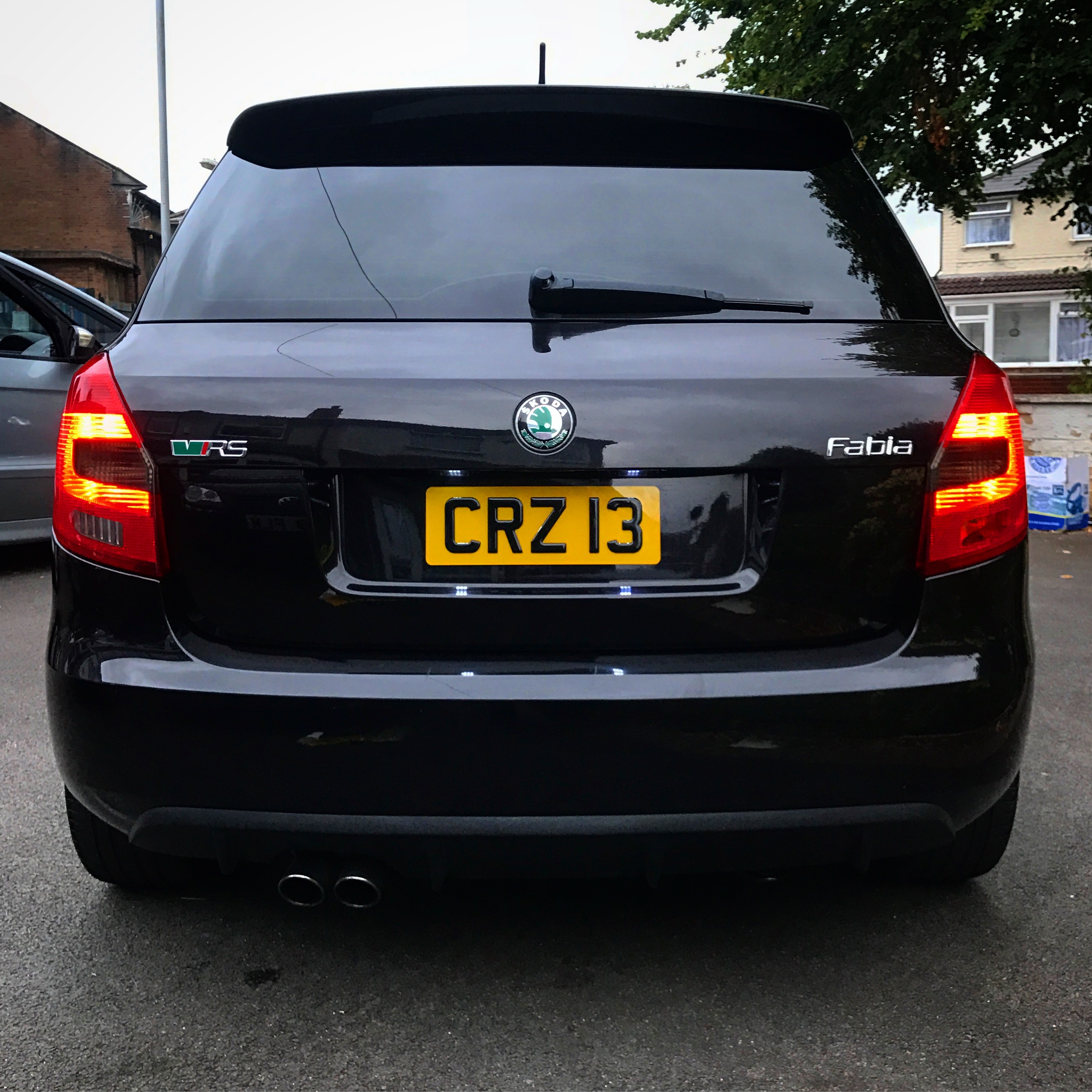

Have attached a couple of pics, in the side view the rear looks slightly raised but when looking at it side on it is actually sitting lower, will post more pics once they are adjusted again (hopefully by the weekend)
