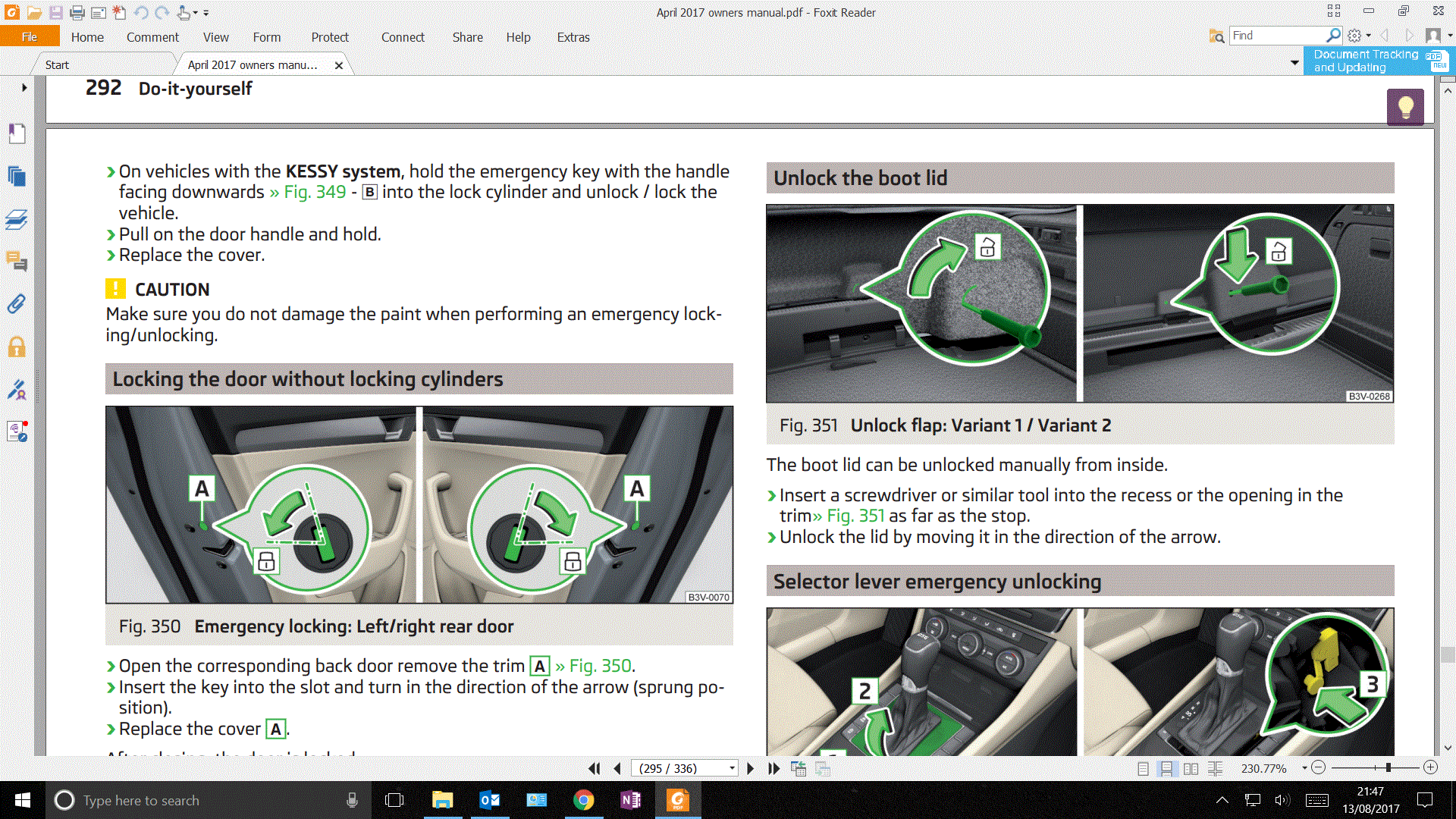

look in the manual to see if there is a manual release (I'm pretty sure there is but not sure where it is on your car.)

page 300 of the manual, shows how to unlock the boot manually.  if you don't have a manual to hand, you can download it from the Skoda website.  hope you get things sorted out.
This is the page from my manual from April 2017
