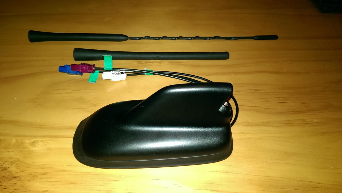

Where did you get hold of this aerial from? I am looking for a sharfin with FM, DAB and GPS?
Fleabay, the part number you need is 1K0035501F which has the 3 connections - I don't know if the phone connector can be used for DAB though.
