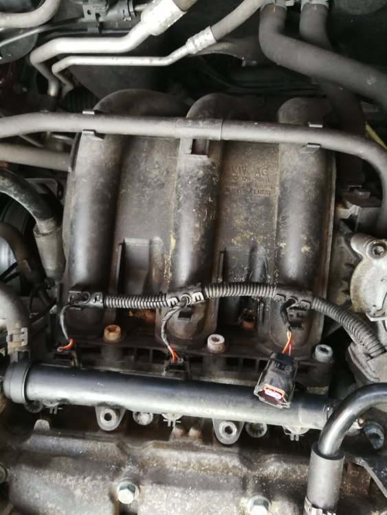

I have news Guys a friend of mine just spotted this.. He said this could be The  problem (let me know if you see pic i attached below)
So i dont know about cars a lot and for that reason i dont know what that plug or cable  or whatever its called is
But as you could see in The pic that i pulled out that wire.. Its no working basicly i pulled The other two ( 1 at a Time) and The car dies when i pull it out but when i pull The Last one that în same side of The third cylinder. It does nothing so could that be The problem? Please Guys tell me whats it called and how much would it cost
Those are the connectors to the fuel injectors, needless to say they need to be plugged in....

I see. Well i pulled it out to show you Guys. It seems to not work do you think if replace it. It Will fix The problem?
It doesn't "work" because the cylinder is not firing. Yeah it could be the injector, but also could be the plug, the coil, or wiring to the coil or injector.
You could swap the injectors round and check if fault moves.
